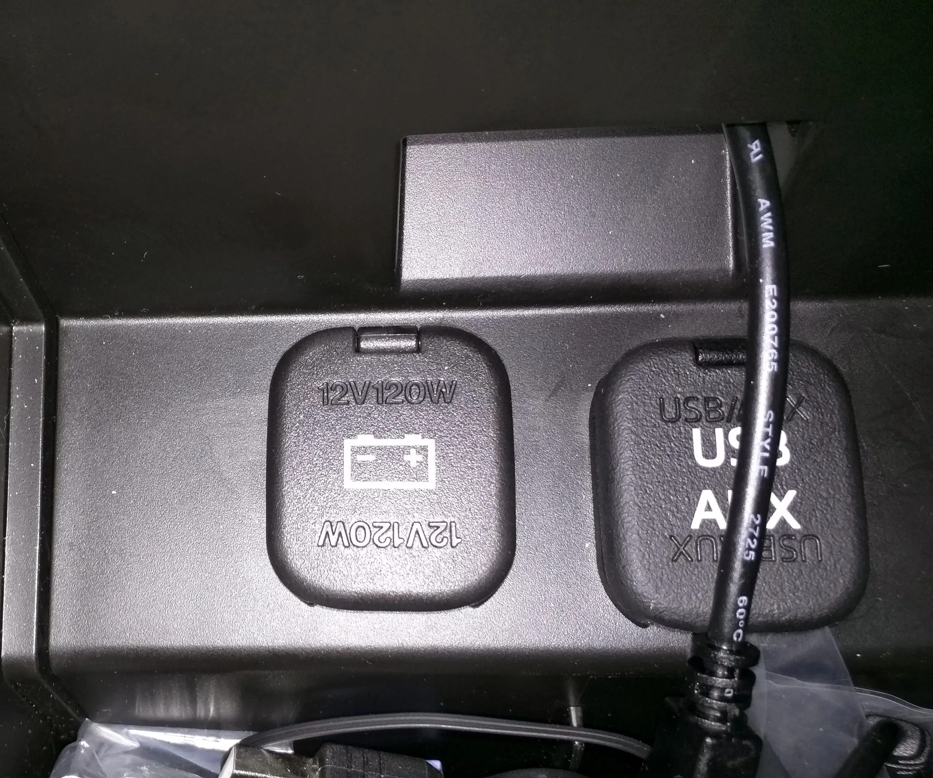

jlcpremier (and others) - In the first post, it's described to push out the existing USB connecter from the center box, and use that hole to run USB from the new head unit...
Instead of doing that, why not just run the new HU's USB cable thru the little vent-like slot directly above the USB/power connections (inside the center box), and leave the factory USB connection alone? (see attachment)
(An added benefit of this is that the factory USB connector can still be used as a (slow) USB charger.)

The factory USB connection keeps unusable once hu is removed
I'm seeing something different... The factory USB is still powered. Even if it's not usable for playing music, it's still usable as a (slow) charger. When you have a wife and two kids in the car for a road trip, all with tablets or phones, having another charging port (even if it's slow) is priceless.
