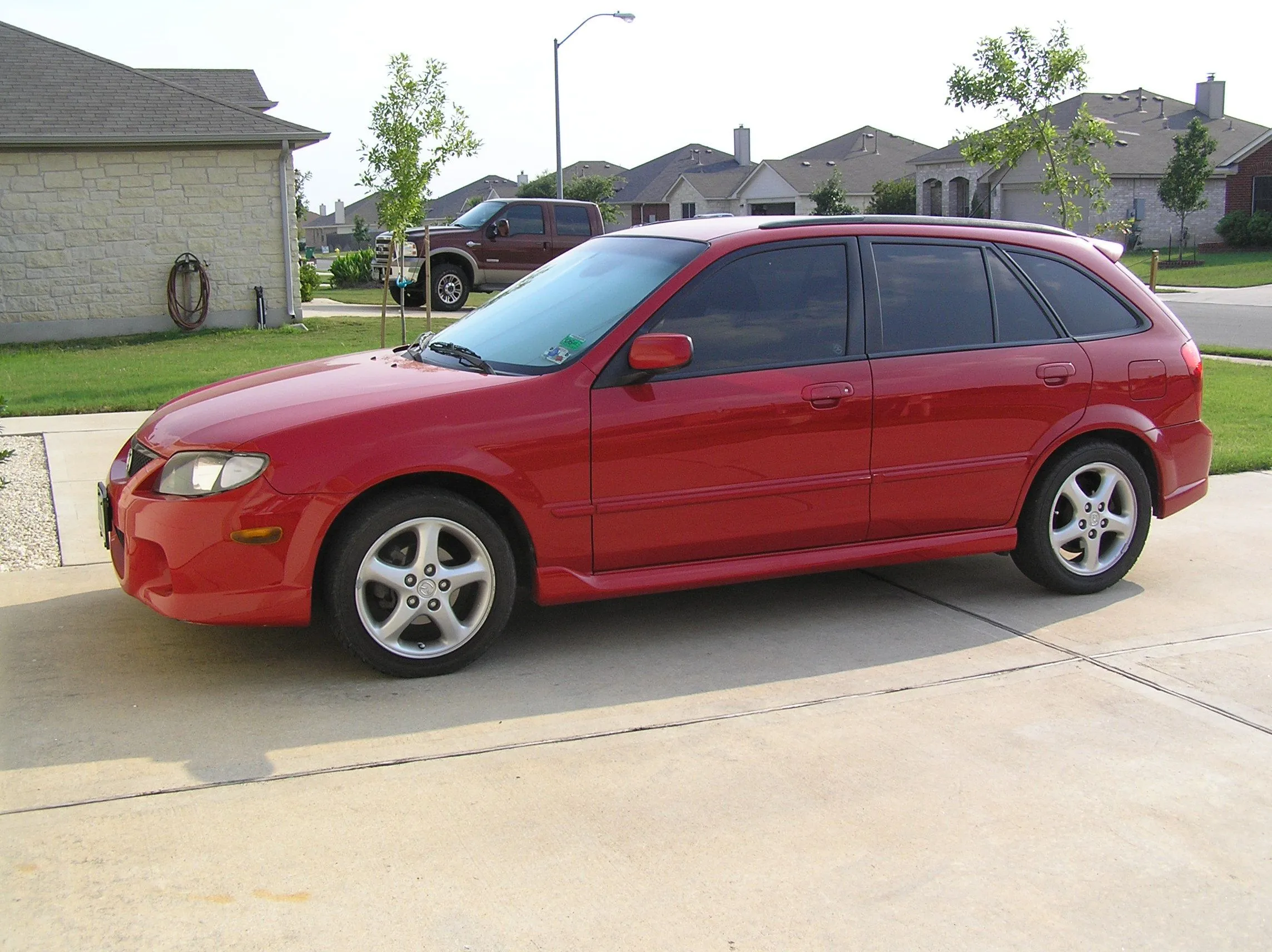

pics with 205/50/16

LEXUSLEO said:
If you decide to get the OEM size, I would recommend the Michelin Pilot A/S from Tire Rack. They are $150/pc., but they have a 60k treadlife and ride really quiet. I too was going to get 205/50/r16, but was told this would cause premature wear and trear on the suspension and steering, and also if you look at the tires from the side, they seem to buble out a bit. Your choice.
I dunno about that. Sounds kinda sketch since they are an UHP a/s tire.
I have the stock spec asx's and love them. One word of caution however. ALIGNMENT (sp?) They have a soft tread compoud after the initial layer, any odd wearing characteristics will be greatly exagerated after the 1st layer is worn thu. Make sure your vehicle is aligned and rotate every 3k.
Falken Azenis ST115 for the win!

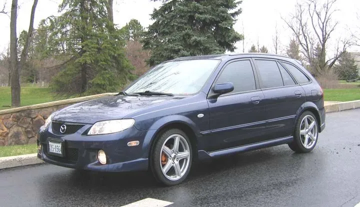

Josh_160 said:
lovin blackp5's rims i also have a black p5 and looking for dark rims hook me up
I was just about to say that. I've never seen such glossy black P5 rims. The car looks perfect the way he has it right now. I kinda wish I got black. A pain to keep clean, shows scratches and swirls a lot, but when it is clean and polished/waxed it is sex!

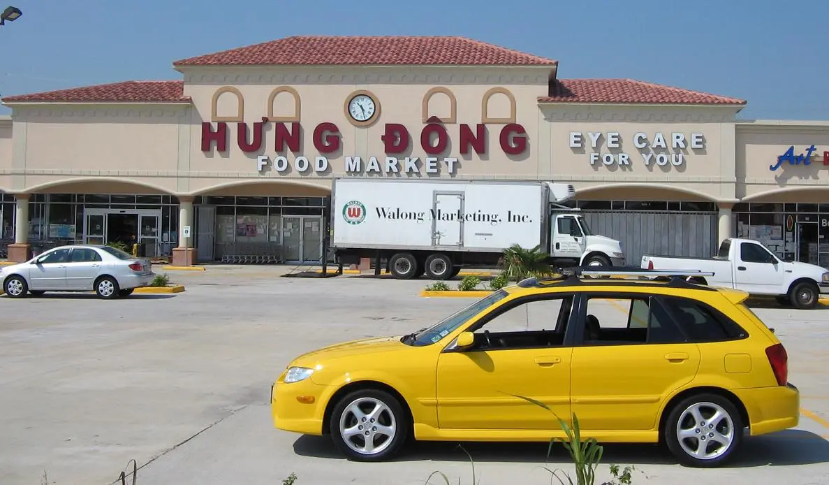

205's on rear
Here are 205/50/16 on the rear. Still have stock ones on front.
