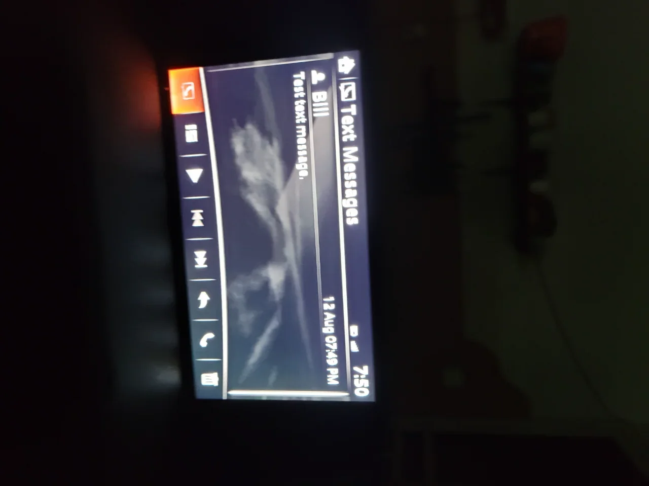

Your text messages are displayed on your Mazda's infotainment screen? Can you provide a photo, I'd like to see what that looks like.
Sorry about the angle, I usually access this forum on my laptop but to send the pic I did it from my phone.
