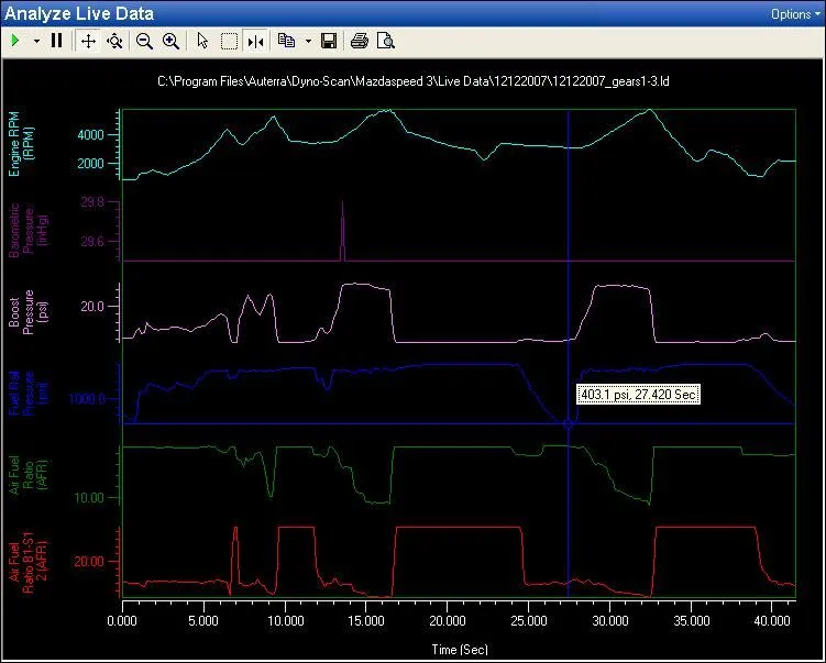

ahhh... OK then sorry. on the first graph there whats the pink line and whats the blue line?
one is the stock pump pressure/throttle the other is the upgraded pump. The higher of both lines is the aftermarket pg pump. ignore the colors. Just look at the stuff for a lil bit, it will be obvious what your looking at.
Apparently you just cant get this through peoples heads. Do you think we are talking out of our ass? Laloosh has datalogged this happening. he is the only one with proof that this is the case. he replaced the pump and gone. Simple as that. When i had the pump in my car the problem was gone. I wish it was still in there. DAMN IT!!
Are you talking about the graph from the standback that shows the stock fuel pump with <800 PSI of pressure and the new pump with fuel pressure that is all over the place?

You would also think that someone would have datalogged the fuel pressure from the OBD2 port by now.
I did.
