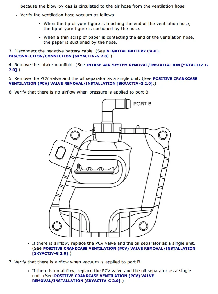

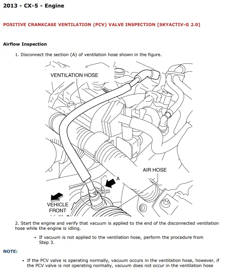

Does anyone know where the PCV valve is in the car or its not there at all ? I usually check the valve every 20k to 30k miles and as they aren't costly many times replace them as DIY. Any diagrams will help.

You really should track down a copy of the service manual if you plan on DYI maintenance.
