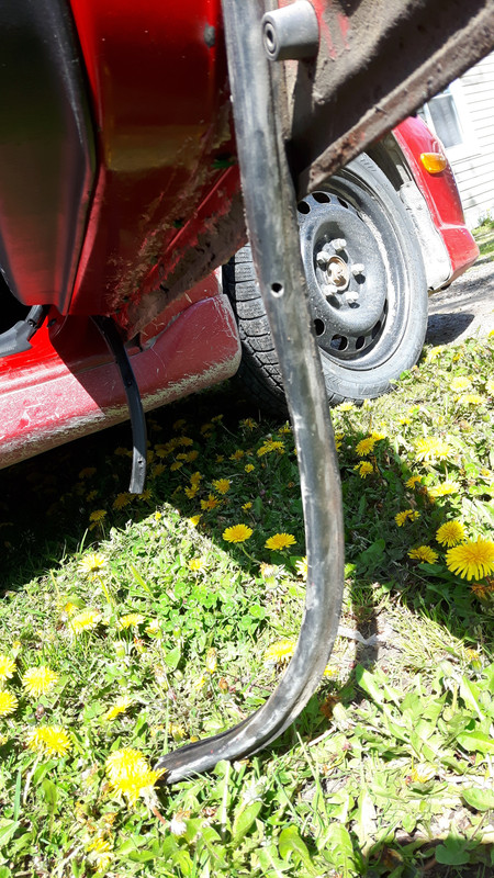

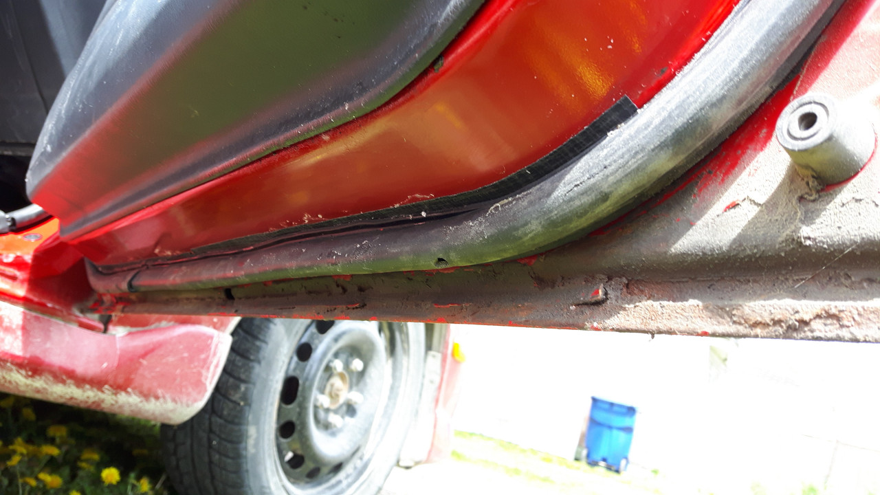

It was a nice day so I decided to reglue my door seal.
It was barely hanging on but at least it held till the weather warmed up.
I sanded and cleaned the rubber with brake cleaner and alcohol then applied rubber glue to the seal and silicone on the door.
I thought the glue would stick to the silicone (it is rubber) but it didn't. So I scraped off the silicone (which was stuck on there pretty good) and put two face tape on the door.
I put more rubber glue on the seal, waited for it to dry and stuck it on.
That worked really good.
I bought the expensive two face tape for carpets. It's really sticky stuff.
