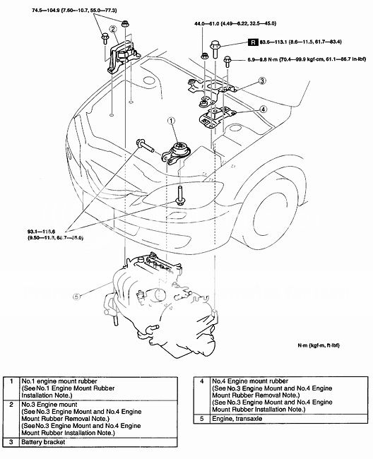

They are fairly easy to replace. The engine does have to be supported from underneath for the no. 3 and no. 4 (pmm and dmm) mounts. Do one at a time so the engine/trans always has at least 2 mounting points left. The battery tray has to be removed for the no.4 mount but it's easy. I recommend using a jack with a sizeable block of wood under the engine oil pan and across the bottom of the trans for support. I'll be replacing my no.1 mount with the Focus one sac02 made a post about a few months ago soon. I replaced the no.3 mount with the OE part around a year ago. I think I may have read somewhere where mazda updated the OE part because of the high rate of failure.

@secondtyme- they all look like support the motor and bolt out old one for new one. One challenge that may arise with the TMM is when the front is on jack stands and the TMM bolt is out (two others holding in place), the motor may shift a little making it tad hard to align the holes to bolt in the new unit. Have a spare scissor jack on hand to move things around. Or, leave the car on the ground and just slip a jack underneath to support the engine since the mount comes out from the top anyway.
I replaced my #3 passenger mount with https://www.amazon.com/dp/ (commissions earned) about 9 months ago (maybe?). May have failed already as I am getting odd vibrations lately. Probably go OEM next time. I also replaced my #4 trans mount with an OEM one (glad to see we finally got the torque settings for that big bolt. 61-83 ft. lbs.). It helped some, but didn't eliminate all the rattle. Haven't done the #1 rear mount

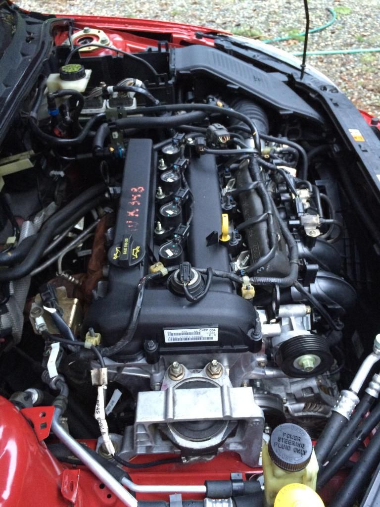

Since I don’t have any willing +12 owners who would post a pic of the stock PMM, I had to do some searching and assumptions. If a=b and b=c, then a=c, right! – LOL.
Mz3 (2.3) and Mz5 (2.3) PMM are interchangeable. It seems the Mz3 (2.3) can use the MS3 (2.3 T) PMM (totally different mount design) so I would conclude the Mz5 can also use the MS3 PMM. The MS3’s PMM “look” identical (minus an extra removable “balance weight”(?) and rubber duro quality notwithstanding) to the +’12Mz5 (and newer Mz3 with the 2.5). SO, can I deduce that the newer ’12 Mz5 (2.5) PMM would work on the <’10 car? What drove me to investigate this is the simple notion that these cars are all essentially the same. The MZR bottom end where the mounts are located are unlikely to have changed. Also, they all share the same chassis (a pic would be nice :/), so why not? The fact that PMM is redesigned is illrevalnt regarding fitment –unless there’s a clearance issue with other components due to repositioning of engine bay, which is not the case. Just for kicks, there are 3-4 revision of these PMMs with funky prices. I really don’t like the <’10 OEM PMM (look like toothpick to me) while the newer one looks much more robust. So, any comments before I dive into this?
OR if someone else is interested, you can go to your local Mazda dealer who may have the new PMM in stock and have a look/comparisons. None of my local Mazda dealers carry the new PMM yet (2.5 cars are prob not old enough for them carry it as a replacement part). One in NJ has it but I’m not driving out there just to take a look.
OR, a willing '12 owner can take some measurment for us...

If a Ford Duratec 2.5 can fit into a Mz3 using the Mz3 PMM, the only missing variable to confirm is if the chassis mount holes are in the same location for gen 1 vs gen 2 Mz5 (I'd bet they are the same).
I'm very disappointed not a single volunteer is willing take a simple pic to benefit everyone...
I would of taken a picture, if I had gen2 mz5 :D
I know you would and thanks for offering. You are one of the few who actually post things which keeps things interesting and active. I don’t think folks understand the concept that a forum doesn’t work if you don’t contribute. That and it seems it is mostly <’10 owners that contribute.
A single pic of what? The two compared?
All I need if a pic of showing the position of the stock ‘+12 PMM relative to everything thing else around it, similar to the previous Mz3 with the Duratec motor. I can’t get a good view from any of the google images. It dawned upon me to look the Sac’s turbo thread. There is a pic that kinda/sorta shows a peep of the PMM and so far it looks like the grounding cable is in a different position. I can’t gauge depth due to the angle it was taken…
