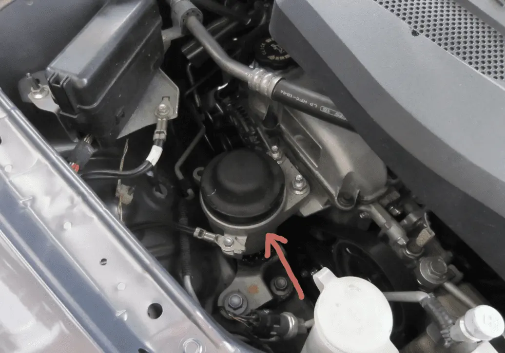

Hi everyone, I'm trying to ID a part on my 2008 CX-7 Turbo. It seems to be leaking oil at the base but I'm not even sure it's a part that has any oil in it given the fact it has a ground lead attached to it. I searched high and low but not knowing the name of the part leaves me stumped as to how to find it. Any help would be appreciated.

That is the front right motor mount, they are actually oil filled and are known to go out. When i was a service advisor at a mazda dealer we would see this all the time. So you just need to get one and replace it.
