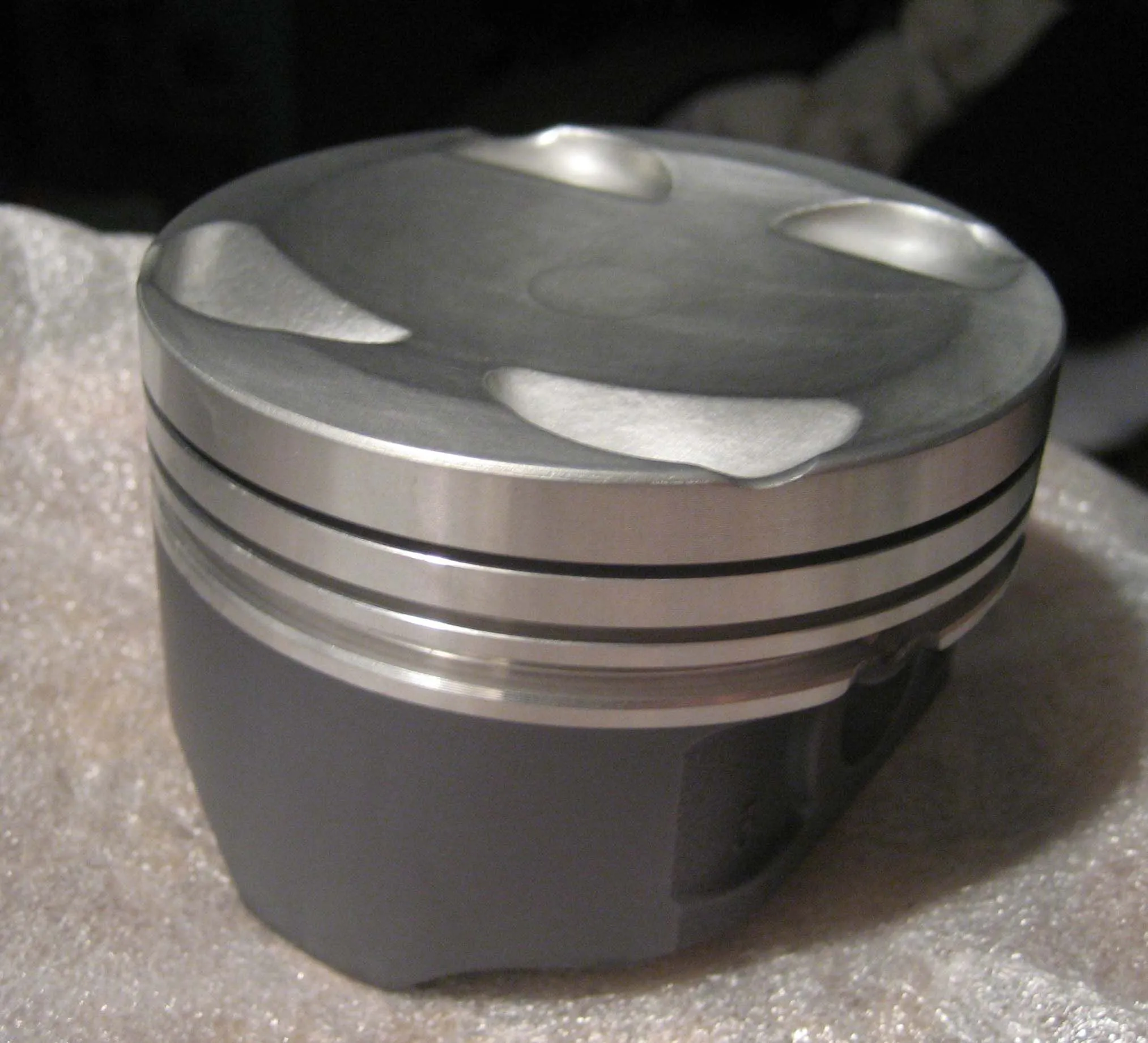

I got the pistons back from classic coatings today. The ceramic coating on the top of the piston is clear and the moly (Molybdenum disulfide) coating is gray and on the skirts of the piston. I was suprised that the ceramic coating was clear as all the pictures I saw were tan colored.
Hopefully, these will be going in next week while I wait for the head to finish getting P&P.
what's the benefit of the coated pistons?
