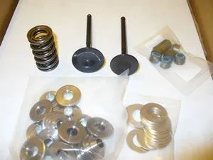

The Parts - continued
Anyways back to the build.....
I have decided to add the oversized valve, spring, and hardware package from supertech and crossover auto through PG. I'm going with the single spring for a little extra closing power and because im not pushing redline too much. There is no reason why my head shouldnt breathe well at high rpms now! The limiting factors will now probably be the intake and exhaust like LW said. PG has agreed to port and polish the head and size for the bigger valves all in one step!
