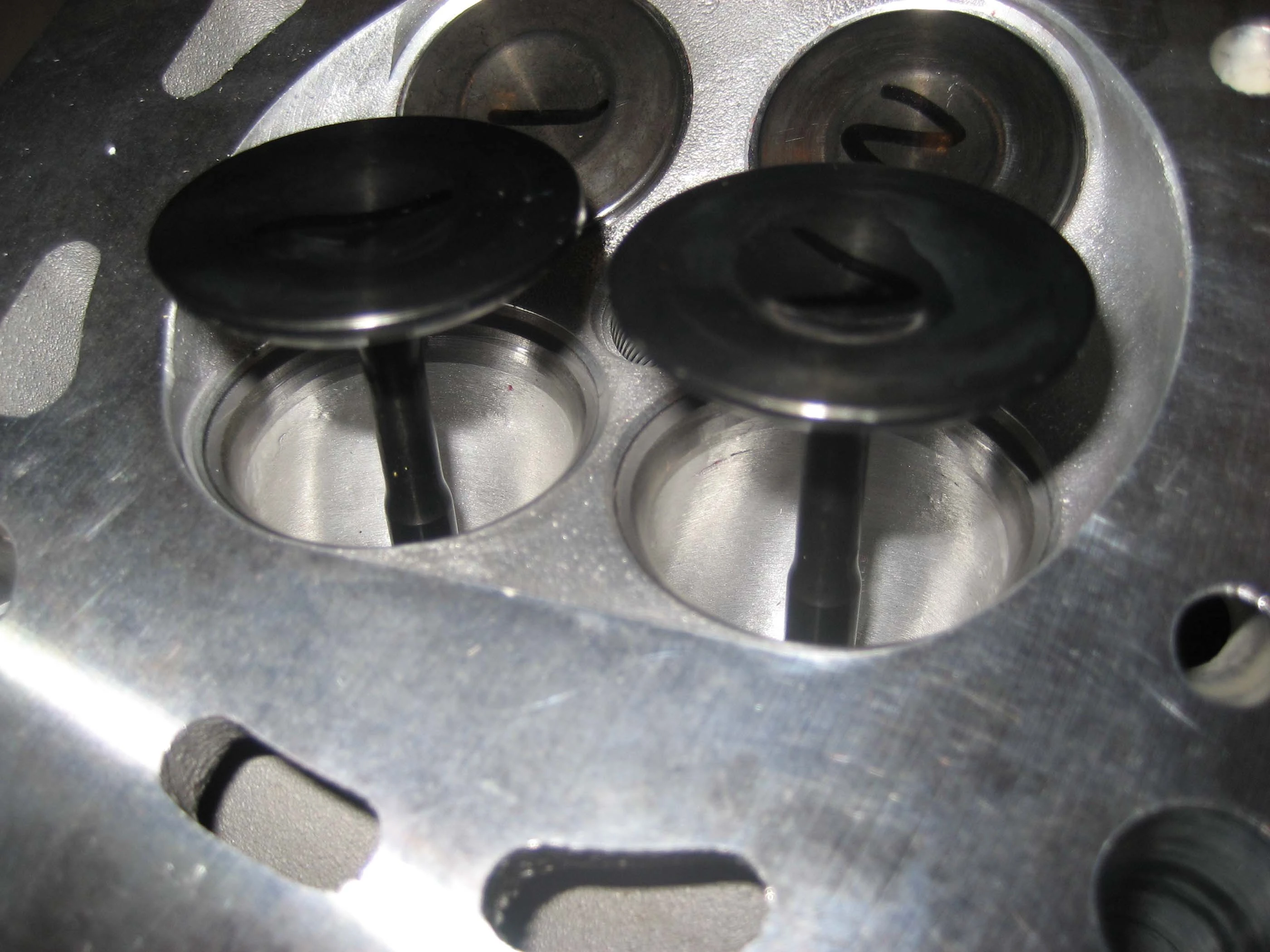

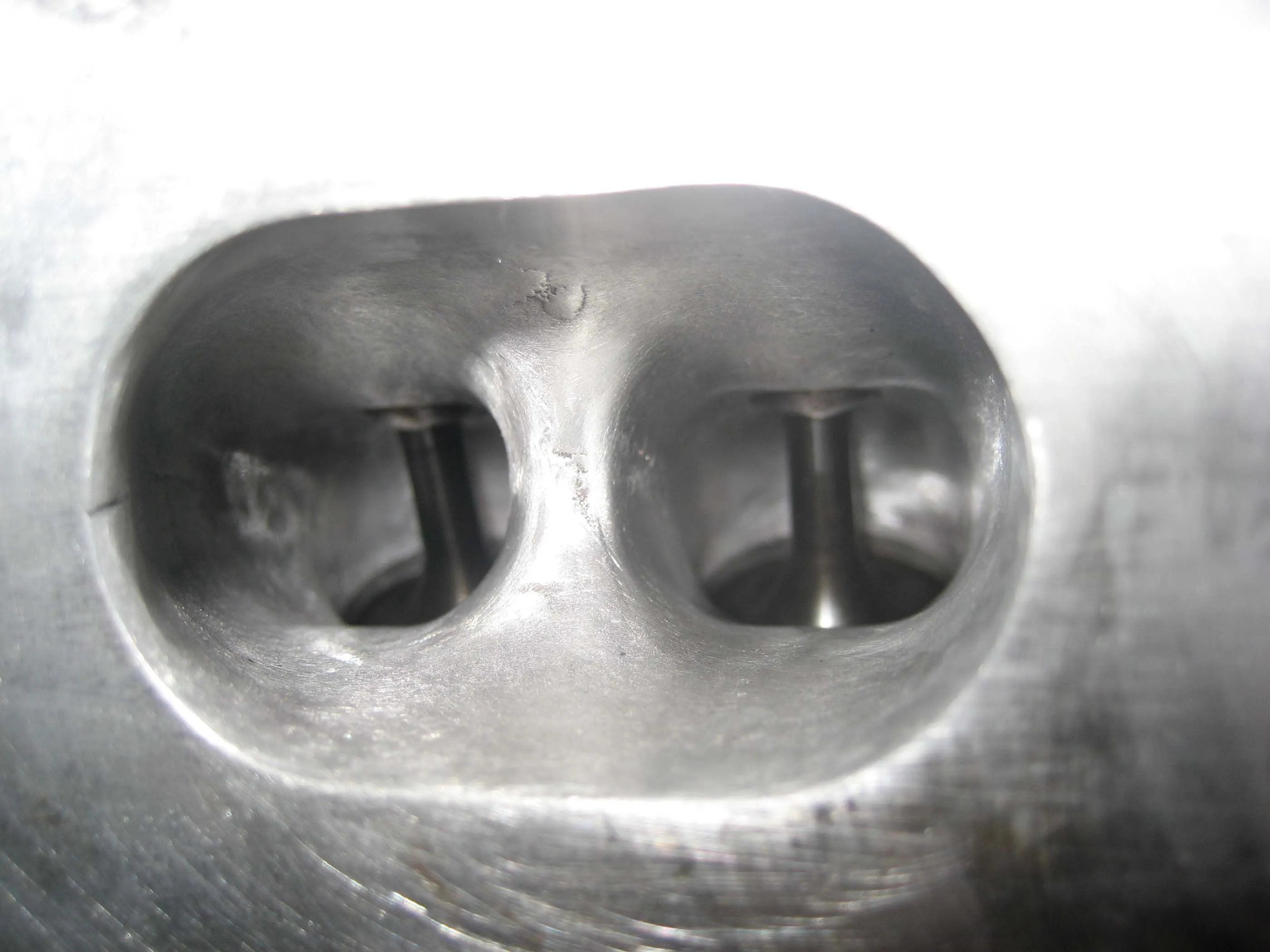

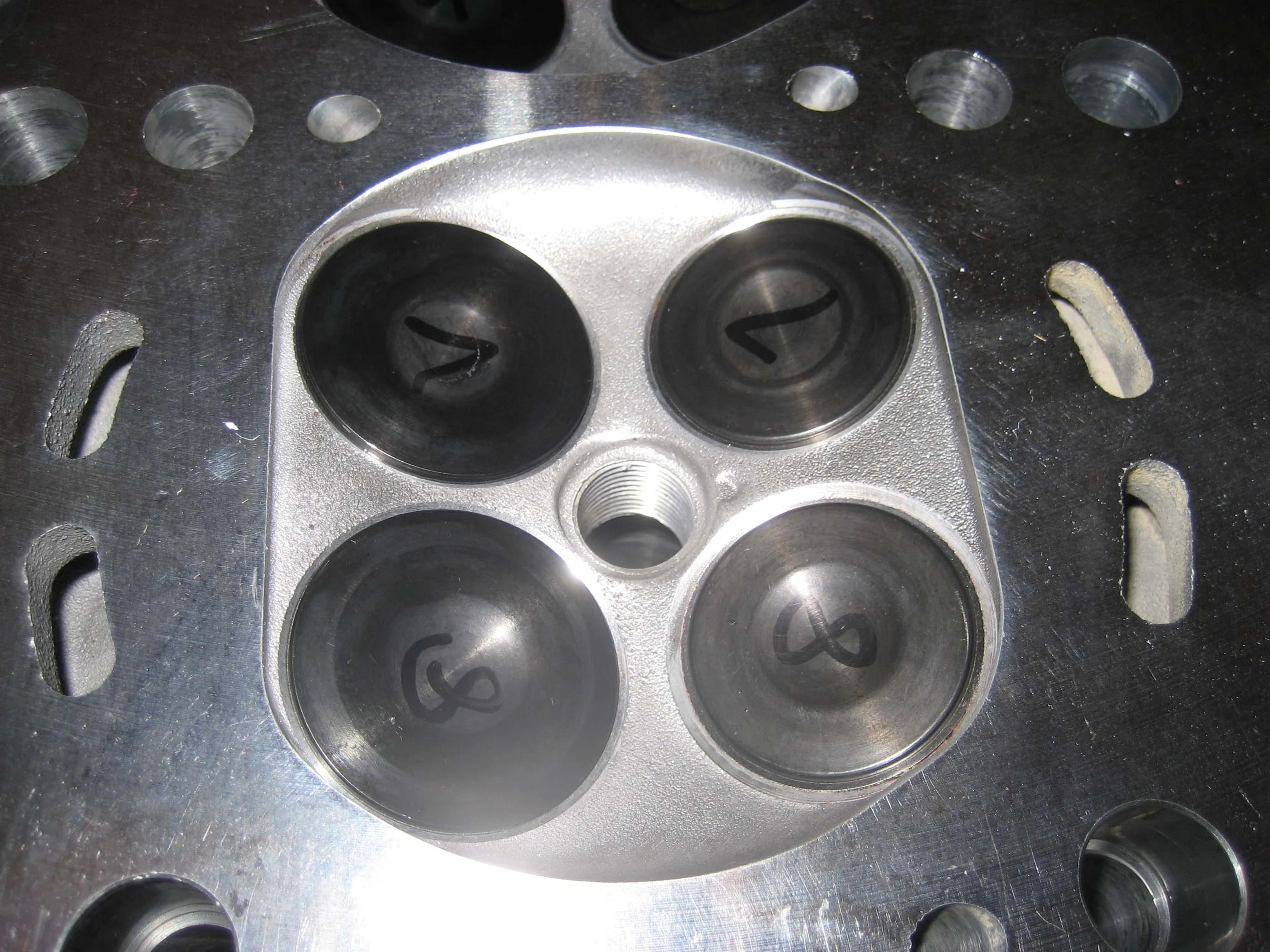

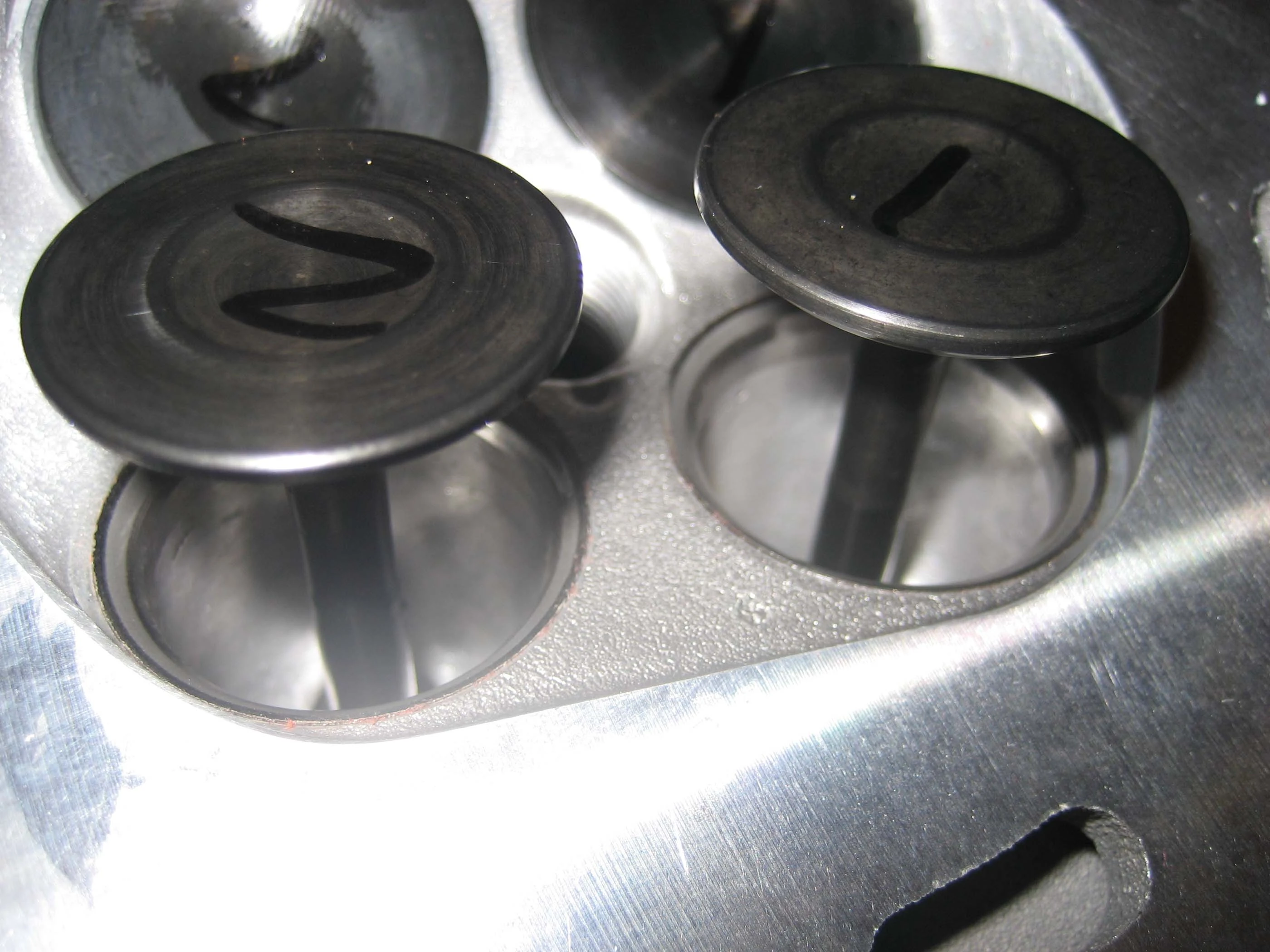

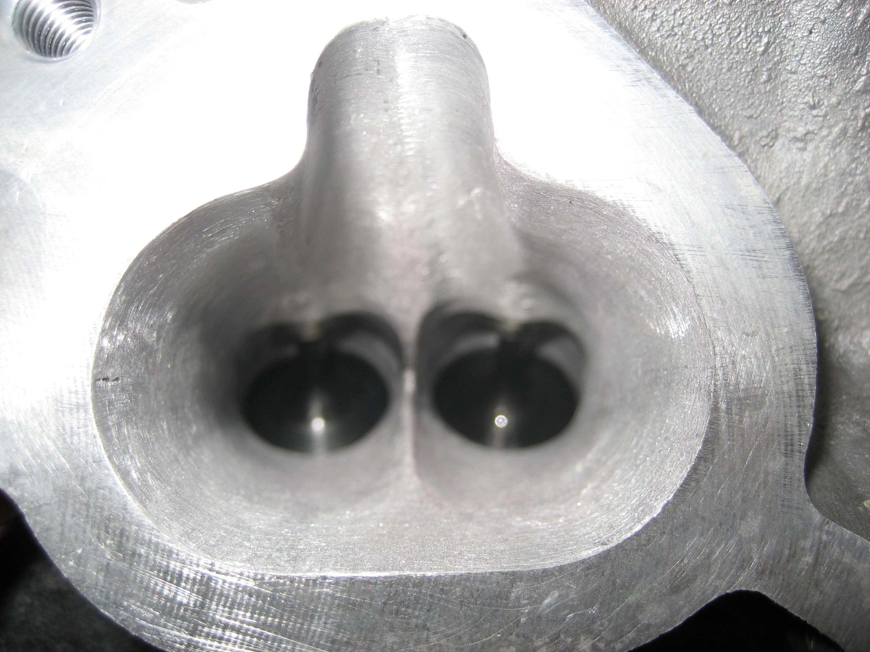

Got the head back from Protege Garage today! It looks awesome. the oversized valves fit perfect and the springs and retainers seem as though they fit great. What are you still doing reading my post look at the pics!!!
Go back and check the fist page if you want to compare.
pic1 - 1mm oversized valves from crossover
pic2 - intake 3 angle valve job
pic3 - exhaust 3 angle valve job
pic4 - exhaust P&P - smooth as a baby's butt
pic5 - Intake P&P - no more ugly casting marks

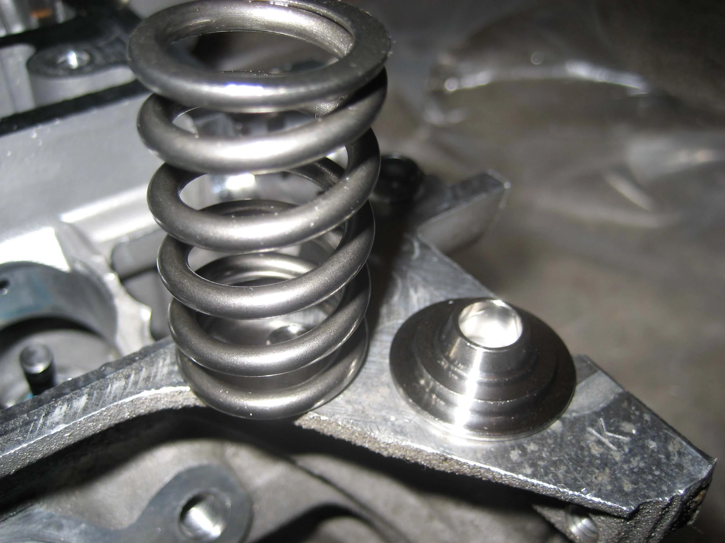

more pics...
pic6 - 55lb single spring and titainium retainer from crossover

nice head work - did you happen to get numbers off the flow bench? would be useful if you did (before and after), because it will give others an indication of just what X cfm @ Y lift means from an NA power point of view.

also, with agressive aftermarket valve springs, what sort of redline are you looking to push? the twiggy cams should, as they stand, comfortably support an 8000rpm rev limit, more with dialing them in properly - but you'll get some crazy piston speeds at that sort of rev limit (as you can see in my spreadsheet posted somewhere in the race thread)......
Quote from JDM Sam reffering to the aftermarket springs available through Ken at PG from crossover and supertech
"There are also 2 versions. single spring and dual spring.
This is the difference in the springs.
Factory springs have about 45 lbs of seat pressure (at closed valve)
Single: 58 lbs (+28%)
Dual : 85 lbs (+ 88%)
So depending on your build goals there are 2 choices to go with.
The dual is recommended for people who plan on getting aggressive cams, big boost, increased rpm.
The single is recommend for a more conservative build."
I went with the single for a little more peace of mind concerning valve float. I hope to run red lines of 7000-7250. Not too much more since i still have stock rods.
