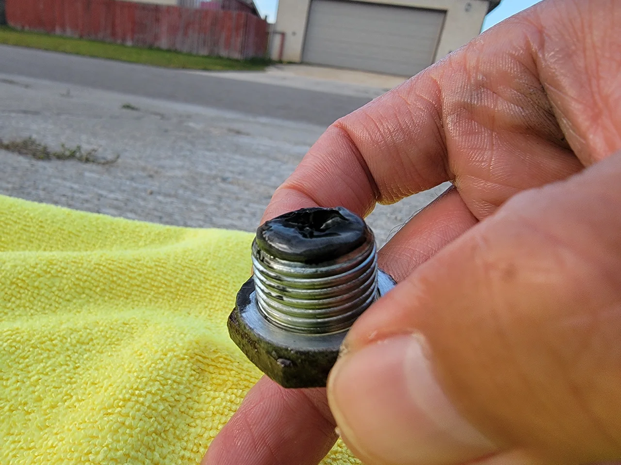

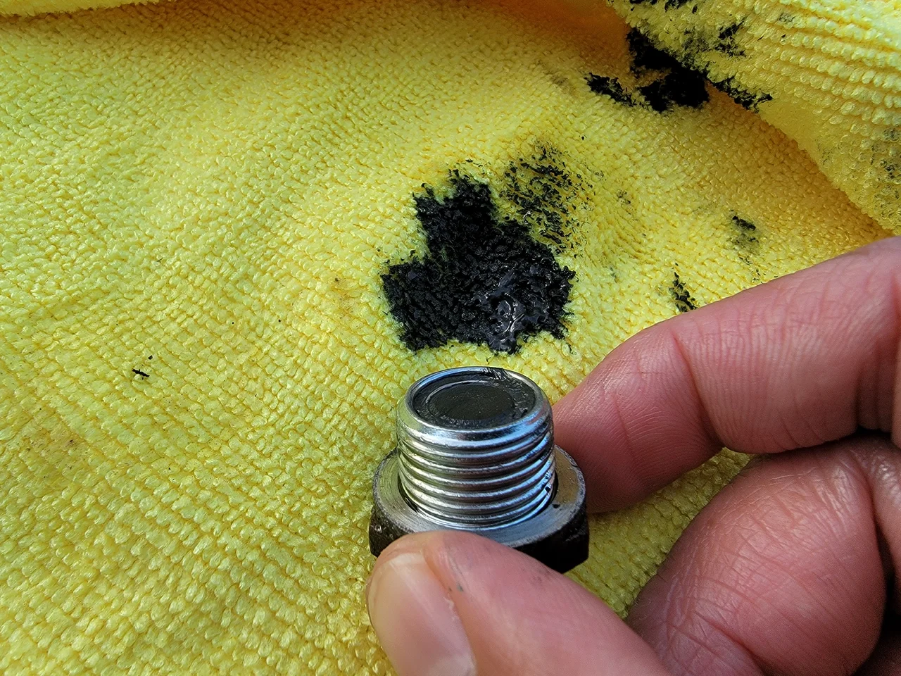

The diff plug does have a magnet in it. I did a rear diff oil change on my 2022 CX-9 as soon as I bought it (used with 70k kms). The fluid was a honey-coloured and the plug had a small amount of metal on it (pics below).

I'm glad to see a magnet that is picking up clutch dust.
