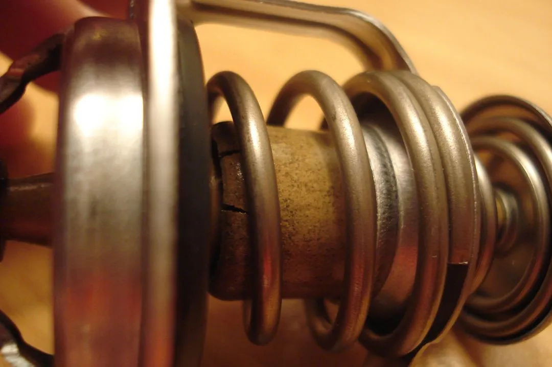

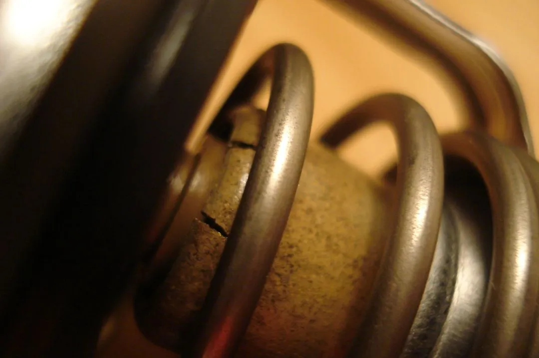

Think this could have caused the problem?
There was it just wasn't close enough to really tell what the caption was referring too. Thanks again
