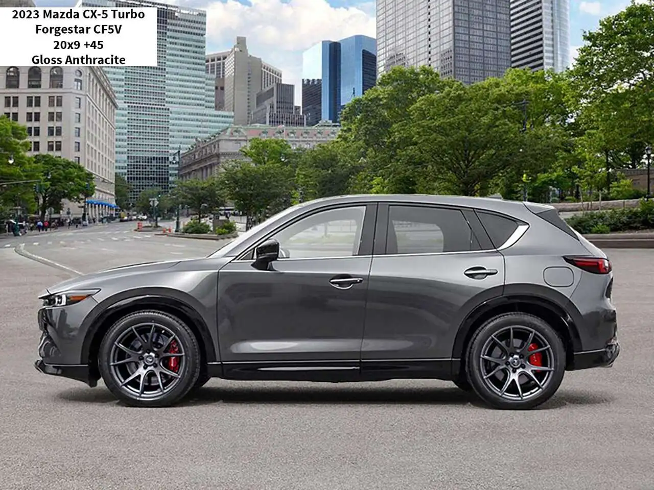

This should be my last post on the subject pre-purchase.

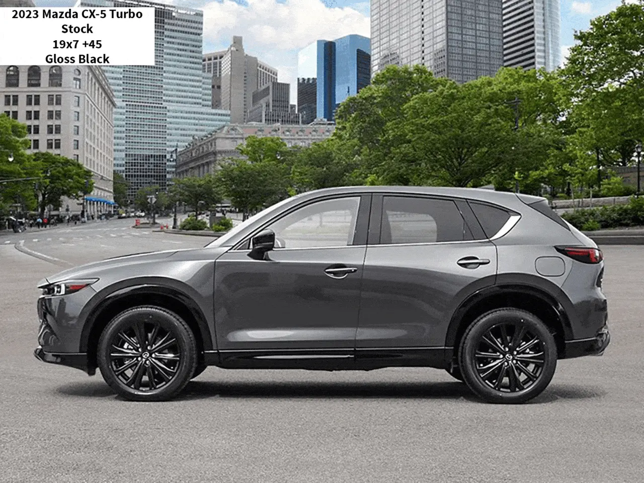

I have decided on an offset of 45. And here is a better mock-up:
This upgrade will:
  1. Get better-looking wheels that are also easier to clean.
  2. Allow me to run Continental DWS06 Plus tires, which is not possible on the stock wheels.
  3. Combined with the Corksport springs, dramatically improve handling and eliminate the ridiculous stock stilted look.
Barring anything unforeseen, I'll place the order next week.
