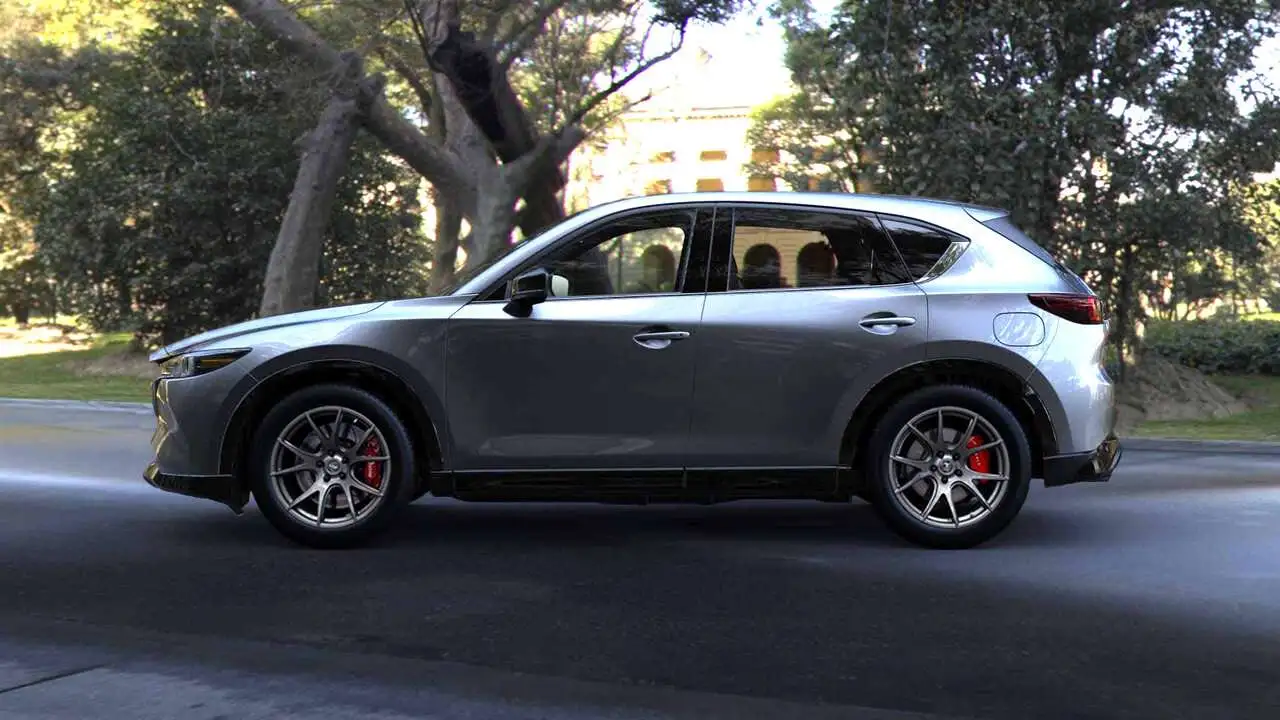

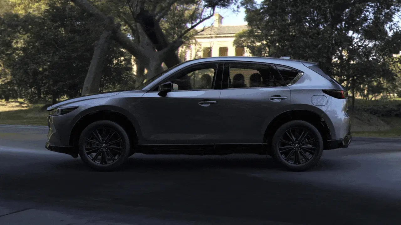

Wheel Photoshop!
These are 19" with a 2" drop. Yes I know I lost the shark fin when lowering the car :)
Gloss anthracite, daytime and evening. What do you think?
Thanks to the donor Tesla Model 3 I found on the interwebs for making this possible.
Wheel choice and color look very good to my eye but yours is what matters. Note that the small brakes on the CX5 will not fill the wheel like image. As for your original question, many people will tell you how terrible it is to increase wheel size (fuel economy, ride comfort, etc.) but my experience has been great. I run the DW06's 255 on a 20x8.5 +40 wheel. I do live in North Carolina so harsh roads and conditions are not an issue. I used to live in New Jersey/New York and potholes would have been a concern. My wheel setup is lighter than OEM so no negative hit there. If the ride is stiffer than OEM, it's not by much. BUT, my confidence in cornering, rain, and stopping is much, much higher than with the stock 19" setup. Search through the "Show me your wheels" thread and you'll find that 20x8.5+40 is a standard, conservative setup with either 245 or 255s. My front is perfectly flush (no poke) and the rear could use a 5mm space to achieve the same flushness. Honestly, I'm still a little disappointed in the tire width. It still looks a bit narrow to me but much better that the skinny OEM legs. I wonder if a 9 inch wheel would have made a difference but I went the conservative route. Hope this helps.
Which wheels are you running? I might have seen them; I did go through that thread. The best fitments seem to be 8.5" +45 with the DWS06 Plus, based on the fronts, of course. You will always have more room at the rear. I measured from the fenders with a weighted string and there's 20mm of width that can be added to the front and 25-30mm at the rear to get the tires flush. I figured with the DWS06 Plus being a more substantial tire in terms of the sidewall that I didn't want to push it. Note that I'm talking about the widest part of the tire sidewall, half way between the wheel and the tread.
I do have the option of 20×9, but that requires +51 to be equal, and I worry about rubbing on the inside. Your proposal would be 20×9 +46. I'll have a look and see if remember seeing your ride.
Edit: I found your post again. There does seem to be a very tiny amount of poke. As in, if you were to imagine lowering the car several inches, at what point on the tire would the fender touch?
