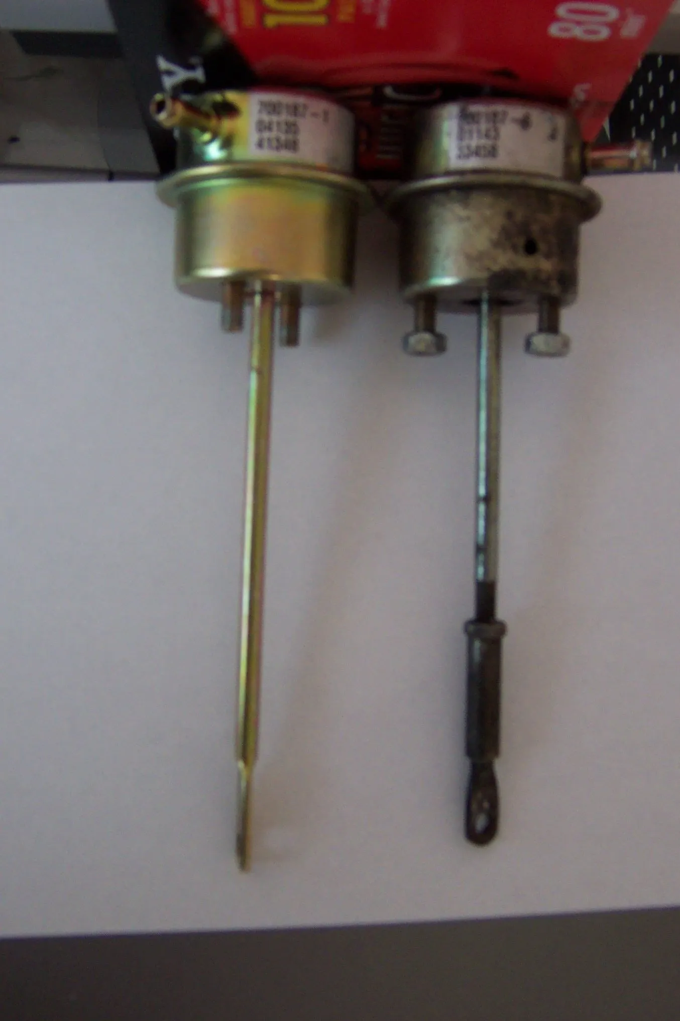

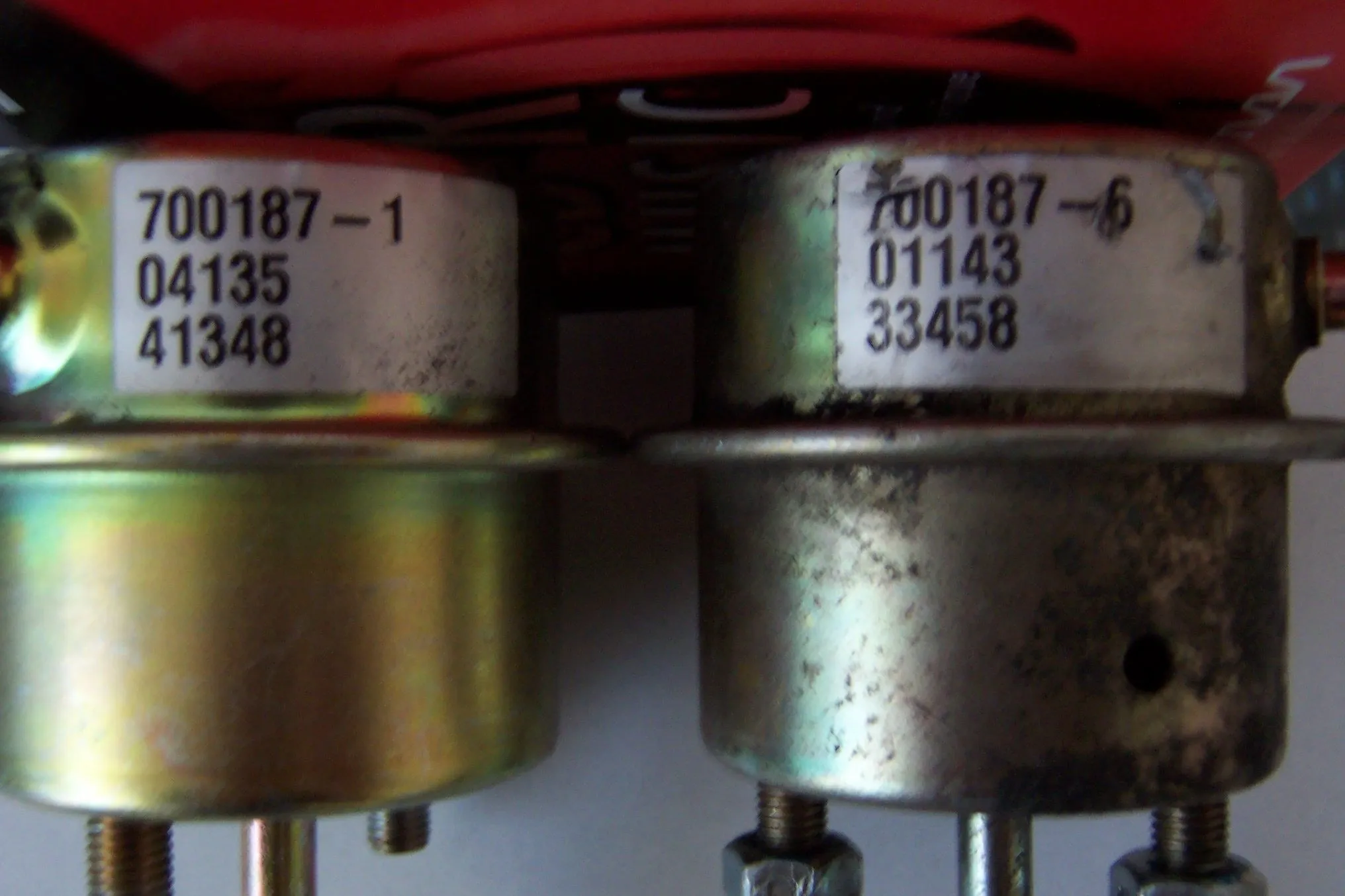

check this pictures against what you have
see if the numbers match
the old one is the one with the nut in the middle and it looks very old and used
the new one..well..looks new
SeR_Cyclops said:
i installed my self didnt take long we didnt have to remove the turbo or anything but they could have sent the wrong one.

i will see if they match tomorrow are the numbers going to be a b**** to read or no? b/c that little heat shield is prolly in the way.
If you can't see it try a mirror and a flashlight. usualy does the trick.
i can only do so much :P
lol
good luck dude
i recommend waiting til the car is cold...is a b**** getting burn with the exhaust many..and i don't think you would like to have a "calway" tattoo in your arm
