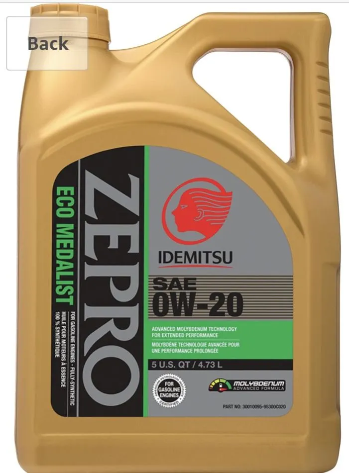

I recommend the Idemitsu 5w-30. Idemitsu makes (made?) the Mazda high moly 0w-20

The Mazda 0w20 bottles I have state "with moly" on the label.
Does this Idemitsu have moly?
Idemitsu Zepro oil has high molybdenum content and many suspect it’s the same oil as OEM Mazda moly oil. But Idemitsu is phasing out the Zepro oil which is the SN / GF-5 oil, and coming out with new SP / GF-6 oil which may contain minimum molybdenum.
