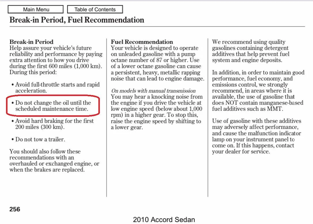

Honda does officially state that the owner should keep the factory fill according to normal OCI (7,500 miles) at the Break-in section in owner’s manual. And Honda also said many times they use high-moly break-in oil in factory fill. As for Mazda, the owner’s manual says they use Mazda genuine oil, and the UOA indicates the factory fill from CX-5 has very high content (~650) of molybdenum which is similar to Mazda moly 0W-20 oil. That’s why I changed the factory oil at 5K miles with OEM Mazda moly 0W-20 oil.
I'm fully aware of what you're pointing out. As I said, there is nothing wrong with keeping the factory fill in for the full initial OCI. But if you want a more nuanced discussion about this.....
The high moly in UOA's of factory fills is more/less universal across all makes. Multiple technical sources attribute it to the high-moly content in assembly lubes that are used heavily in car engine building and which get mixed into the factory oil fill on initial startup, not a special oil. And I repeat what I said earlier - 95% (probably a conservative number) of engine break-in wear has occurred in 2K miles, so continuing to use a high-moly oil for the full normal OCI will have negligible effect on break-in. Conversely, getting the relatively contaminated break-in oil out of the engine and replacing it with clean/fresh oil for the remainder of the first OCI MIGHT be beneficial.
Why does Honda admonish owners not to change the oil early? It's probably because their experience is that owners are very aggravated by having to bring in a car to the dealer after owning it for a few weeks - compared to other makes, it makes the vehicle appear to be "high maintenance". If keeping the break-in oil in an engine out to the full normal OCI results in "acceptable service life" out of an engine, then acceptable is good enough even if there is some benefit to an earlier oil change. And the expense of early oil changes to rental car fleets and commercial service would be onerous. So good enough is good enough. But that doesn't mean it is optimal.

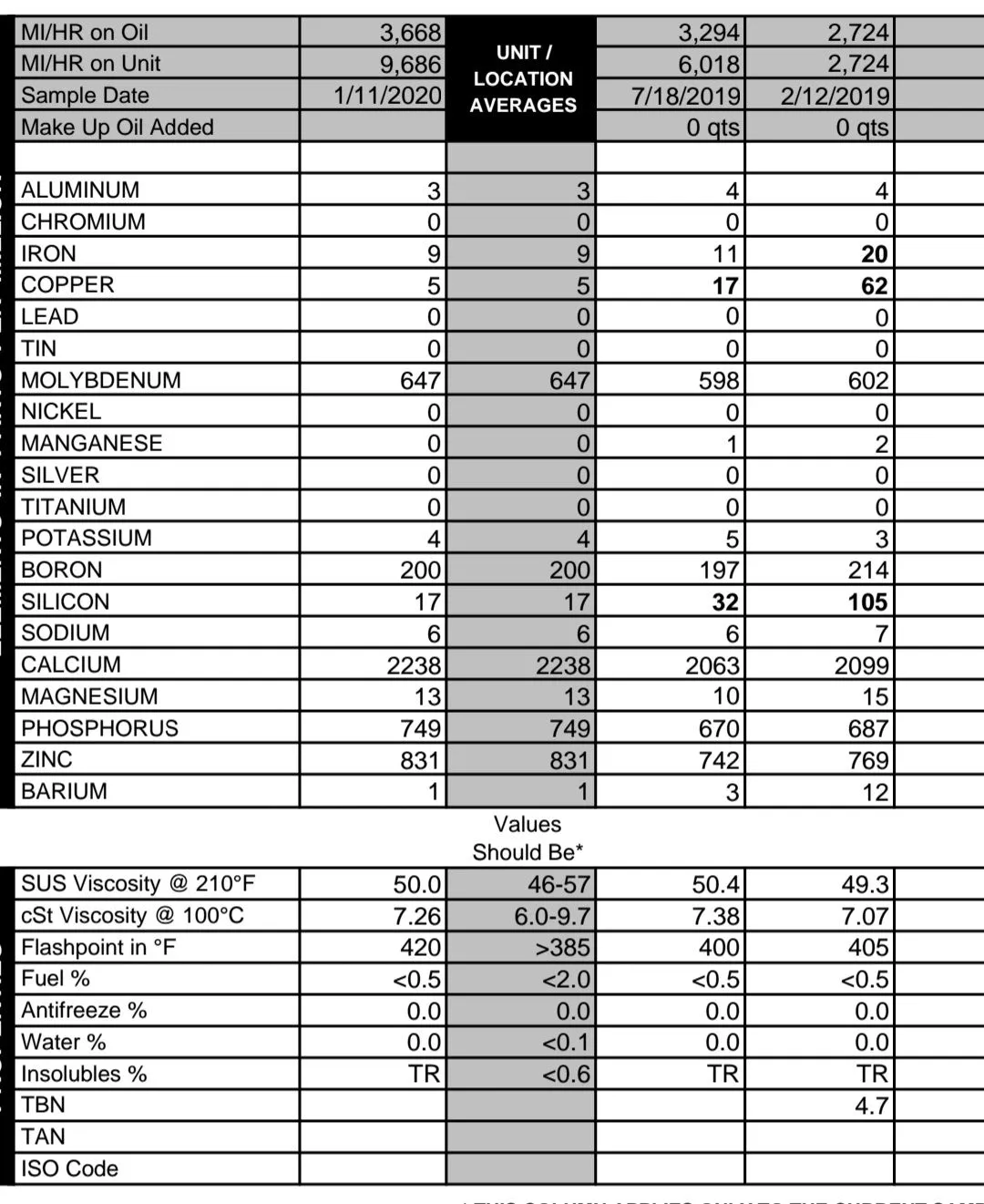

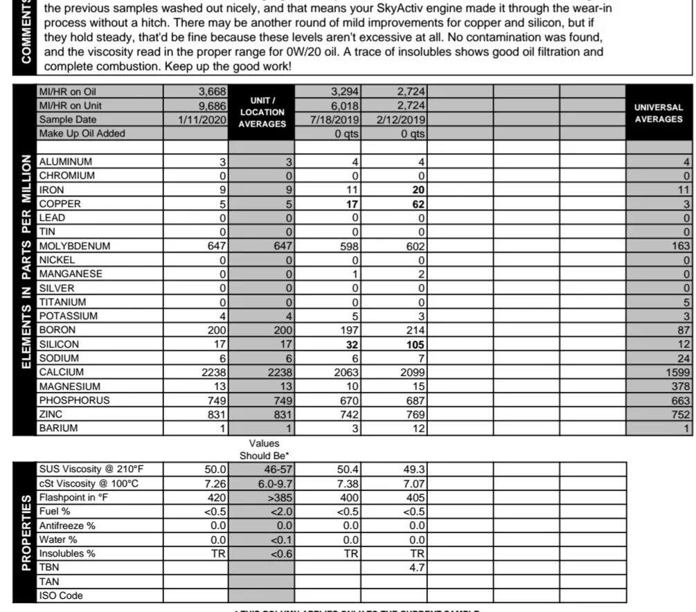

I experimented with this myself for grins and giggles . I did the first oil change early at 2500 miles on my ‘19 RAV4. I drained at 10000 miles and did a UOA. Wear metals were still somewhat elevated, so “break in” wasn’t quite done at 2500 yet. Insolubles were less than 0.1% indicating great filtration by the OEM filter.
We can see that by changing oil early most of the silicon, copper and iron is out early as well.
This is from the NA engine but we get the idea. And yes as mentioned above we could conclude that by 6000 the breakin is done already and parts are stabilized.
Whether thats really needed is another matter.

What oil results is displayed cz5gt? Moly & Boron does't match oil I've seen. Ed
The oil used is Mazda oem 0w20 for the non turbo engine. It has high moly content. oem filter as well on every change.
Can you post the comments from Blackstone and the universal averages column on the far right?
Why are you changing the oil the every 3k miles?
