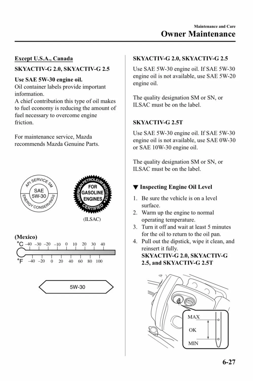

Yes, Mazda has never recommended conventional oil over full synthetic oil on the 2.5T. That Mazda dealer simply lied to the customer.

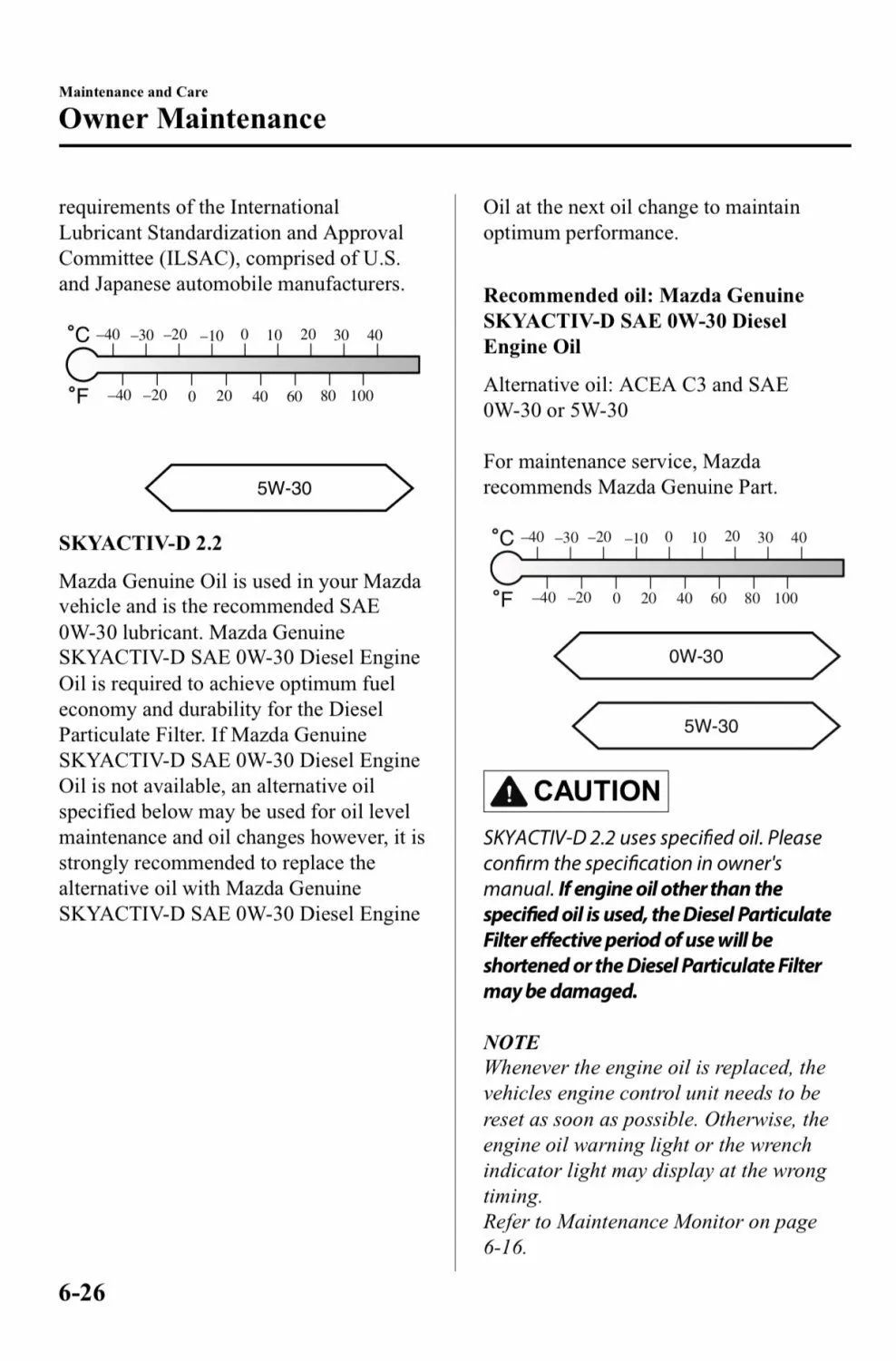

Here’s the engine oil recommendation from 2020 Mazda CX-5 Owner’s Manual. Interestingly Mazda recommends 5W-30 oil instead of 0W-20 on the 2.0L / 2.5L worldwide except in the USA and Canada.
I was told at the Mazda dealership that they do not recommend using synthetic oil in the turbo engines. < This is true. They said synthetic is more prone to burning oil consumption in the turbo engines especially when you get up around 100k on the motor. < This is not true.
The dealer lied to you. While Mazda does not recommend synthetic, Mazda also does not recommend conventional. The only requirement that is specified for the 2.5T engine is 5W-30 oil that meets the API cert. This has not changed since the 2.5T debuted in the 2016 CX-9.
Turbocharged engines typically run hotter than a similar NA engine. A full synthetic oil handles high heat better than a conventional oil. This is usually why most people will choose to use full synthetic over conventional on these engines when presented with the option - plus the longer OCI in some cases.
