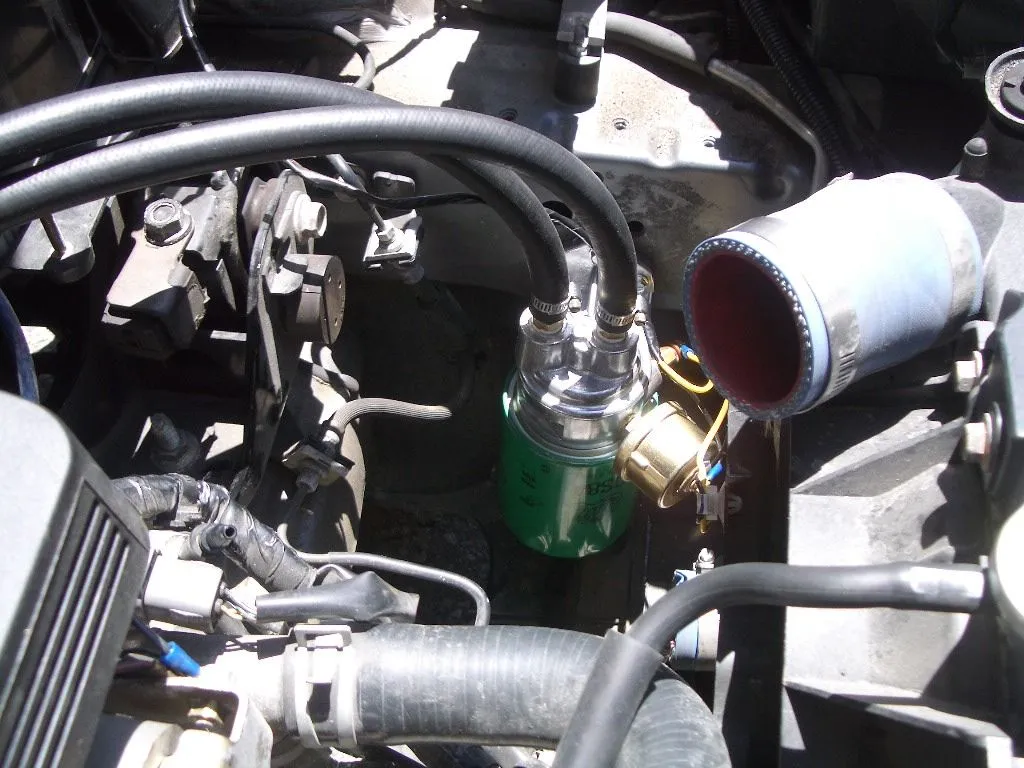

Since YP5 brought it up, here's a pic of the perma-cool kit installed. part numbers from summit racing: PRM-10195 and PRM-1060.
I got the additional fittings for the thermostat separately (and cheaper). the relocation kit is now installed along with the Greddy Oil Filter Block Adaptor. I'm reading oil temp of 220F once the car is completely warm. the thermostat is designed to begin routing oil through the cooler at about 185F, and to bypass it at lower temps. This will be especially useful up here when it hits -30C in the winter... the oil cooler is not in yet because I wanted to establish base line readings before installing it.
this pic is with the hardpipes removed for the installation - i've found I need some 90 degree fittings to route the oil lines better, and I need 90s on the spin-on adaptor as well. The filter is an "8A" filter, used on Ford 302s, 351s, and 460s. :)
Edit: for the MSP (not sure about the P5/sedan), if you're going to do this mod, you need to get a shorter oil filter mounting bolt (part number BP4W-10-319 from your mazda dealer) and a second nut to help take off the old bolt and install this one (# 9992-22-000). I believe it's a 22mm deep socket, but it might be 24mm. can't remember. I left on the MSP oil cooler as I didn't figure it was doing any harm (or any good).
