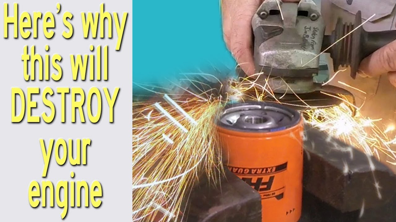

There are some very interesting videos on Fram filters.
I can see your point, BUT, first of all the video is 4 years old, second of all, it's not the Ultra which is constructed differently. The video you show is actually the reason I've avoided Frams for years, but the Ultra appears different, advertises a filtration of up to 95% of particulates up to 20 microns, and has a different filtration medium. I'm not defending Fram, but there are a lot of good reviews on BITOG for this filter which includes independent testing. Just figured I'd give it a try.
Ah yes, the infamous Fram OCOD: Orange Can Of Death. Those truly are junk. Their better filters are indeed better though. However, the price of the better Fram filters are more than the price of Mazda OEM filters. So why not just use the OEM? That's my thoughts on the subject.
