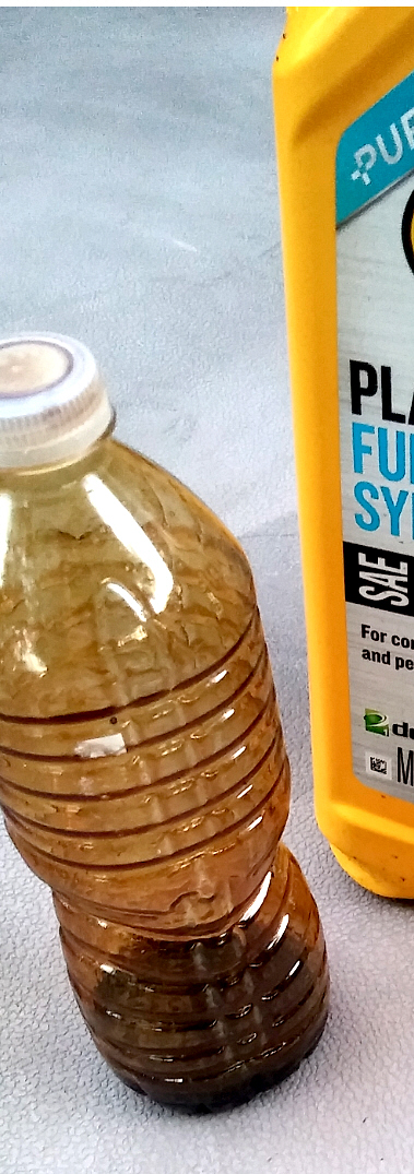

I sent ours in to Blackstone at 4,800 miles to get an actual, scientific analysis of it because I've always heard things like what you said. They said:
"The far right column shows average results from all of the healthy 2.5L SKYACTIV engines we've tested. In comparison, there was some extra iron, copper and silicon in this oil but it's actually less than we expected. In the first several oil changes, there's metal from the break-in process and silicon from sealants and lubes used in initial assembly, but it looks like this engine had excellent internal fit and finish right from the start. In other words, this CX-5 is off to a good start. Go ahead and bump the internal to 7,000 miles then check back."
So, I don't think 2,000 miles is really critical though it won't hurt either. I'm sticking with 7,500 mile max intervals too.
