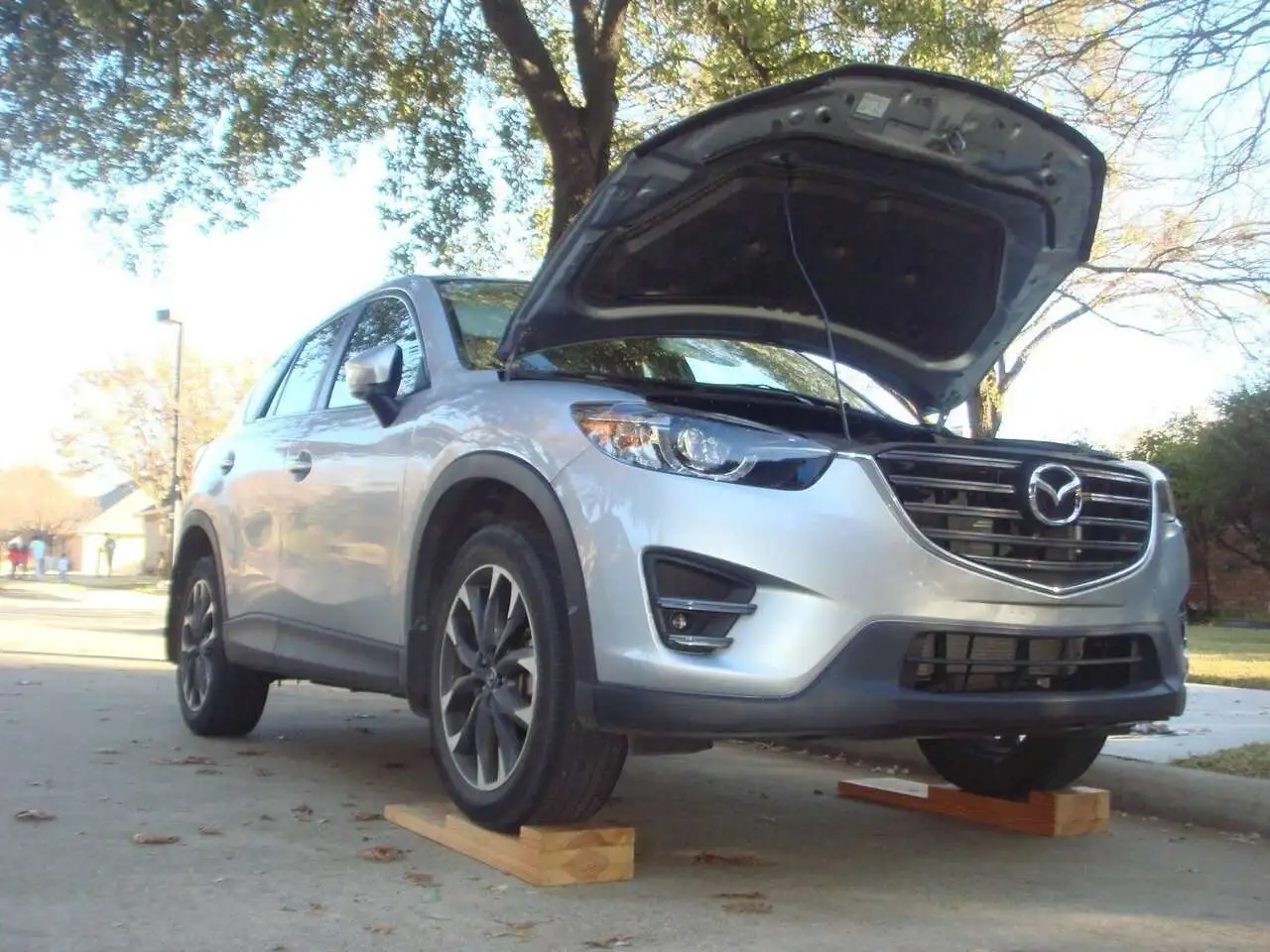

I have to agree with you that your observation is logical. The oil drain hole is at the back side of oil pan with a 30° angle down. If we raise the front end with a standard ramp, more oil should get drained. Many 2.5T owners here claim 5.5 quarts should get you to the Max mark for the oil change although the manual says 5.1 quarts. In my case I need 5.2 quarts for my 2.5L NA to reach the Full mark although the manual says 4.8 quarts. I do raise the front end a bit with my home-made ramp when I drain the oil. That should be considered as almost level.
I change the oil using homemade ramps like Yrwei does. Except I place a couple of 2x10's under the rear tires. The front is still elevated more than the rear but not much. I don't have a turbo and when refilling I just dump in 5 quarts and call it good. I'm not concerned about the small amount of old oil that may or may not drain out, no big deal.
