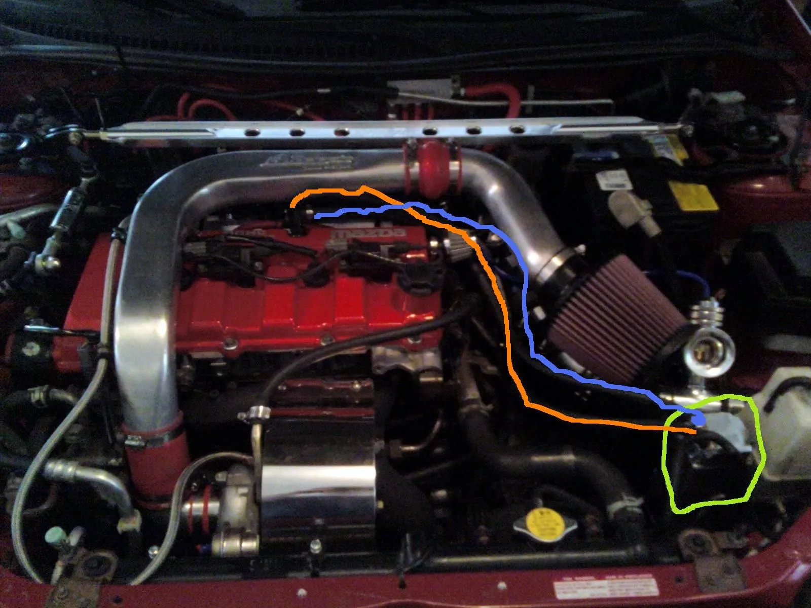

If you look at the attached picture, you can see the oil catch can located on the bottom right of the bov, using the coolant reservor tank's bracket. If you follow the hoses in the picture, it hooks up between the pcv valve and the 2 vacuum ports on the intake manifold.
So one line connects to the pcv valve and other other line connects to the tee of the 2 vacuum ports. Make sure the oil catch can does not have any other open holes, or the car will have a vacuum leak. It must have sealed connections.
As for the vacuum line on the valve cover to the intake pipe, you can either leave that or remove the line and just throw on a breather filter on the valve cover and cover up the intake pipe hole. That is what I did as well.

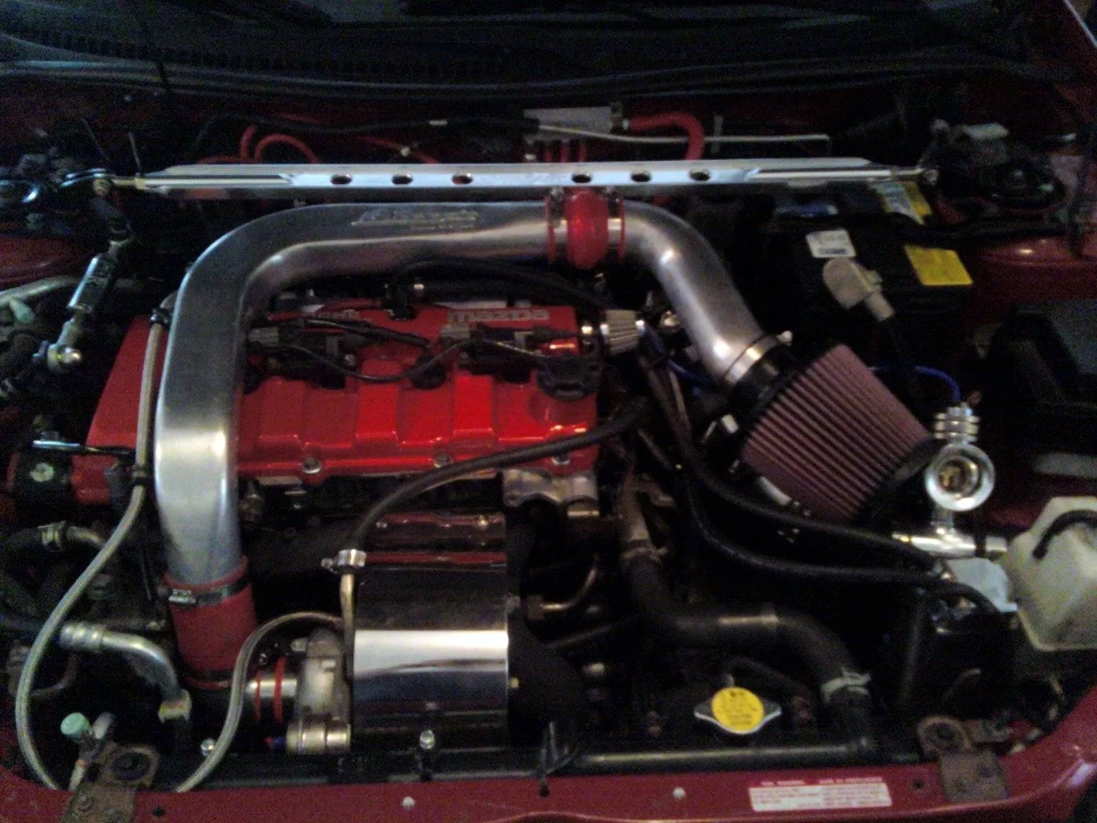

ok, I thought that the oil catch tank went inbetween the valve cover port (one that you have the breather on now) and the intake pipe.. because I am not sure how I can hook into the PCV valve with the 2 vac lines going into it from the IM now, and where did the other line go again.. I saw one connecting to the PCV valve (not sure how, I guess just tighten a lot onto the hole?) and than is the other one connected to the part where the 2 bigger vac lines from the IM connect too? heres a pic of my setup right now... and I guess the point is that is is suppose to be inbetween the valve cover opening and the IM and not between the valve and the intake (which the way you have it set up I guess cuts that off too) so I just take that connector off the PCV that, I guess short silicone hose that T's into the vac lines like I said before.. hmm, LMK, thanks a lot for the help, sounds cool

You can hook it up between the valve cover and the intake pipe, but is not as effective. The objective of using a oil catch can is to eliminate the need of the pcv valve system. From factory, the car has 2 systems in recycling the extra oil and fuel. The first way is the pcv valve system and the second way is the breather line coming off the valve cover.
The breather line vents the extra fumes and gases out of the head to relieve excess pressure, so that line needs to be going to the atmosphere. The breather filter allows filtered air into the valve cover, but does not allow any oil or gas to be sucked in by the air intake.
The PCV only is used when vacuum pressure is created by the engine. At full throttle, it remains closed and it idle it should be open. That being said, you want the can to catch all the excess oil/fuel into the catch can and not back into the engine.
Just do it the way I explained it the first time, it is the best way to do it and allows none of that crap to go back into the engine.

Lol, it is alot easier than it sounds. There are two lines coming off the oil catch can. The oil catch can hooks up between the pcv valve and the vacuum lines. So, one line from the oil catch can goes to the pcv valve, and the 2nd line from the oil catch can goes to the tee of the vacuum lines. Here is a picture from paint
