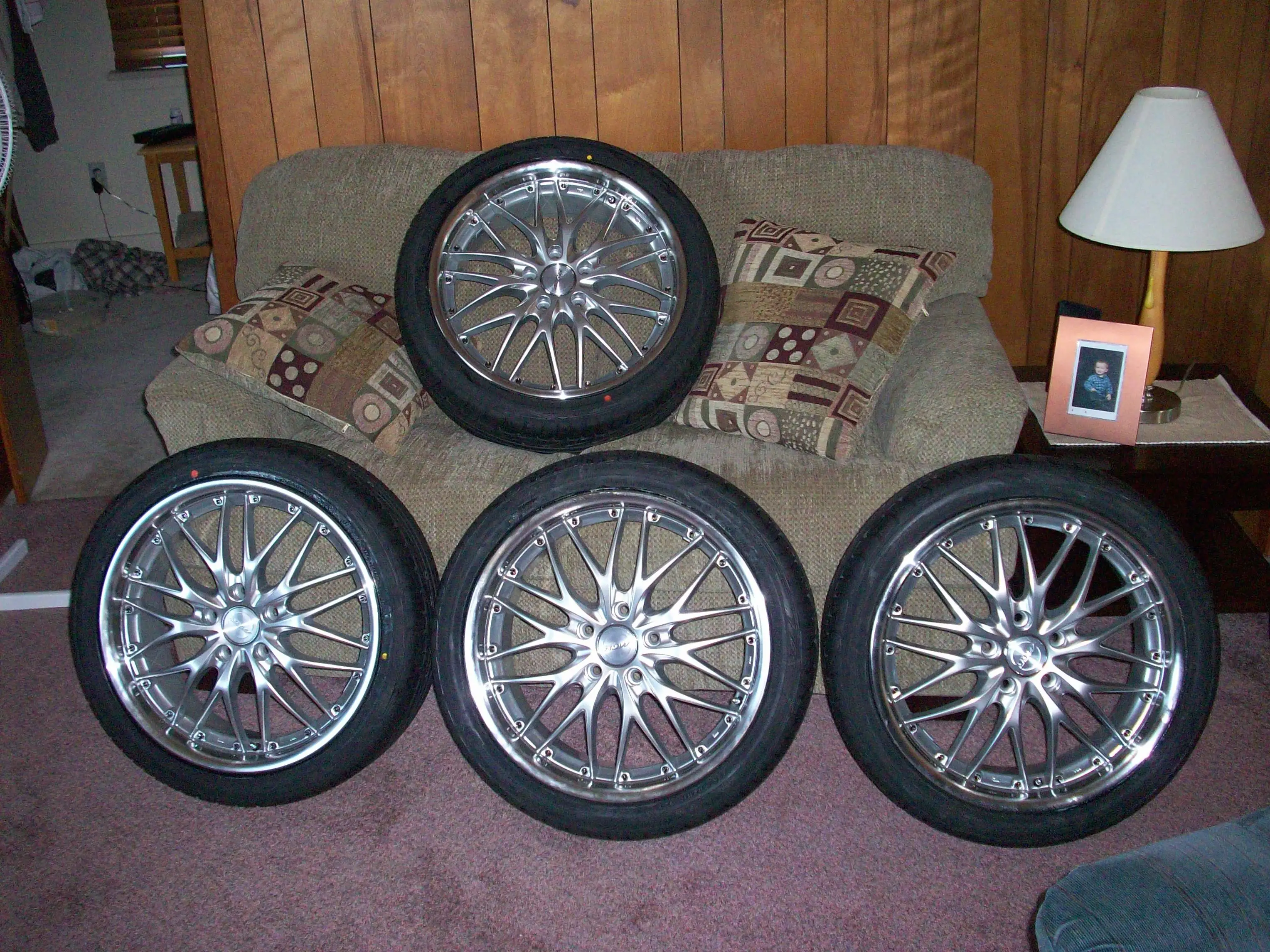

I ended up buying a set of MRR GT1's which are 18x7.5 with a 48 offset, and a set of falken FK452 in 225/40/18, H&R springs are in the mail, super stoked to get it all installed, i apreciate the quick replys.
