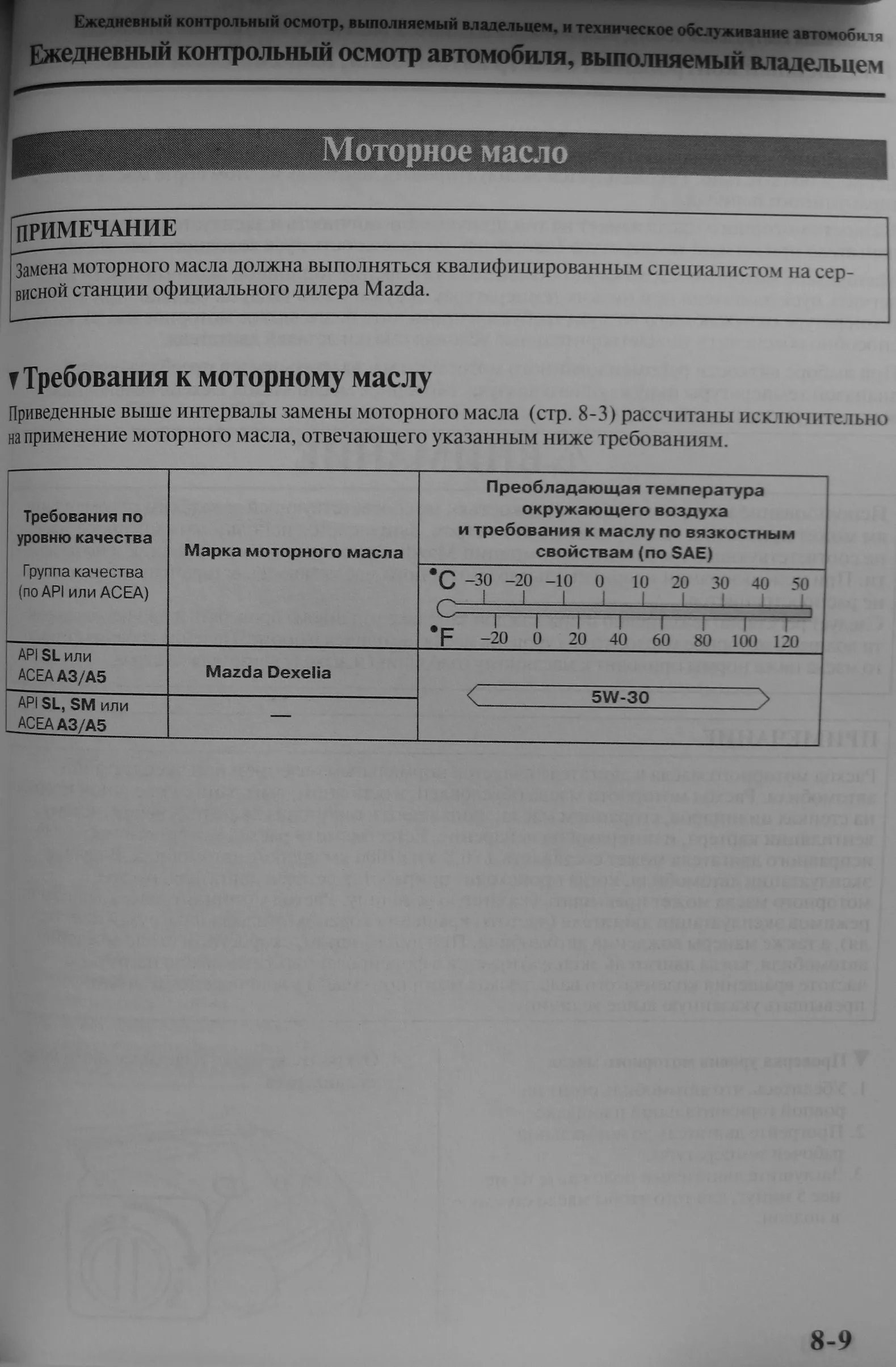

this oil is specified for the MPS 3/MPS 6/CX-7 in australia and europe anyway
Don't know about the others, but euro CX-7 recommends 5w-30. I asked people form a Ukrainian forum to scan a copy of a page from the official european CX-7 manual where oil is specified. It is in Russian, but one can clearly see 5w-30 as the oil type there as well:( And they do complain about smoking on both official European CX-7 cars and "gray market" American CX-7cars at about the same level.
Although other countries aren't recommending it (at least none I can find yet), running 5w-40 will help. If you think you're car is going to smoke, I'd switch and see how it holds up after.
