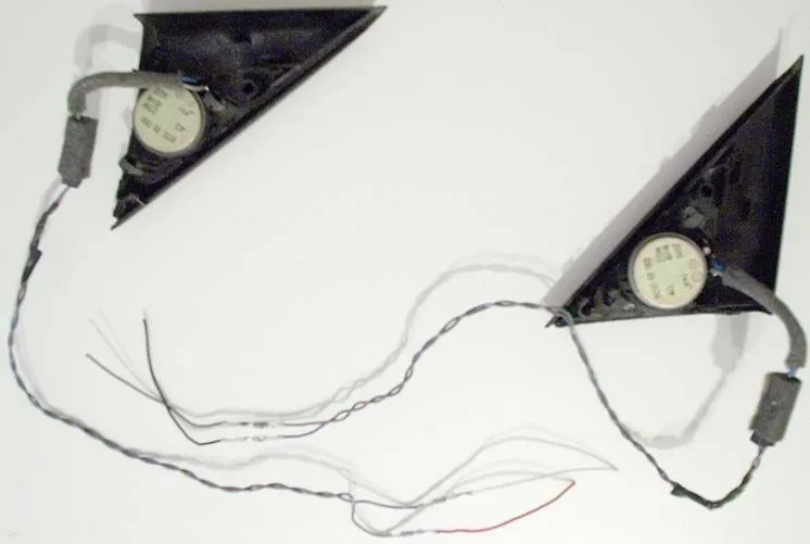

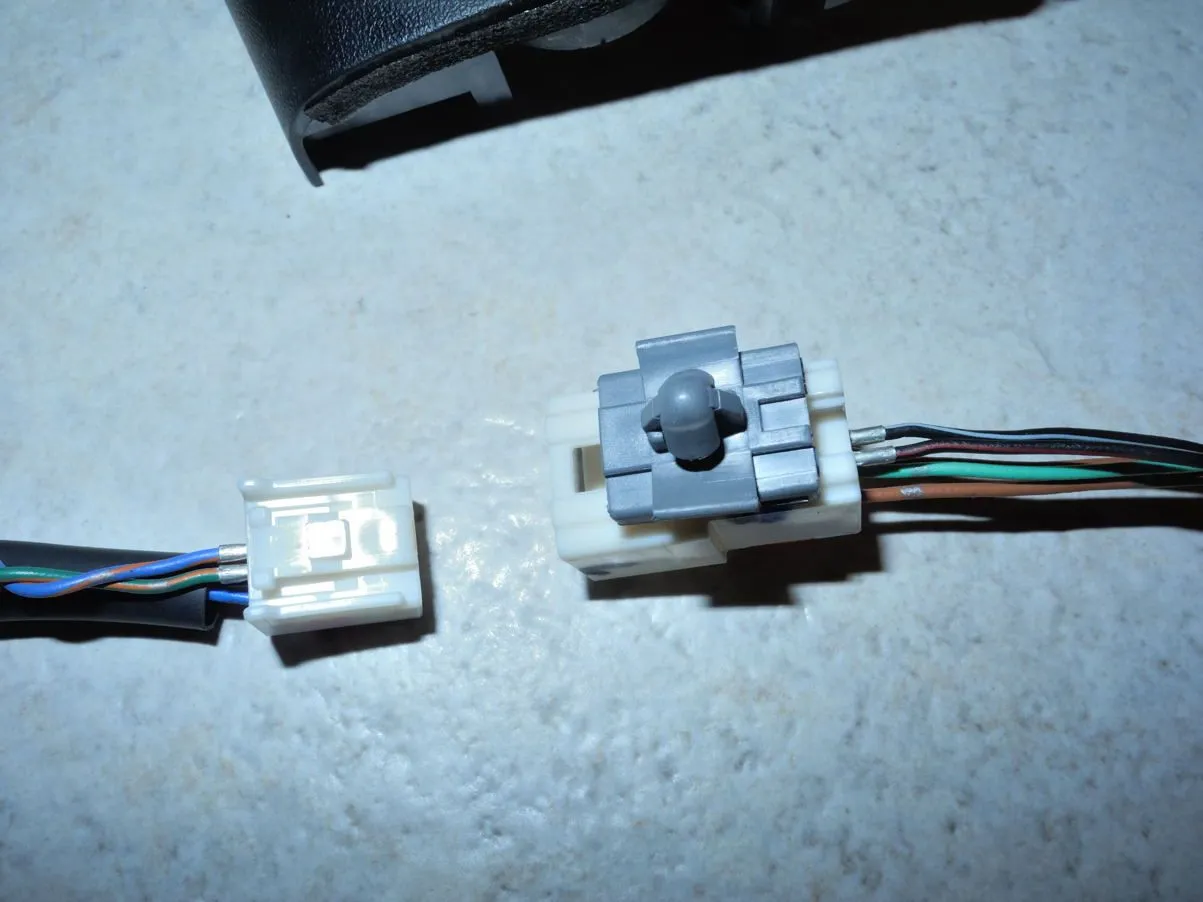

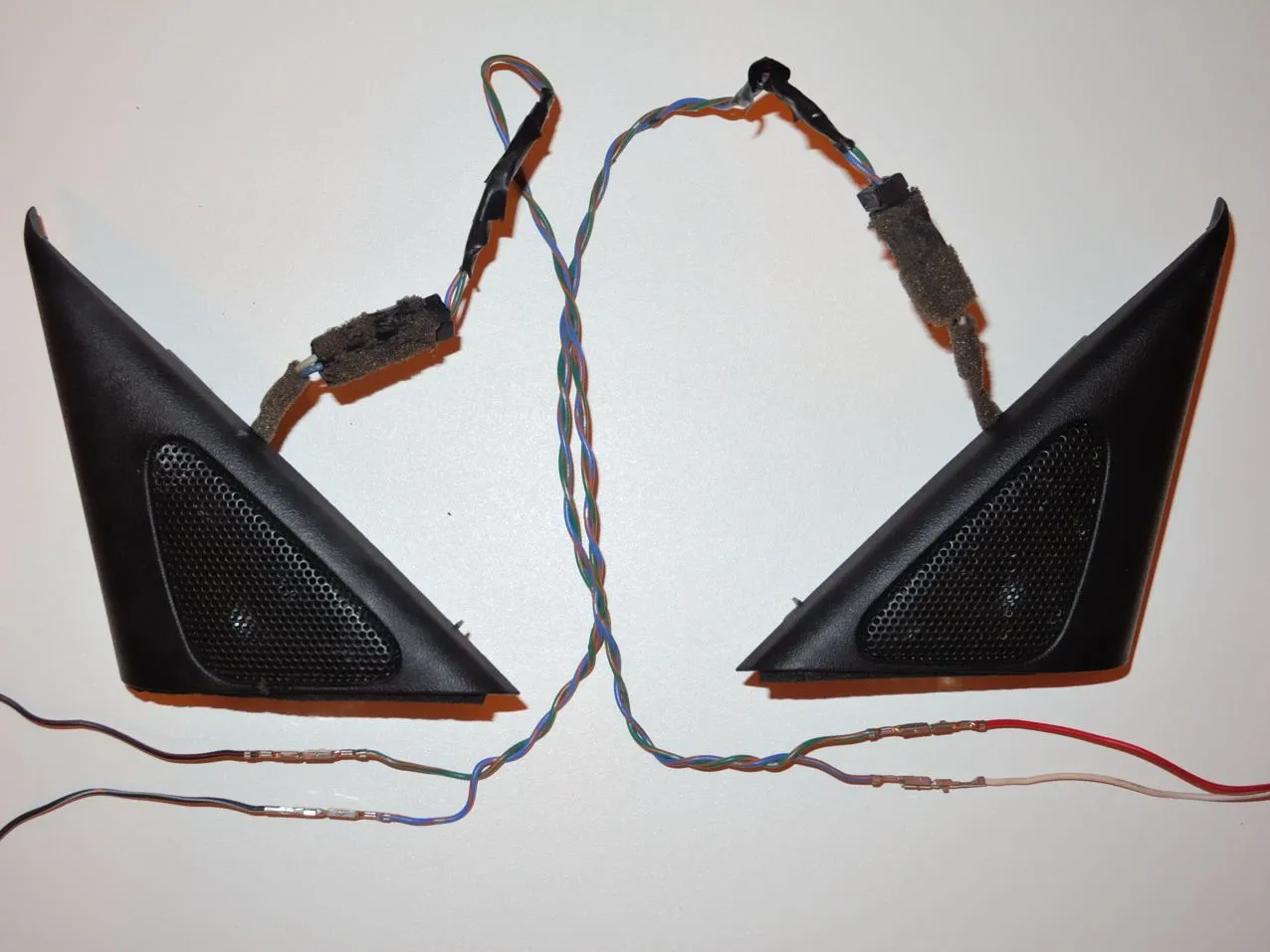

I picked up these from a local guy (david... don't know his forum name) on wednesday when I went to txmzd2gen's birthday party... the guy is getting rid of his car so he told me I could have whatever I wanted... I saw his P5 was an 03 so I jacked the tweeters WITH the necessary wiring

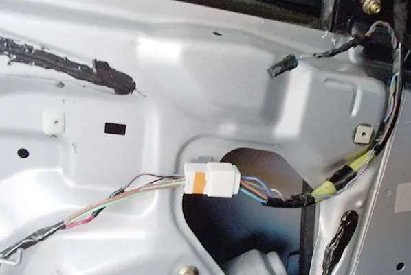

the geniuses at mazda decided to run the tweeter wires with the mirror harness, so that means you either have to buy the mirrors that HAS the wiring, or you can take the wires off the mirror pigtail harness and install them in your s*** that doesn't have it.... which is what I did....
you need to take off the door panel and then pull the pins with wires attached from the mirror connectors... you need a flat blade precision screw driver to lift up the plastic lock tabs to pull the metal pins out... I'm glad I got the pins from BOTH ends of the connectors because my door harness does NOT have the wiring for the tweeters! I had to run wires and splice them into the existing speaker wires
YES, you can just cut the wires and splice them in yourself and not having to deal with this connector s***... but I wanted to make everything factory plug and play for ease of removal/installation in the future
YES they're stock s*** 4Ω 25W tweeters, YES I know they "suck", YES it has a sorry excuse of a "crossover" via a 50V 1F capacitor
the fact is though, they have nice speaker grilles and I can cram whatever aftermarket s*** that'll fit in there I want later... no, you can't get just the speaker grilles themselves... you have to buy the WHOLE assembly, tweeter and all
I will give some notes so that people who want to sell this s*** or are pulling this s*** from a junk yard can get what they need... sellers doing this s*** can sell their s*** for more value

good decision on my part for taking the pins off BOTH ends of the mirror connector!

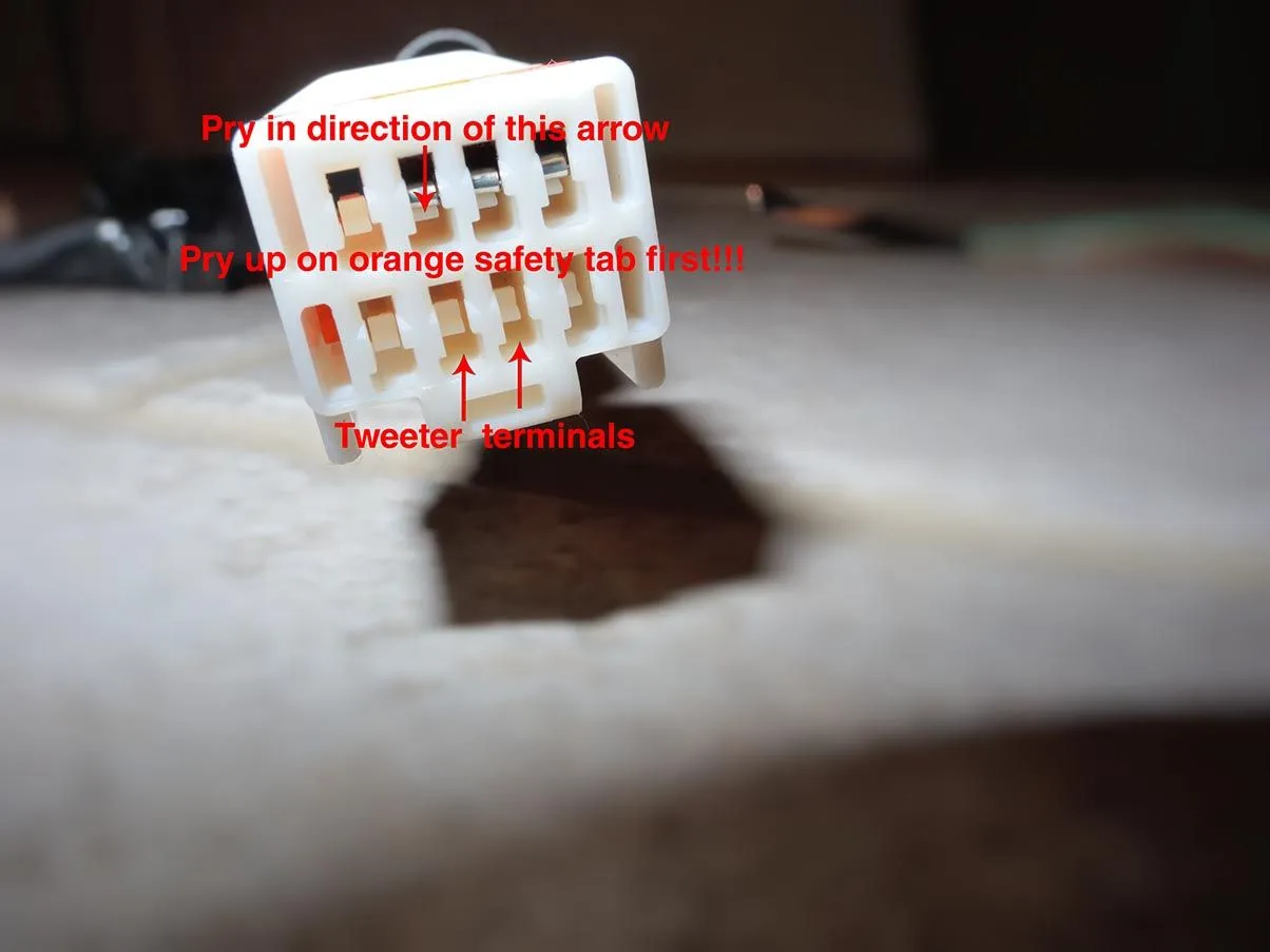

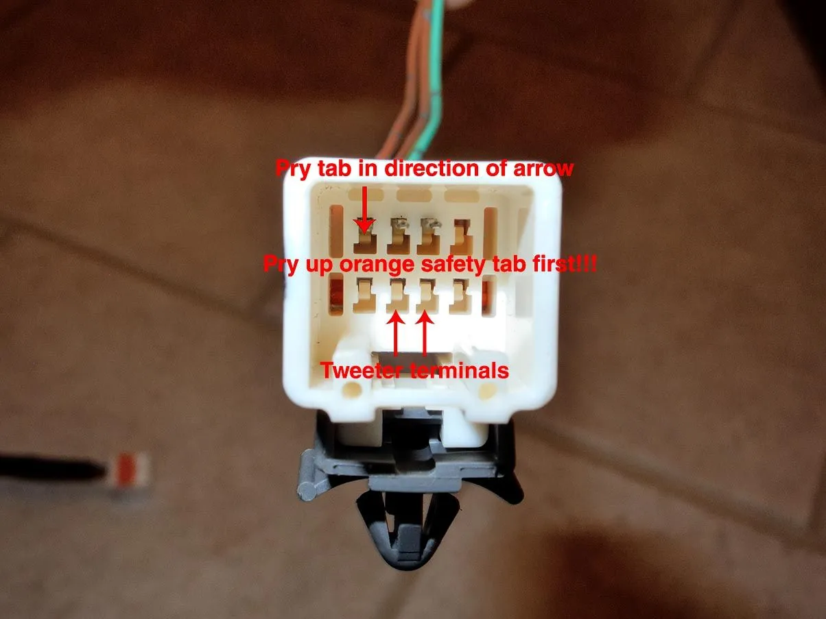

to pull the pins out, you need to "pick" on the little plastic lock tabs next to the pins... look carefully and you will see them... but before you can pull them out, you HAVE to pry and lift up the orange safety lock tab... it only goes up a little bit... do NOT waste time trying to take it off, IT WON'T COME OFF!

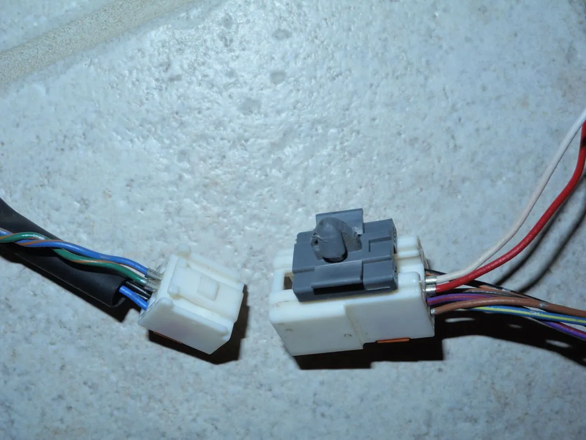

this is how the wires are run... you can also see the orange safety lock tab here... you need to lift that up to remove or insert the pins

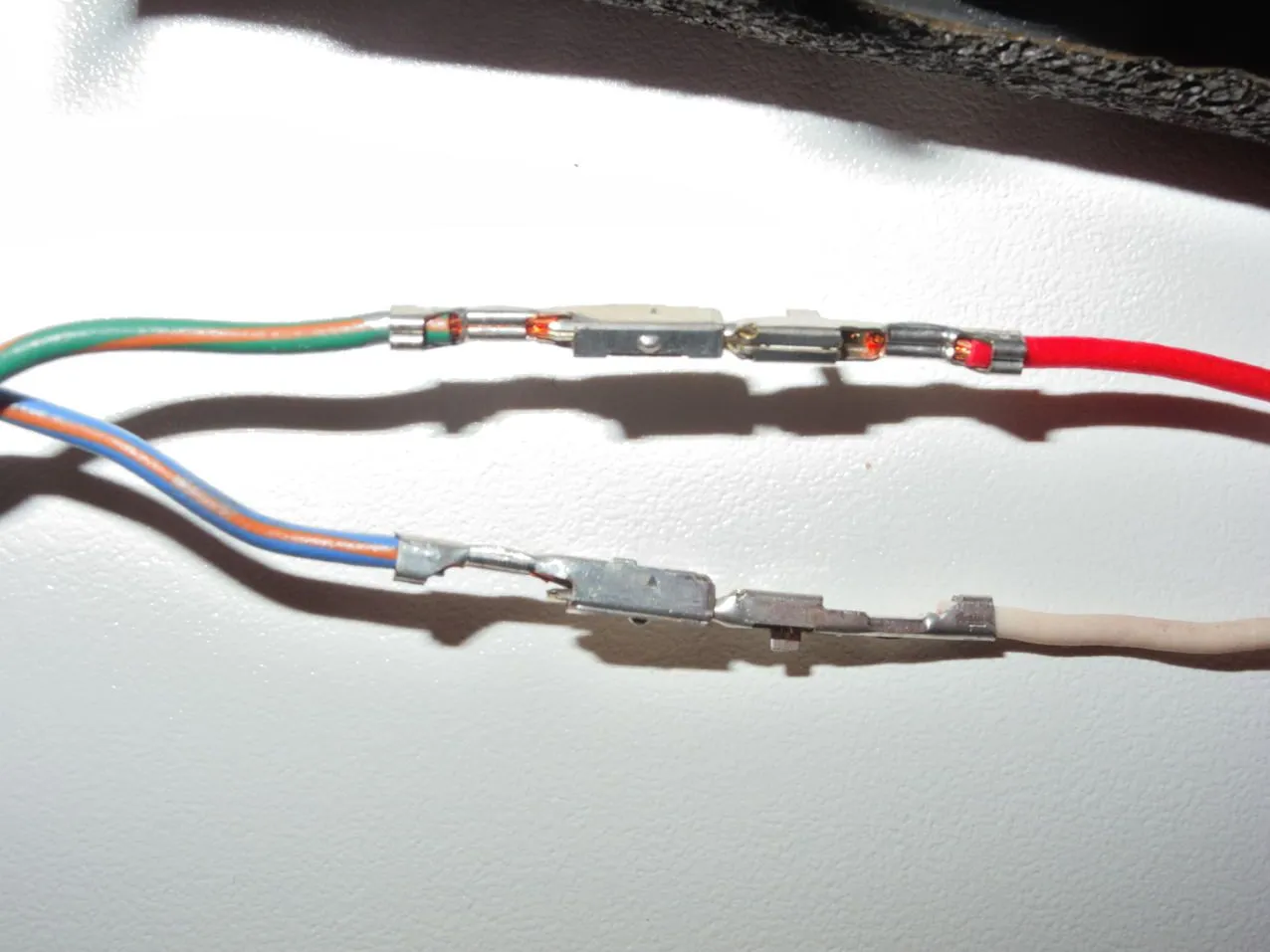

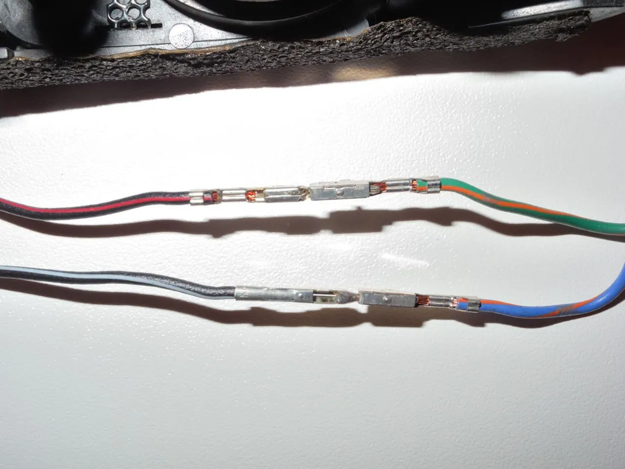

Here's the positions of where each color wire goes in the connectors:
LEFT side
attachment.php
RIGHT side
attachment.php

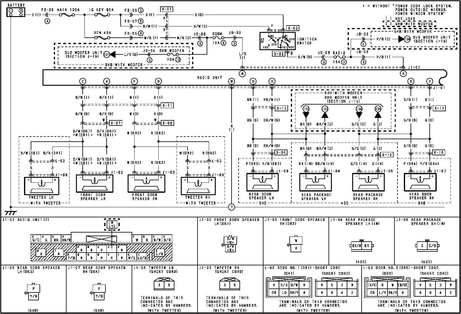

here's a 2003 wiring diagram in case someone needs it
the wire colors on the mirror pigtail portion are not shown but green/orange interfaces with black/red on the driver side and with red on the passenger side
and now obviously, blue/red on the pigtail interfaces with black/white on the driver side and with white on the passenger side
you can see how they match up in the 2nd post
