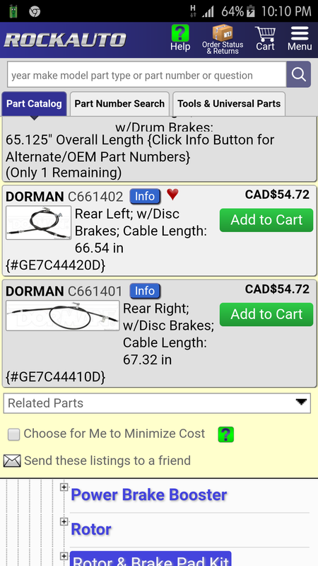

As far as I know, the problem with any rear brake replacement is getting new P-brake cables that are long enough and have the correct lugs on both ends of the cable.
I remember someone that got brake cables off of a pickup truck that fit, but I don't remember what brake set up he went with.
LankyKiwi had his cables custom built.
Either way, the cost of P-brake cables would be added to the cost of a brake upgrade.

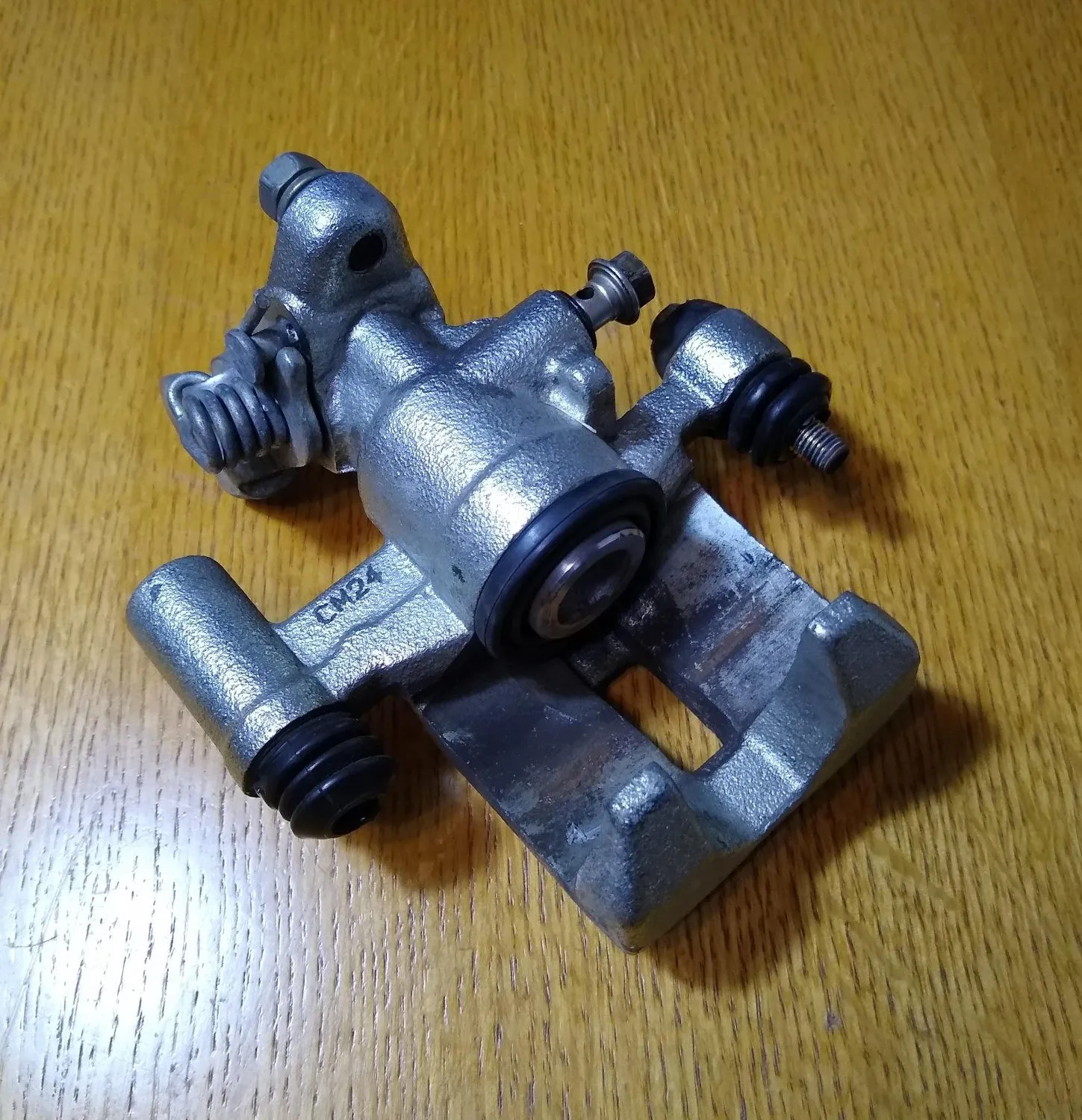

Found an almost new left rear caliper (right one was old and seized, didn't bother). Pulled it off to test. Adjustment screw turned no problem and moved piston, handbrake cable lever moved fine, bleeder nipple was not seized, no apparent leaks from torn seals etc.. Seemed good to me so I grabbed it, and they only wanted $15.
Now I am left wondering what to do about the right side. No other yards near me have any in good condition that I saw. eBay and car-part.com have them for like $60+ but I have no way of knowing condition. Hmmm.....

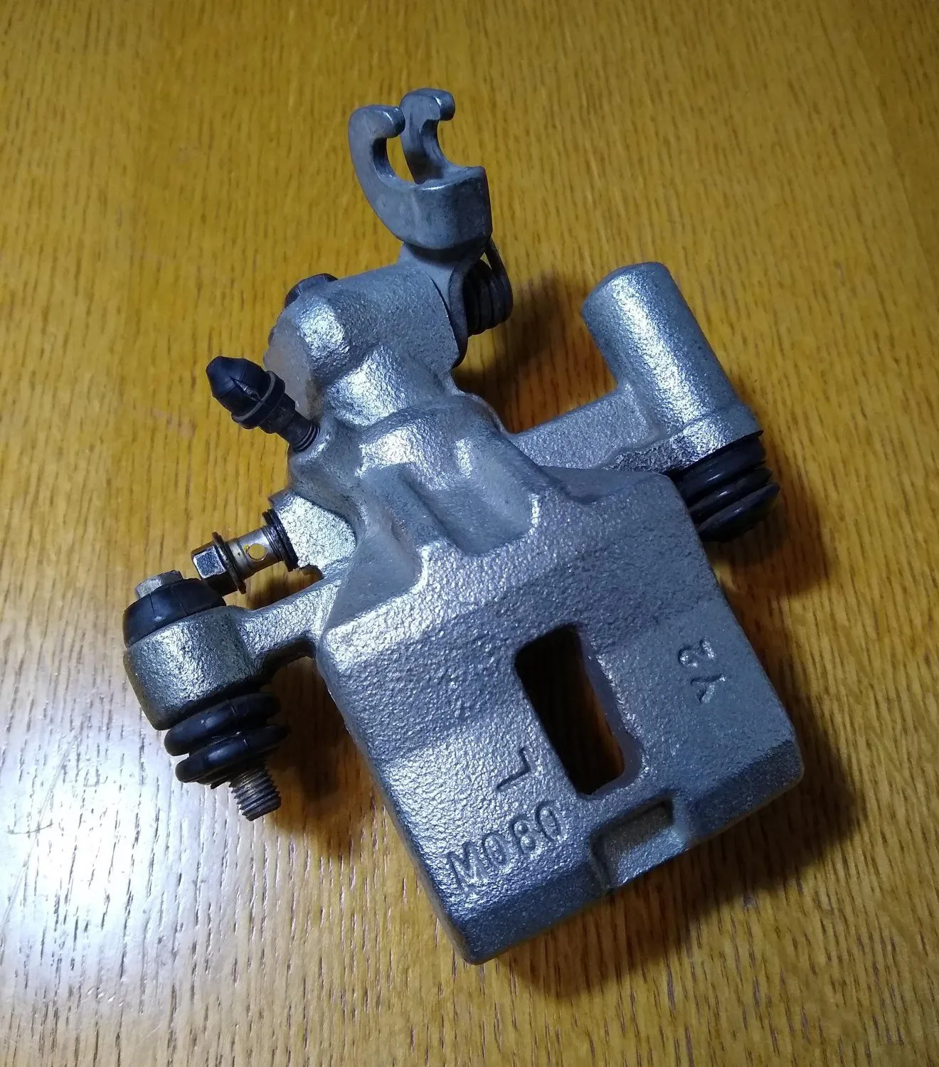

Still needed to find a left rear caliper and having not found anything at the local yards, I decided to jump the gun and buy a reman Centric left rear caliper off eBay. Total came out to ~$60 shipped with no core charge and 60 day free returns. If I have an issue, I'd rather deal with eBay for returns than RockAuto. Also bought some cheap Centric Posi-Quiet pads to install while I'm at it.
I've done brakes before but never a whole caliper. I'm confident I can get the caliper off, but I am not 100% sure on how to install the new caliper and do all of the adjustments and brake bleeding. I'll refer to the service manual and of course the obligatory ChrisFix video. I've heard that it's important to grease the slider pins, but I'm not sure where those are exactly and what purpose they serve. Any other suggestions or advice on the procedure overall are appreciated.
Hopefully I'll have a working parking brake for the first time by the end of this.

Calipers and pads installed and working. Slider pins greased. Parking brake working!
A few issues along the way - the new banjo bolt on the reman caliper was initially leaking like crazy for whatever reason. Swapped it out for the old bolt and that worked fine.
I've never bled brakes before but after I figured it out, it was no problem.
The old drivers side caliper parking brake hook was totally seized. When I replaced the caliper, the cable wasn't extending out fully, and It looks like the lever is half-engaged when the p-brake is off. I couldn't figure out how to let out some slack, and the other side was looking and working fine. I ended up just adjusting the Allen key to make sure that it wasn't constantly dragging, but as a result, I'm not sure if that side is fully engaging at all. Not the end of the world, but would like to resolve at some point.
Otherwise, this appears to be a finished job - thanks everyone for the help and tips!

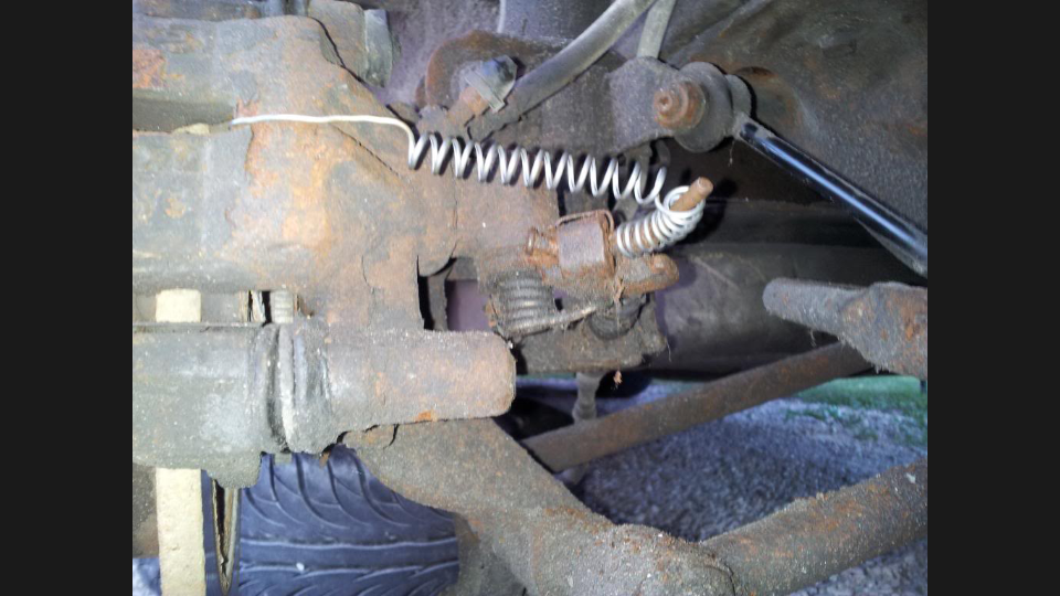

... When I replaced the caliper, the cable wasn't extending out fully, and It looks like the lever is half-engaged when the p-brake is off. I couldn't figure out how to let out some slack, and the other side was looking and working fine. I ended up just adjusting the Allen key to make sure that it wasn't constantly dragging, but as a result, I'm not sure if that side is fully engaging at all.
You probably have a seized P-Brake cable.
Mine was doing the same thing so I Jerry rigged a spring to the lever to pull on the cable.
My parts car came with new cables, so I swapped them out.
If the lever isn't fully rotating, then your brakes won't self adjust, then your brake pedal will start to push closer to the floor, and your P-brake handle will get more and more clicks until they stop grabbing.
You probably only have one caliper grabbing when you set the parking brake.
Your lever on your caliper may still self adjust (if it has enough movement) then it may not release and start to drag your brakes.

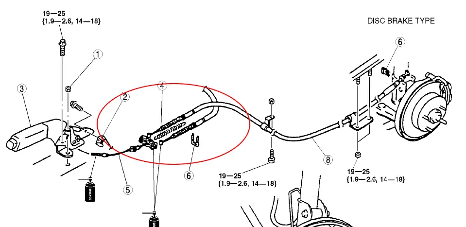

I've seen the diagram in the service manual which shows the mechanism responsible for splitting the one handbrake lever cable into the two individual cables for each side's caliper. However, when I traced the cables back towards the front of the car, they disappeared into the underbody and I don't know where that 'split' happens to be able to take a look for an issue.
Edit: For reference, this is the 'split' I'm talking about. 04-12-2 in the factory service manual.

If your passenger side p-brake is working properly, with full movement at the caliper, then the front and passenger cables, as well as the split, are probably working properly.
The split is located under the heat shield below the p-brake handle.
When the p-brake handle is released, the factory spring on the caliper is supposed to pull the cable fully out.
(the one circled in red.)
In my case (and probably yours too, ) the boot on the cable failed, water got in and rusted everything up inside the cable.
It wasn't fully seized, it was just binding enough that the factory spring didn't have enough tension to pull the wire out, so I added the extra spring to add enough pressure to pull the cable out.
My replacement cable moved so freely, that I didn't need the second spring anymore.
I'm pretty sure that you have the same problem that I had and a new p-brake cable will fix it.
You will have to remove the heat shield to access the "split" to disconnect the old cable from the "split".
You can put pliers or screwdriver on the lever connection point on the caliper to see if you can pull the cable out fully.
