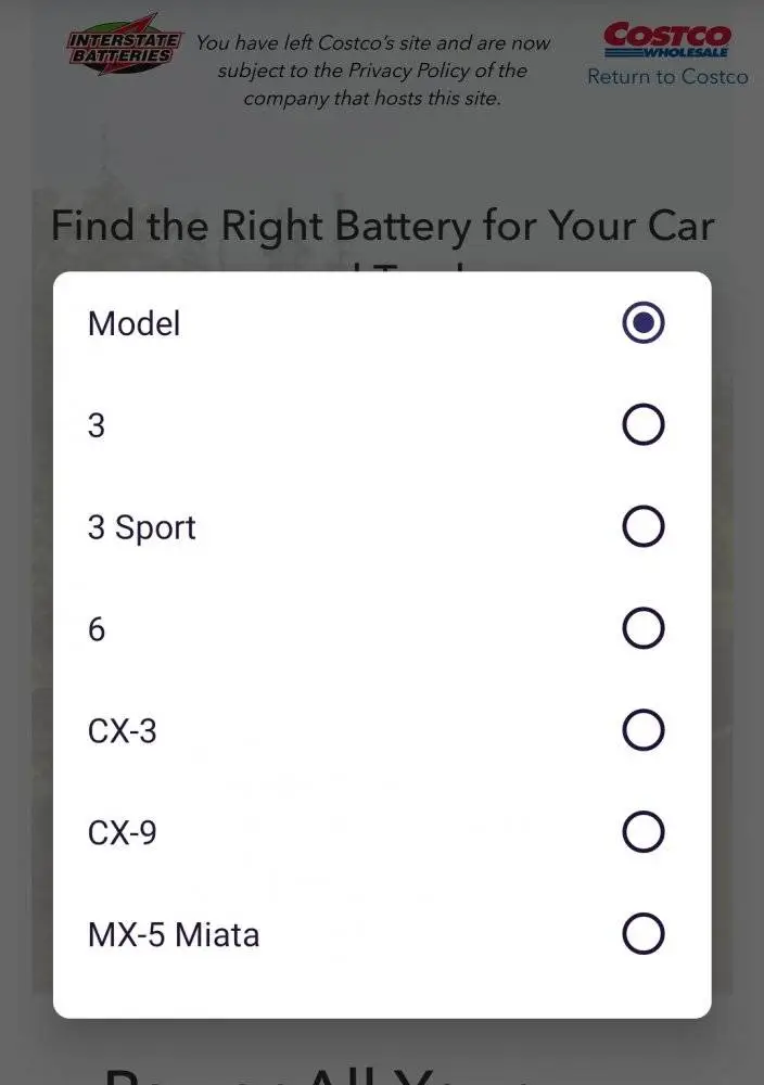

Soon I will need to replace factory battery on my '18 cx5.
Decided to go with interstate, however they don't have them listed for 2017 and 2018 models on their website.
No such problem for 2016 and 2019.
Do you think 2019 cx5 using different battery than 2018?

US Costco sells Interstatt batteries, and Interstate Group 35 is for all US gen-1 CX-5 and gen-2 CX-5’s without i-stop and I-ELOOP.
The price had been gone up $10, now $89, in May this year.

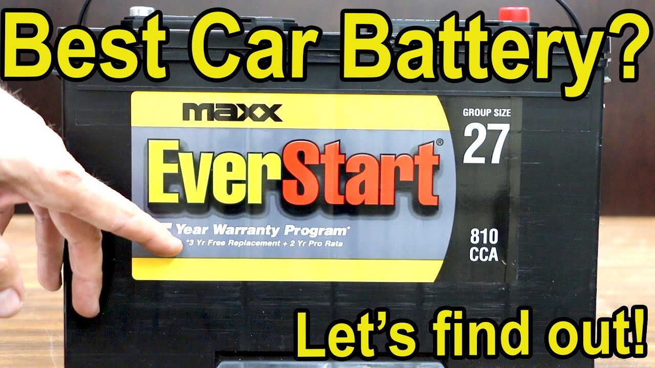

That's another endorsement of EverStart as a bang for the buck option. However, that's from 2019 (with lots of references to Johnson Controls) but more importantly he's testing apples against oranges--the EverStart is a Group 27, another is a Group 34, some I can't tell without rewinding and scrutinizing the whole video and maybe not even then.
Consumer Reports comes up with some widely differing results within the same make and model but different groups and North/South variations within the same model. For example, among the nine Everstart Maxx batteries CR tested, the scores range from 62 to 92 with the 35 North scoring that 92.
CR didn't even test Group 27 batteries at all as with the Maxx in this video. That leads me to believe that group is not very often used in cars of recent vintage. If so, it would be an odd choice for a comparison test.
