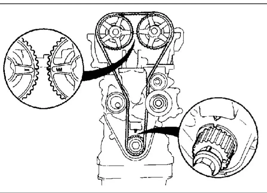

The two small notches have to face each other correct? And if that is correct if the crank was off would it cause 0 compression?
Yes it could.
Check and look for this...

Check your toothed ring while your in there...
They are glued to the crankshaft and can break free and slip or even fall off...
EDIT: They are glued to the crank pully.
It should look like this...
The keyway notch should be allinged properly with the missing tooth on the timing ring...

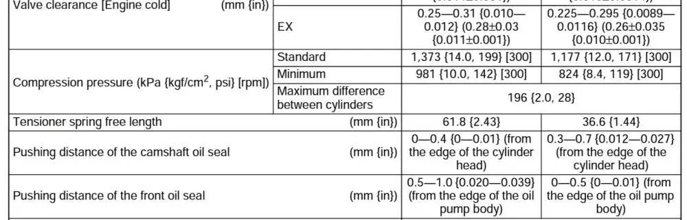

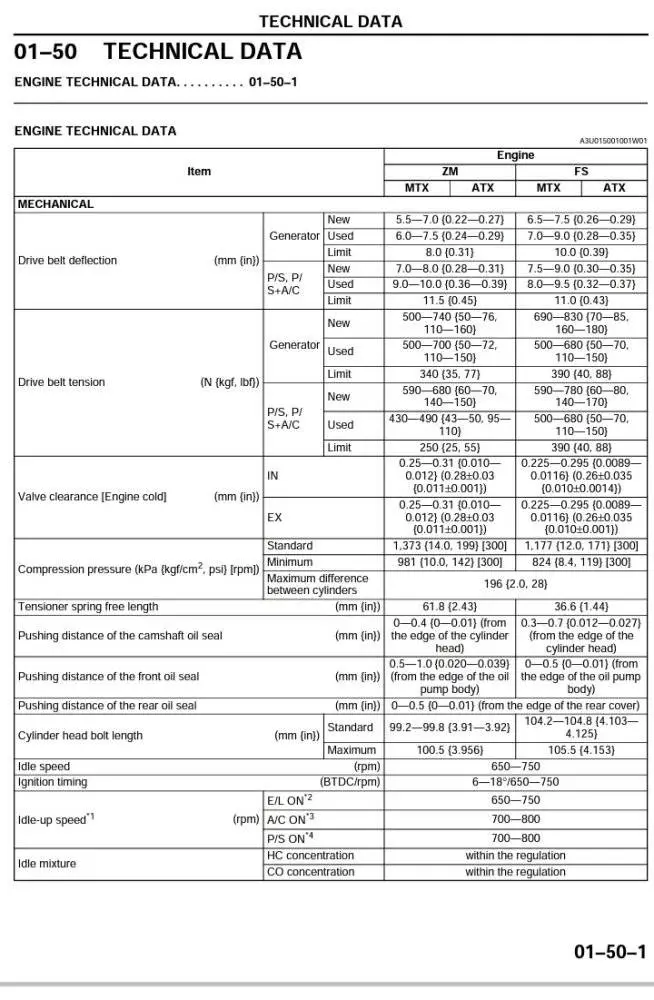

I had the same issue and got my head machined and just a couple minutes ago I finished everything and tried to turn it on but it didn’t, so I went ahead and tested for compression and mine got roughly 75-100 psi in all cylinders and I was looking through the manual to see which is the range it should be at but couldn’t find anything, do someone know what it should be?
