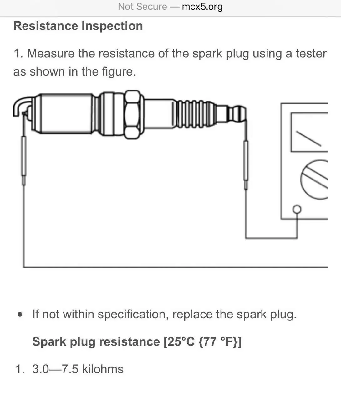

Other than the Ion sensing function by the spark plugs, I’d at least check the resistance on NGK plugs before the installation:
