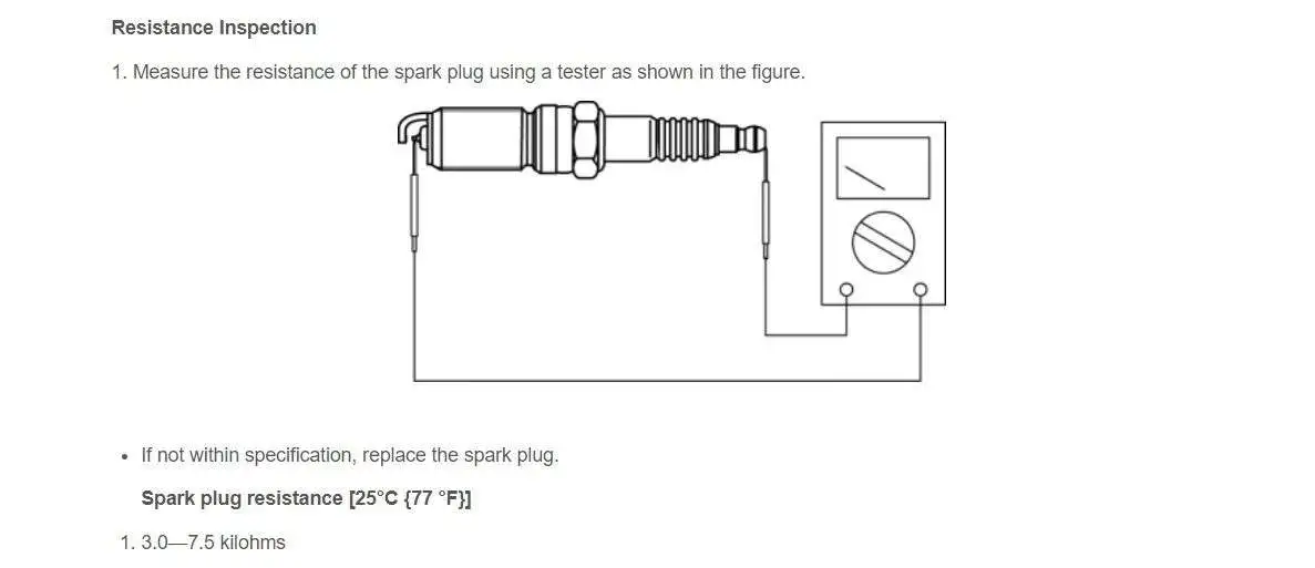

Until I know that non oem plug meets the workshop manual resistance of 3.0*7.5 kilohms) I wouldn't use a non OEM plug. The ecu uses the spark plug as primary knock sensor. If the resistance is out of spec then you could end up losing power and or mpg. I've been meaning to buy a cheap plug from Vatozone and test the resistance.

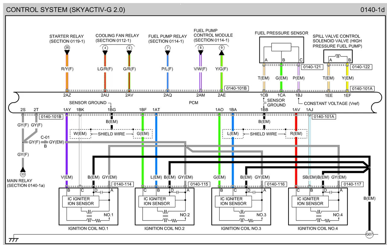

The color coding on that wiring diagram didn't make a lot of sense to me on some of the coils. I almost thought it was cylinder deactivation enabled. But I see that's a 2.0 L. Interesting to see the 2.5 l wiring diagram turbo and NA WDs
The coils are connected to +12V (grey, connects to "A" on each coil) and ground (black, "D") on two of the wires. The third wire is the trigger from the ECU (various colors, "B" I think) that tells the coil when to fire. The fourth wire is the sensing wire ("C", I think).

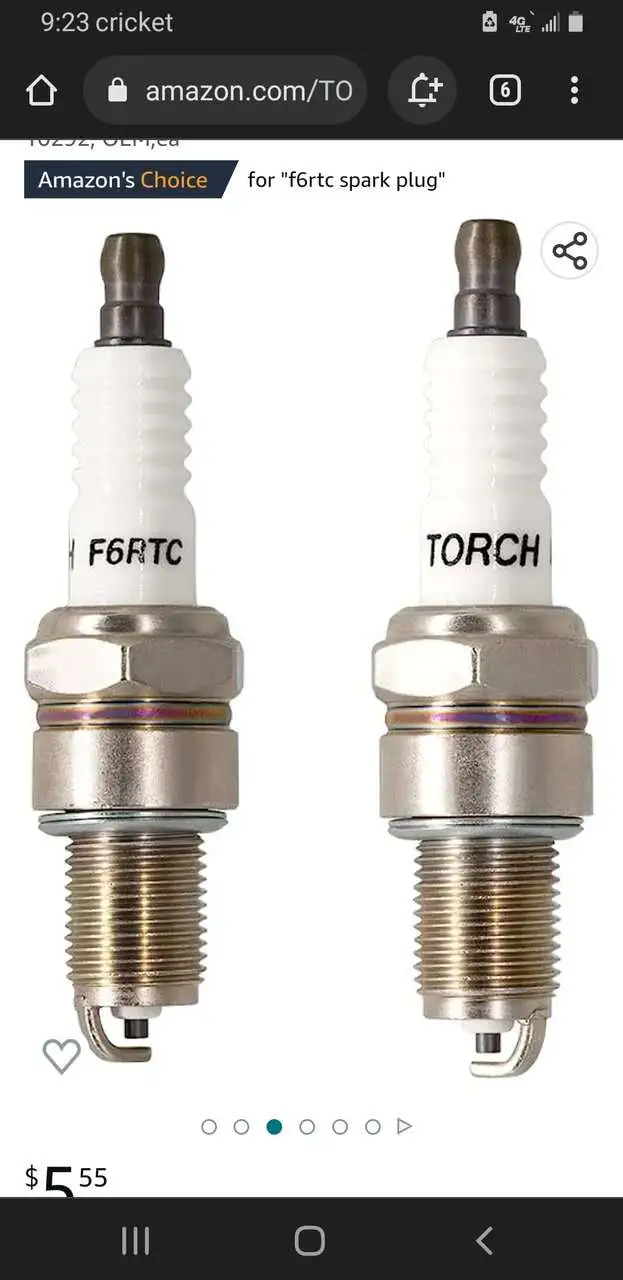

Watch out for this brand. I purchased a generator and had these in there but in the manual it gave you the NGK part number as the alternative spark plug. These went right into the garbage can
