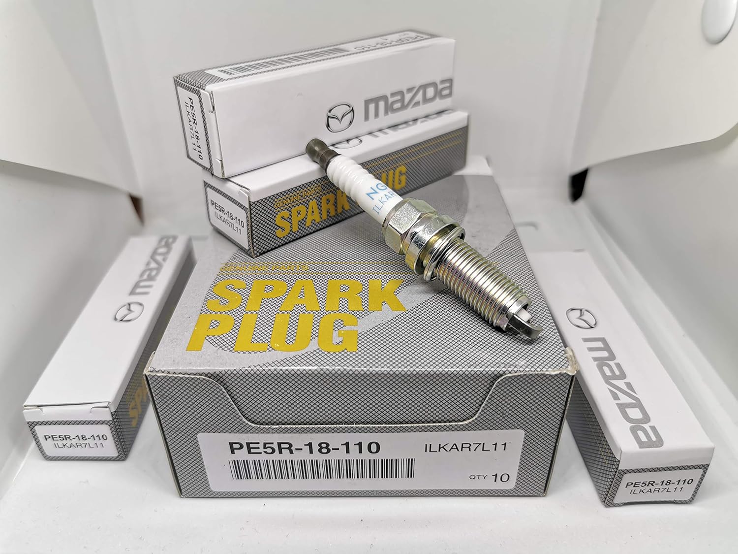

These are the official Mazda spark plugs ($120)

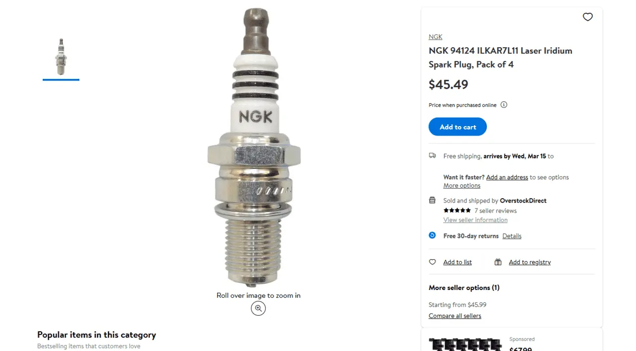

Here's HyFlyer's Walmart link ($45.49)

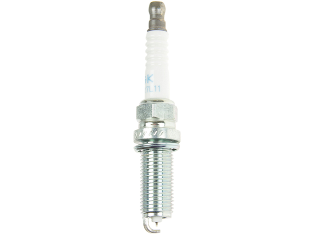

Same part number listed for both. Looks like the picture on the Walmart page is generic (and badly cropped), here's the actual NGK part.

Yep, the photo in the Walmart ad looks like a carnival fun house mirror spark plug picture lol. They were the correct number though.
They arrived via USPS a couple days later in a nice bubble pouch. Exactly the right plugs and unmolested. $45.49+ tax to my door (4-pack).
