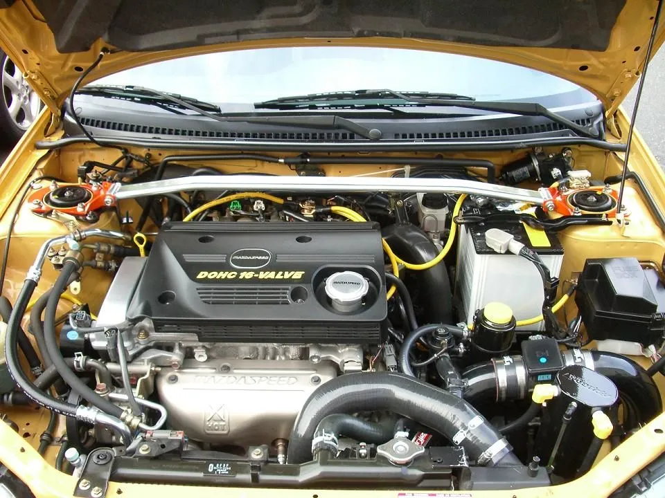

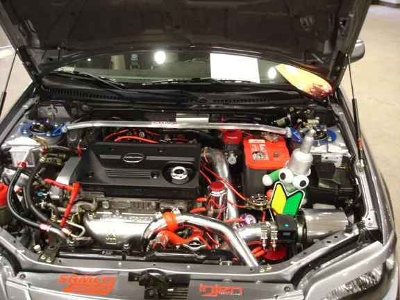

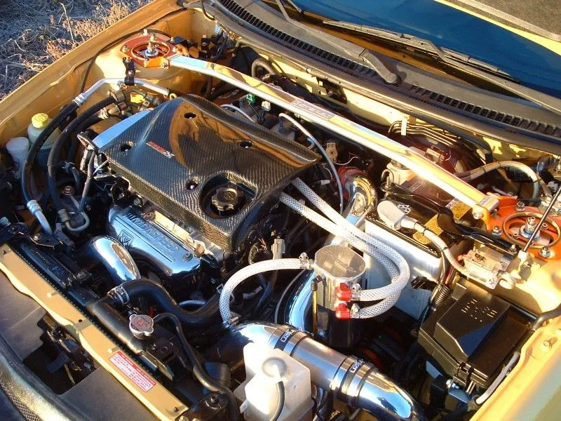

well, if you've put GT Spec under the car, doesn't it make sense to put it elsewhere? that's what i'd do...here are examples (mine, daedalus', and hawaiianmsp, he has a Cusco strut bar)

I have the corksport bar, which looks roughly the same as the gtspec one.
Here's what you have to do to get it to fit:
take a hammer to the bracket that holds the cruise control on to flatten the part that will be sandwiched underneath the strut tower brace. Do the same for the battery tie-down bracket. Bam, done.
Do I get a cookie?
lol I can take a pic of my strut towers to show you what I had to do.

i vote for a 3 point... i have one and it made a HUGE difference...
the gtspec would match the ksports... i had a gtspec on and its the exact same color as my ksports... but now that i have the cp, omg its night and day. such a wonderful bar. im considering making a few kinda like it...
