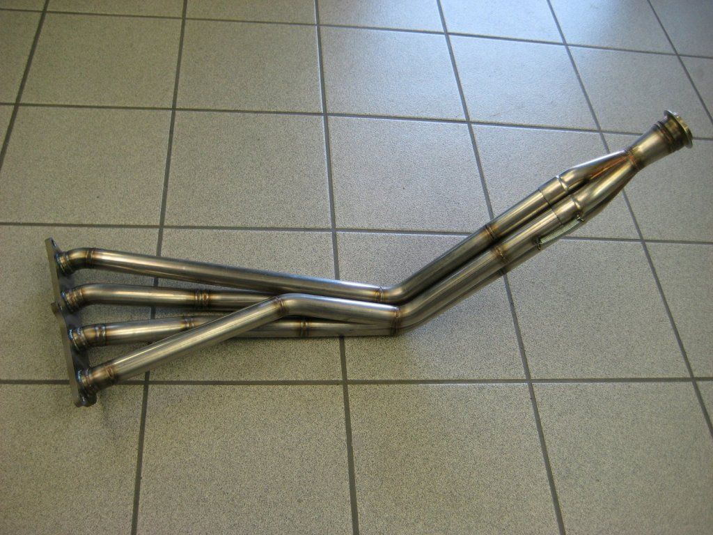

Header p0rn...
Big thanks to Laivins Race Cars, Burns Stainless, and Grassroots Motorsports Magazine
Also wanted to give a shout-out to Mike Allen at Mazda Motorsports who worked through the Mazda heirarchy to get us cam specs for the 2, which is a key ingredient to the X-Design process.
Headed to dyno later this week, courtesy of UpRev
Wow, that's a wicked looking header...looks awfully heavy though with all that piping (and expensive). Don't forget to post up the next dyno result! That muffler looks pretty sizeable, I wouldn't be suprised if it wasn't super loud. What's the outlet diameter on that header? Looks wide.
Exhaust is not that loud, at least to me. Can hardly tell it is running at idle. It will easily pass national sound regs for autocross, as the same setup was below 90db on my ST Civic. Limit is 100. Would be annoying on the street, though, as it has the usual drone at 3000. I'll fab up an out-the-back extension for off-season daily use. I will say that it sounds amazing from 4000 and up.
As for weight, the header is 18 gauge 304 stainless so it ends up being a couple lbs lighter than the OE catted manifold. Total system weight with the spun cat is a couple lbs less than the previous system (OE manifold->2.25" downpipe->Burns->dump).
Collector outlet is 2", transition to 2.25 happens at the exit of the cat. Would have used 2" all through, but we already had the muffler.
As for availability and cost, Andris will make more if people really want them, but it will be very expensive. This project was done for a GRM article to promote Burns' X-Design parametric header design process with third-party fabrication. So there were some deals made...but it still cost me a pretty penny. Laivins is a first-class race car fab shop, and you pay for that level of expertice.

That x-design program sounds pretty cool. Kinda makes me want to start over and get an engineering degree. Looks like we'll find out the limits of what these motors are capable of with just bolt-ons(albeit expensive ones).

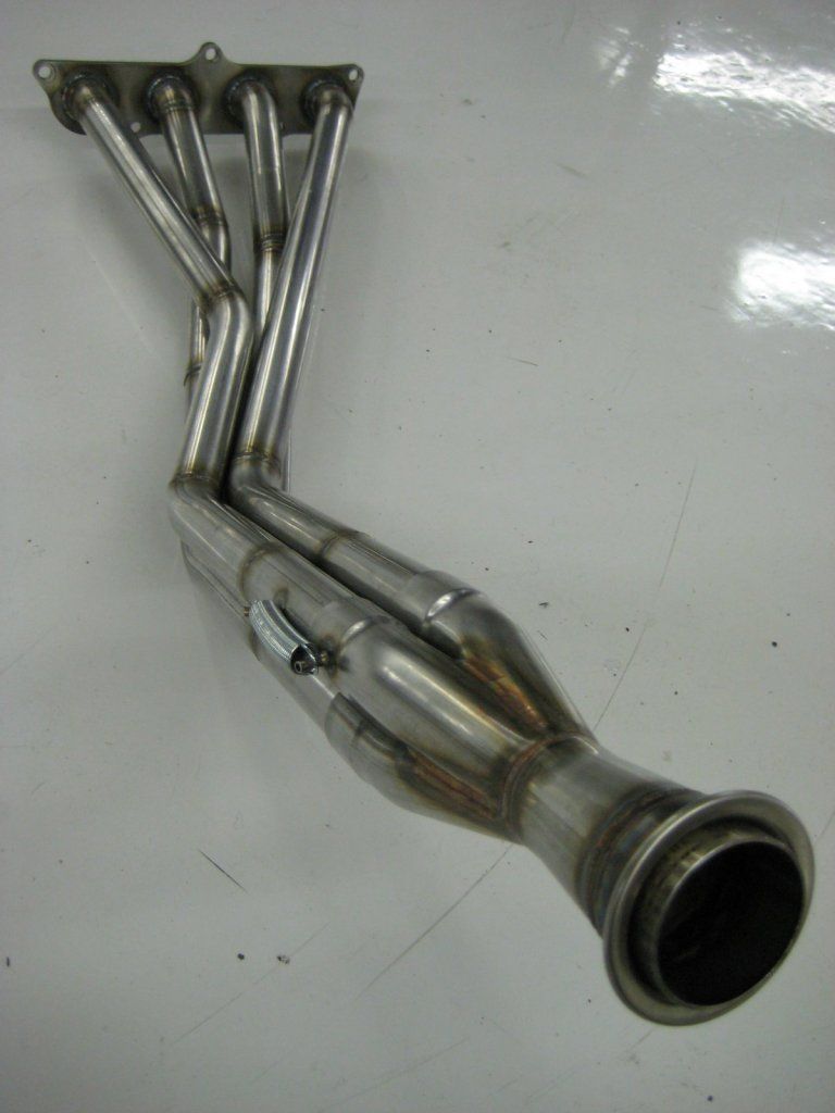

Header p0rn...
Now that is a nice piece of fab work! I really like how smooth the bends are... it is about as straight as it could be. I would love to be able to afford that quality, but I doubt I could justify the cost. I know you have to pay to play though! :D
Anyway, thanks for posting finished product, I am anxiously awaiting the full results with the parts installed and the tuning done. It will be great to see what the 2 is capable of power-wise with the bolt-ons you have.
