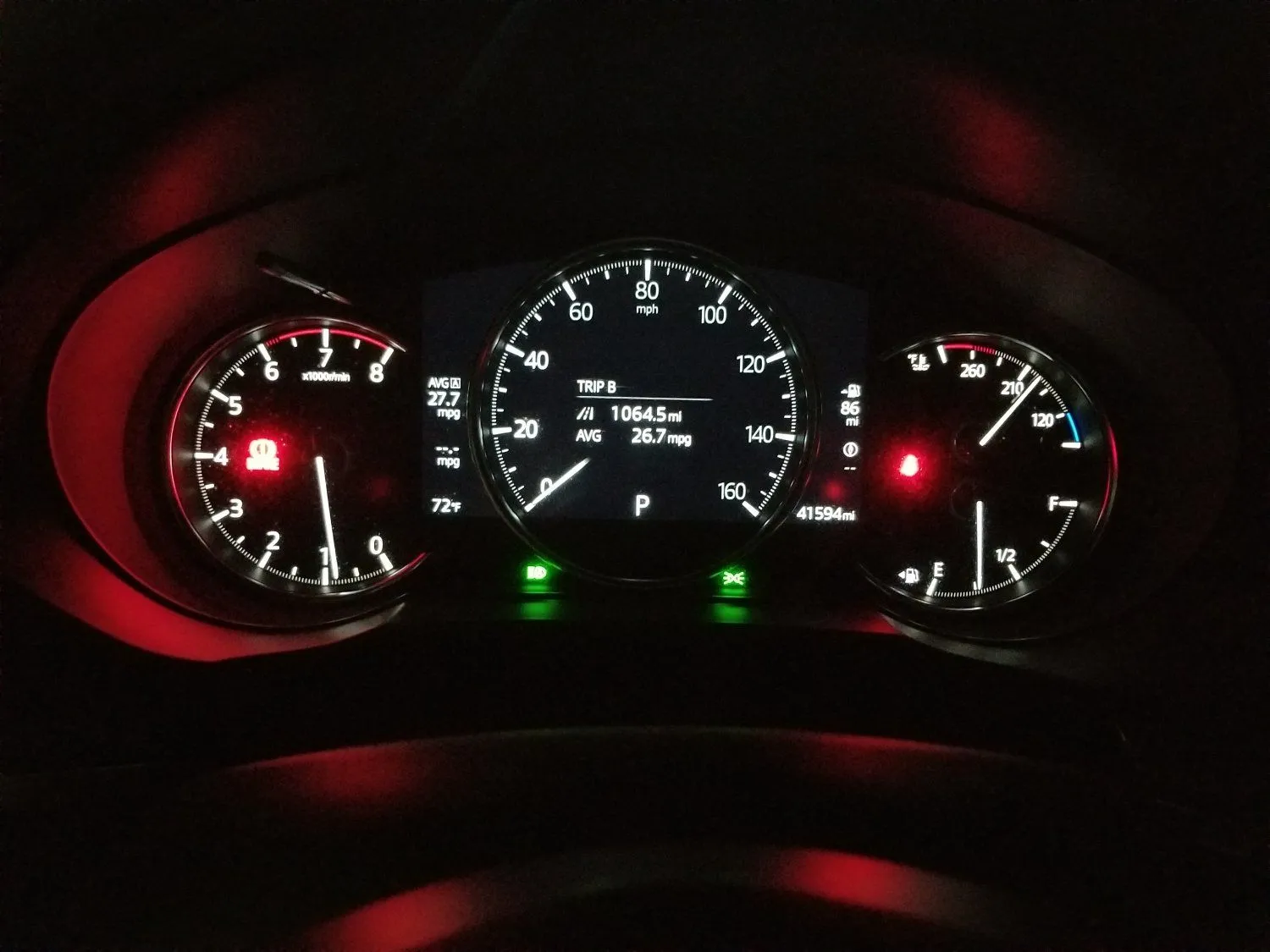

I now have 41,594 trouble free miles and am enjoying it just fine.
Here is lifetime mpg. My vehicle uses no oil that is measurable. I change it every 5k miles.
I have fewer miles but 26.7 is the exact same lifetime MPG that I have. I expect it to go higher over time. I did the same thing, did my first oil change at 1000 miles or so. I buy the exact same oil each time too, but it's really not necessary to do that. I get Castrol edge extended performance.
