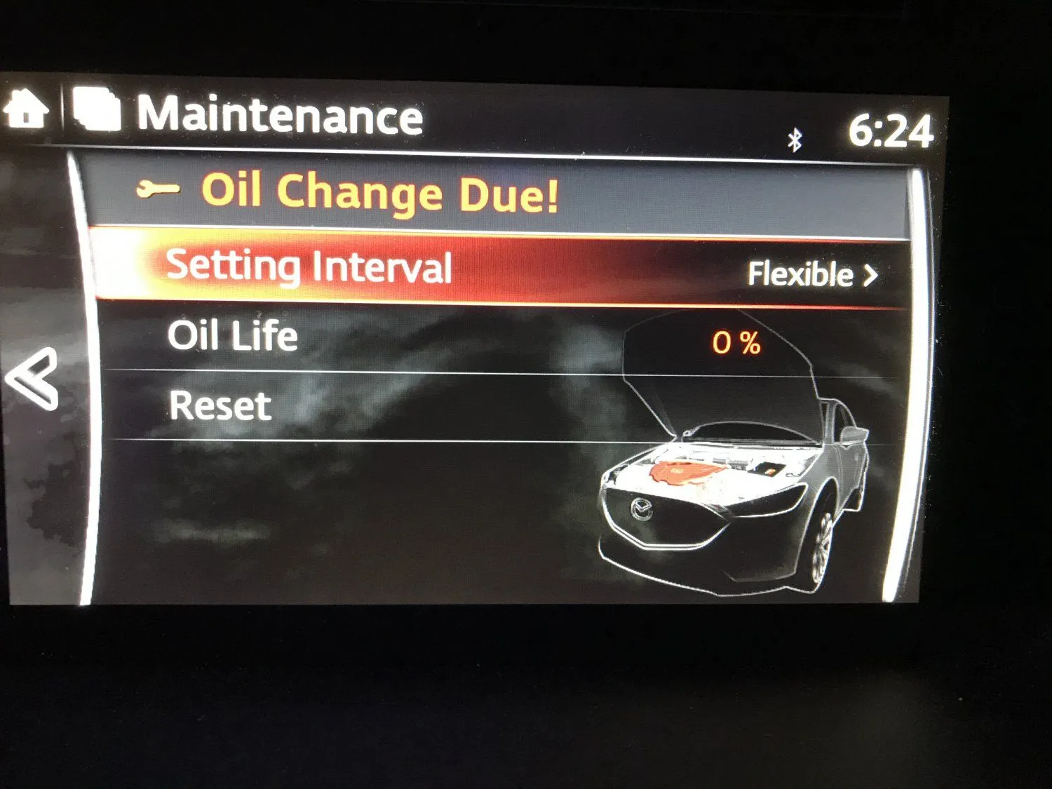

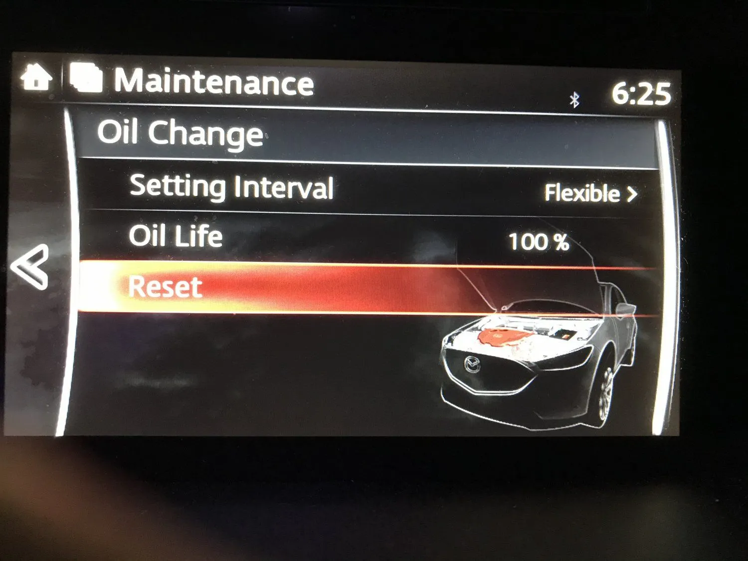

Here’s the action of Maintenance Monitor from my 2016 CX-5 where it uses % for oil life remaining which won’t get confused easily like using the mile on gen-2 CX-5. The oil change due notification came on for 2,728 miles but 12 months from the last oil change and reset.
Before my oil change:
After the oil change and reset:
