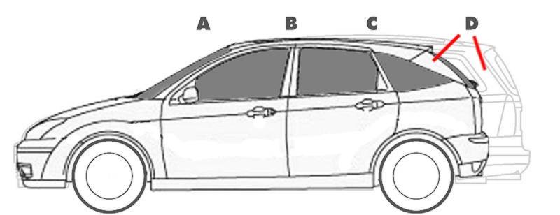

Might have to do that. I know what wires it is, and I know where they lead to. It's just... What to attach them too to make them work... If you've taken your old head unit out, you'll see that the rear view camera is nothing more then a yellow auxiliary plug you just unplug, and plug it back into your new HU. If you have to run a new line:
1. Route the line down under the dash near the heater/ cabin air filter on passenger side
2. Unscrew/ un bolt the panels on passenger side door
3. Peel away the door seal
4. Run the line up the passenger side A Pillar and thru the to the passenger side rear door
5. Run it past the B and C pillar
6. Go to the rear hatchback, and undo the clips holding the headliner up and just pull it down (A little to get your arm in there)
7. I just pushed all the wiring up into the headliner and pulled it out where you pulled the headliner down
8. Pull passenger side black "s" tube off (REMEMBER HOW YOU TOOK IT OFF/ tricky getting it back on)
9. Run the wire thru that and then undo the hatchback cover, be careful, I broke some clips. They are about $1.26 to replace.
10. Find your back up cam wiring and presto, tie it into the existing wiring
11. Put everything back together.
If you can't find their wiring because it's all shrink tubed up. Let me know and I'll go out and pull mine apart and tell you what wires you need to tap into. Best of luck.
