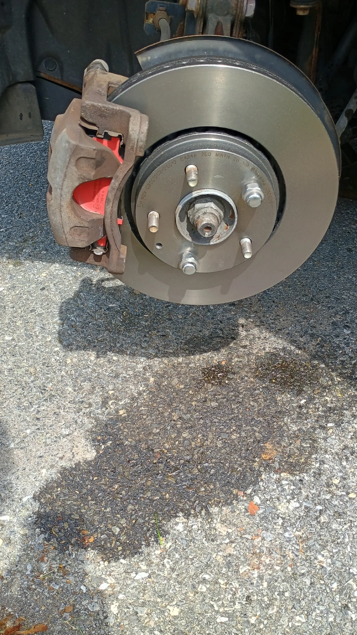

Akebono is a good choice. I just put on a set of Brembo pads and rotors, time will tell.
