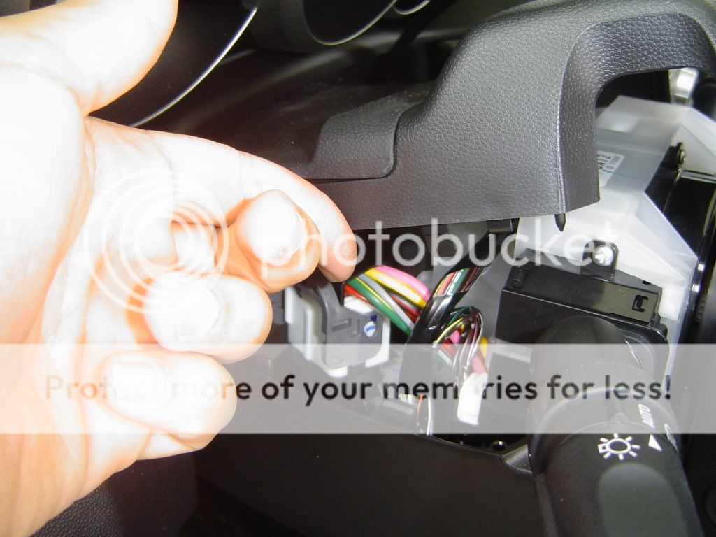

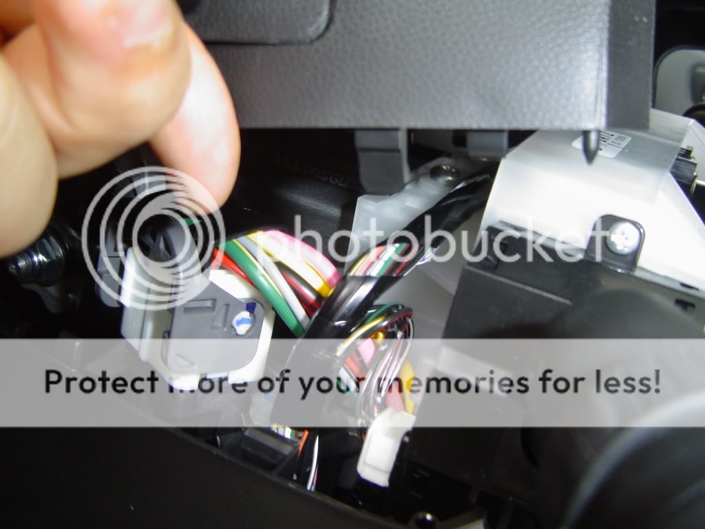

Are you talking about these really fat wires here?
those look like the right ones (the ones on my msp are fat as well), however, if thats directly to the key cylendar, id go after the connector (on the underside) if the wires are the same color on the bottom. the directions i beleive tell u to tap in after the connector.
terbow said:
those look like the right ones (the ones on my msp are fat as well), however, if thats directly to the key cylendar, id go after the connector (on the underside) if the wires are the same color on the bottom. the directions i believe tell u to tap in after the connector.
I'll trust you. They match up with the wire colors described below.
