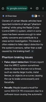

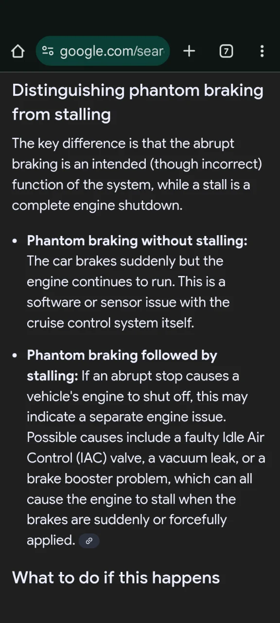

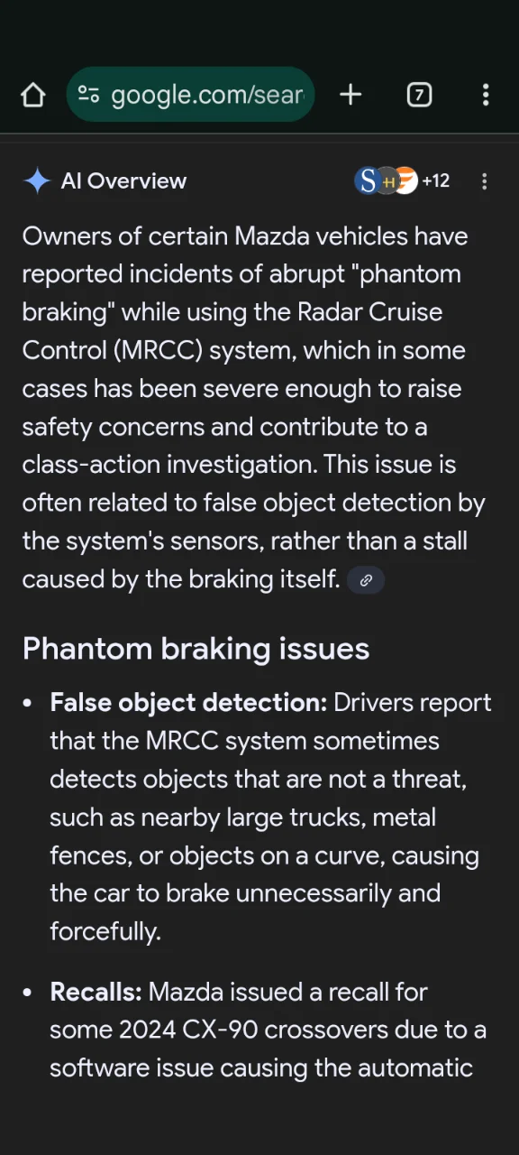

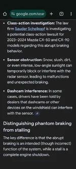

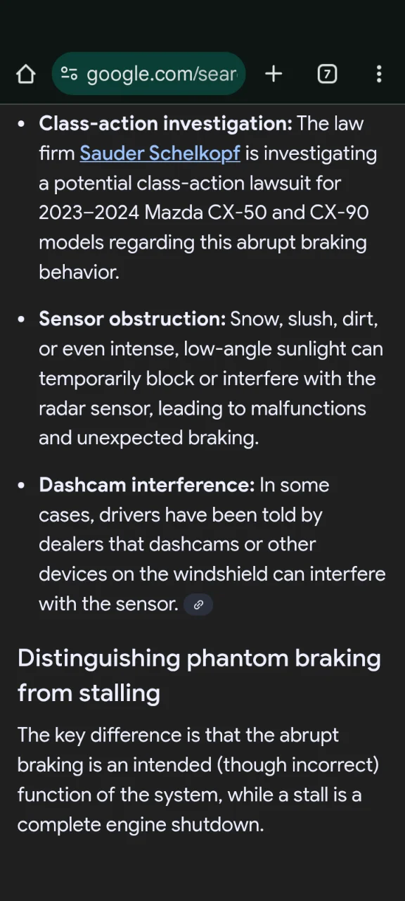

Before things went south I was reading up on how MRCC works and why braking can be abrupt in some instances (phantom braking). There are also reasons why engines stall after abrupt braking.
Search terms: Mazda "radar cruise control" braking stall
AI is tricky and does not return the same results if the terms are slightly different.
I have not experienced that in any car in the last 20 years (except for when a battery is bad) and it only occurs when sudden braking causes engine RPM to dive below idle speeds (car is nearly stopped). I don't think that's happening on the highway due to braking; the drive wheels are still turning the engine.
So the context is important here: I don't think that article you linked is talking about stalling at highway speeds.
