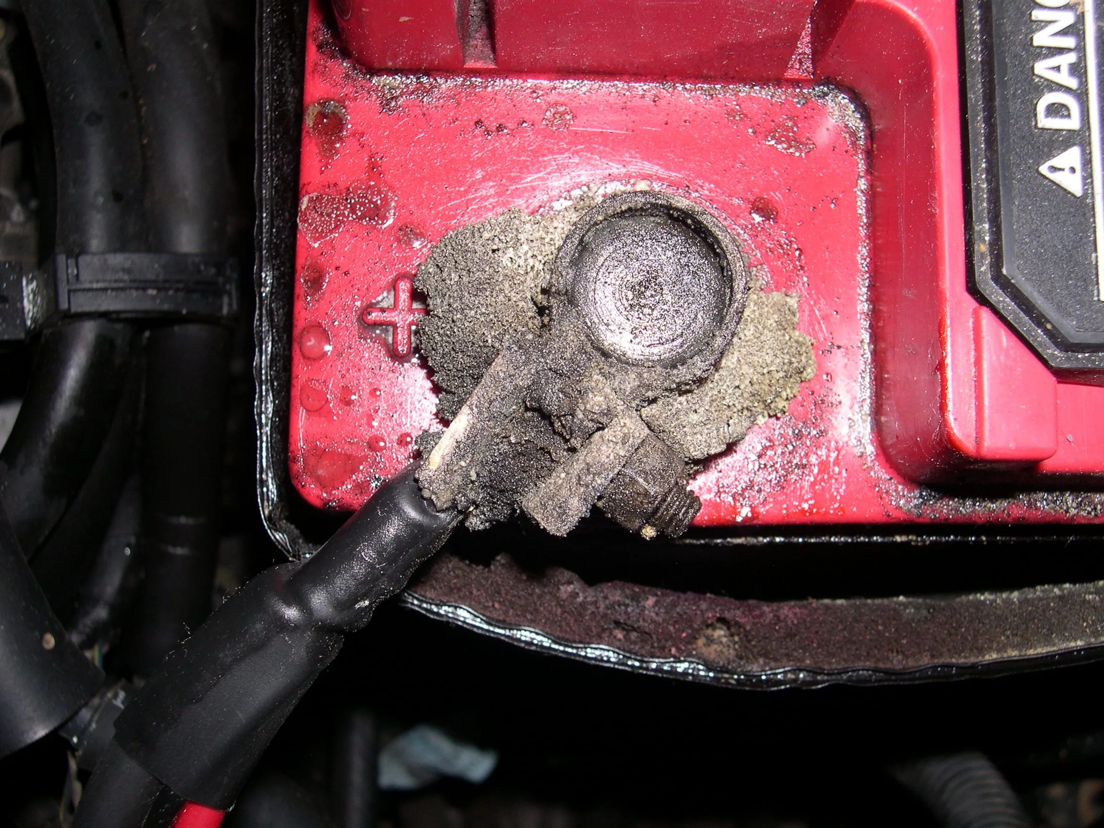

Here's a pic of the terminal. This is what it looks like 3 weeks after completely cleaning it and applying dielectric grease. The corrosion has completely covered the grease.
Any other ideas??

lead acid battery ftl.
Absorbed Glass Mat batteries seem to not corrode or fuzz up as fast in my experiences.

I am going to replace the battery as I think there must be some kind of small leak at the terminal, it just corrodes way way too fast.
Yes, buildup and corrosion is caused by a leak in the housing at the terminal. Nothing to do to stop or prevent, only prevent where the build up occurs. Build up is caused by dis-smiliar metals(lead post - metal cable)
Replace the battery and that should fix your issue. When you have your old battery out, and your battery cables disconnected, soak the battery ends in boiling water. The hotter the better. I use a coffee mug, throw it in the microwave for about 3-4mins and dunk my cable ends in the mug. This works great to remove the acid build up and not messy at all.
Try it and let me know how it goes.
Yeah, the more I think about it the more I think there has to be a slight leak at the terminal.

GET A NEW BATTERY.. If your getting bad corrosion on it after such a short time.. Its time for a new battery the only time i got bad corrosion on mine is when the battery was like several years old.
Any other ideas??

Hey u need to replace battery u have a positive terminal post cracked at base causing acid to leak ,no matter what u do it will still corrod ,only option for u is to replace battery ,& when u r fitting your terminals onto battery do not beat on ,both should just fit with ease .
