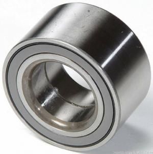

No... Your only option would be to get an entire knuckle with bearing and hub installed and that isn't really available... Knuckles are reused and really expensive (and don't come with everything installed).
The hub too is reused unless it's all bashed up... They aren't too expensive.
The bearing needs to be installed in the knuckle before the hub is installed in the bearing mostly so the pressure of pushing is on the outer race of the bearing...
If you were to push the bearing into the knuckle by pushing on the hub you would wreck the bearing. (even some machine shops have pushed it together wrong and wrecked the bearing).
Then the axle feeds through the hub and is bolted on...
So... Either way you can't avoid the labor and that can be a huge PITA..

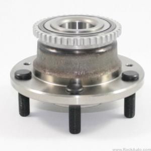

PS... This is the rear bearing/hub assembly and it does come with the bearing and toothed ring preinstalled.

1. There is no assembly available.
2. Once you have the knuckle removed, you pull the snap ring, press out the hub, then press the bearing out by pushing on the exposed inner race. You press the new bearing in using the outer race only, and you install the hub by pushing on the inner race. It'll make more sense when you get it apart. After you get it apart, there will be half of the split inner race still on the hub, which can either be cut off with a dremel, or pressed off with a bearing splitter. There is a thread on here that explains the bearing seal situation.

The bearings are not directional, same part for both sides. Direction doesn't matter.
I went with Timken bearings. Autozone carries them. I believe Orielly's and Advance carry National, which are pretty good as well. Rockauto has them all beat price wise though.
