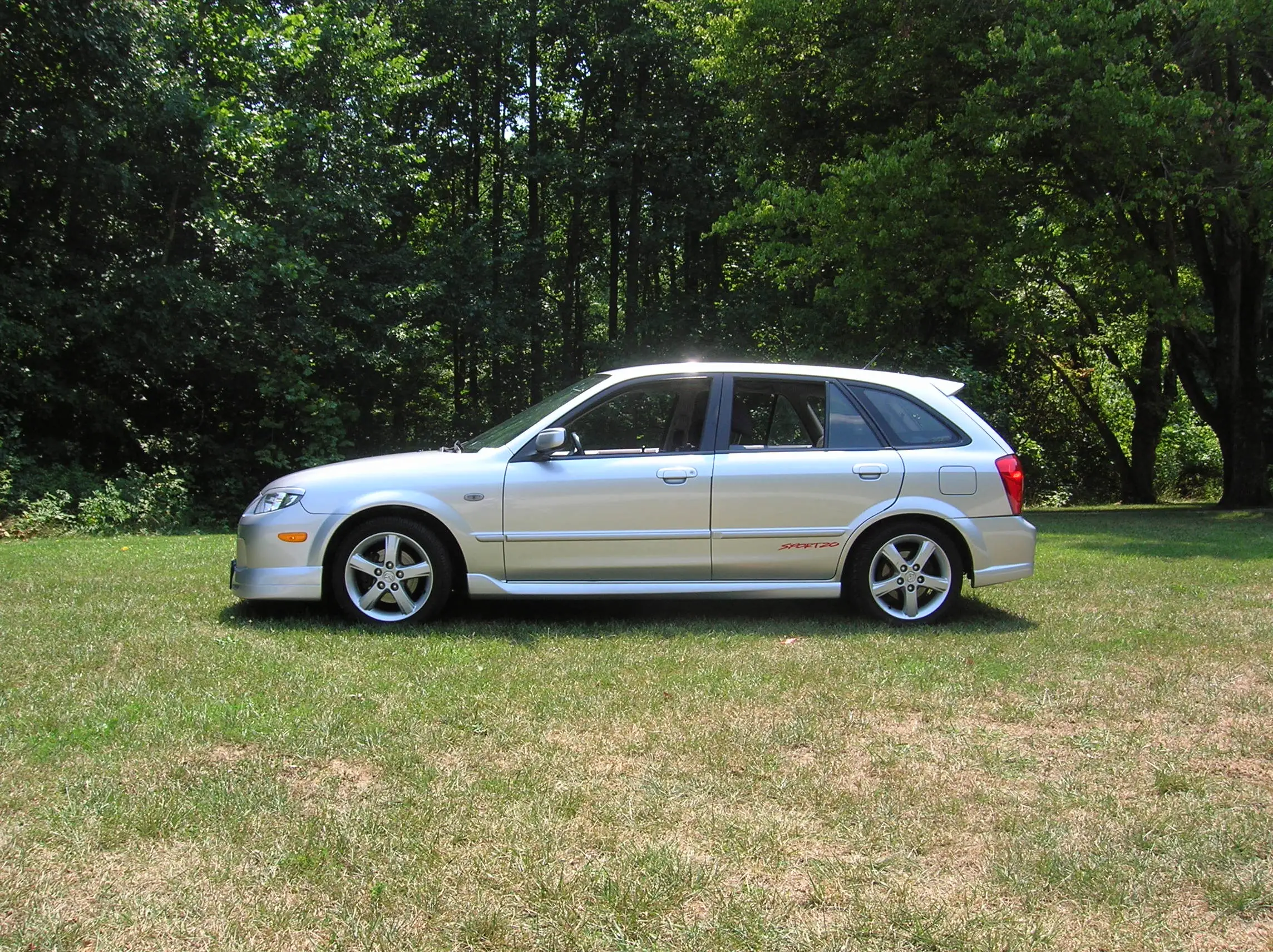

This is my car with Hankook Ventus 205/40/16 tires. Great tires but you do feel the road a bit more.
