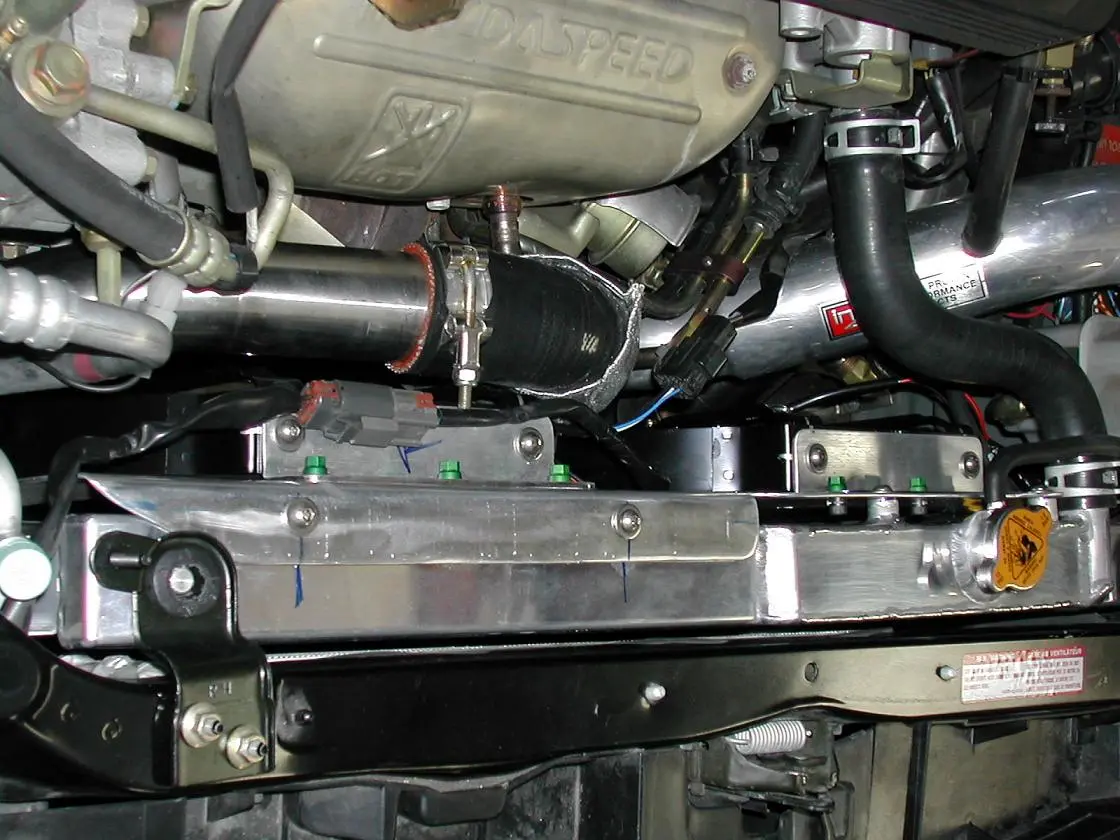

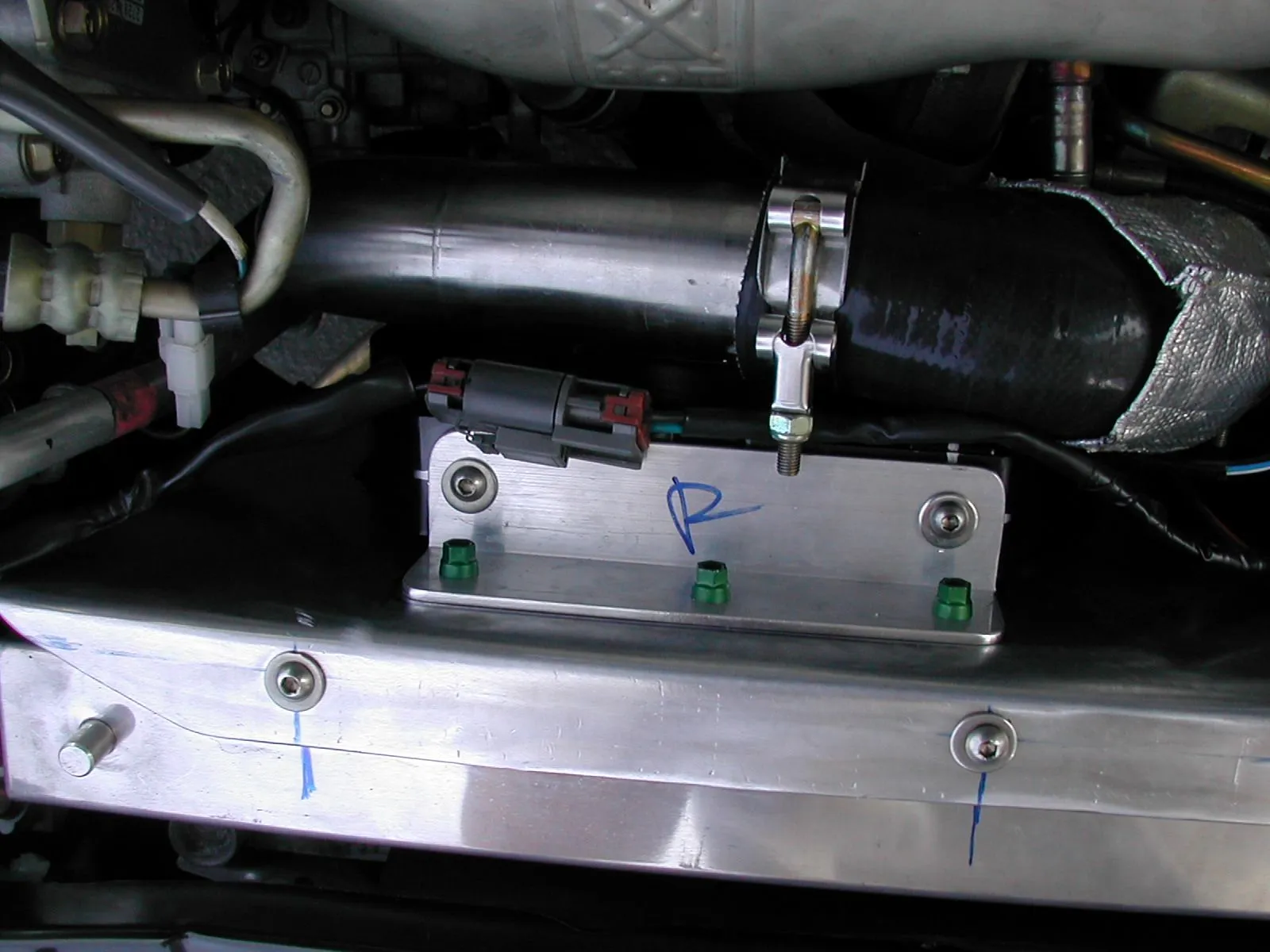

maybe you need something like this, let me know i can work a deal for you

I'm accually needing something a lot slimmer due to the turbo system I have in my MP3. I saw the fans that come with the HiBoost kits, and they fasten the fans to the radiator via anchors. Something more like that...Juan?

I had a little trouble seeing what was going on in the pics the other Chris posted. Are those the stock fans mounted differently or how is that set up?

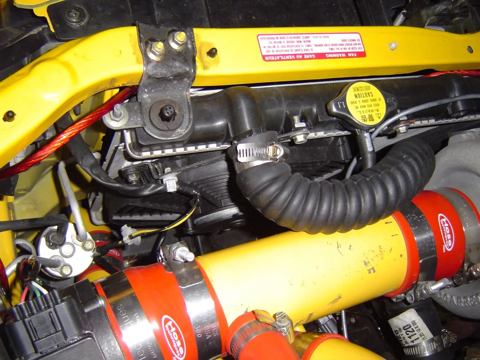

Get some spal's dude. I have the same mani as you and I know how close it is. I also have the big T3/T4 and the spal is it, that thing moves some air. . So much that when I had the 80mm mass air on, I had to make something to block the flow around it because it was messing with my mixture by blowing all that hot air on it and into the MAF. I covers the entire area of the radiator that the A/C fan does not. I think I posted a pic before, but here is a couple.

those are some FAL fans that the guy already had , we just fabbed up a shroud and put it on a PWR P5 rad.
