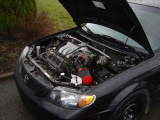

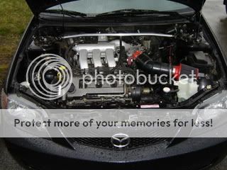

The KL protege of TwoFastRacing.

A while back I was in Contact with DOMSPUN(has performed a few swaps). This is basically what is needed. The most important thing is that Mechanically its a direct swap. By direct I mean No custom parts, well almost none. Obviously beefed up parts may be in order, is 250whp is the goal in mind.
Also keep in mind this is the basic List of things needed. He didnt go into complete detail as the list was in french and at the time he did not feel like translating.
sorry to dredge this up again
but can you please confirm that it is a direct swap i.e. the engine mounts will bolt up?
Bino wants to know... and i'm sure everyone else does too :)
This is the PM I that I got from him. I've even tried contacting him a in the past couple of day to no avail. There a french canadian forum I see him on but I dont speak the language unfortunatly. So this is the only conformation as of now. I've even tried contacting TwoFastRacing, Havent heard back yet. So I'm still trying to conform all this.

Hello, What you need for a complete swap of KLZE in your protege is:
the engine KLZE
trany from the original KLZE or a trany of 626 93-97
you gonna need complete axle of the 626 right & left 93-97
normally we put a new distributor $450.00
the wiring harness of the KL
wiring diagram of the protege
Radiator of 626
thats it
From that statment, I am gathering that the answer to everyones' question is, YES. The KL is a direct swap with the FS.
