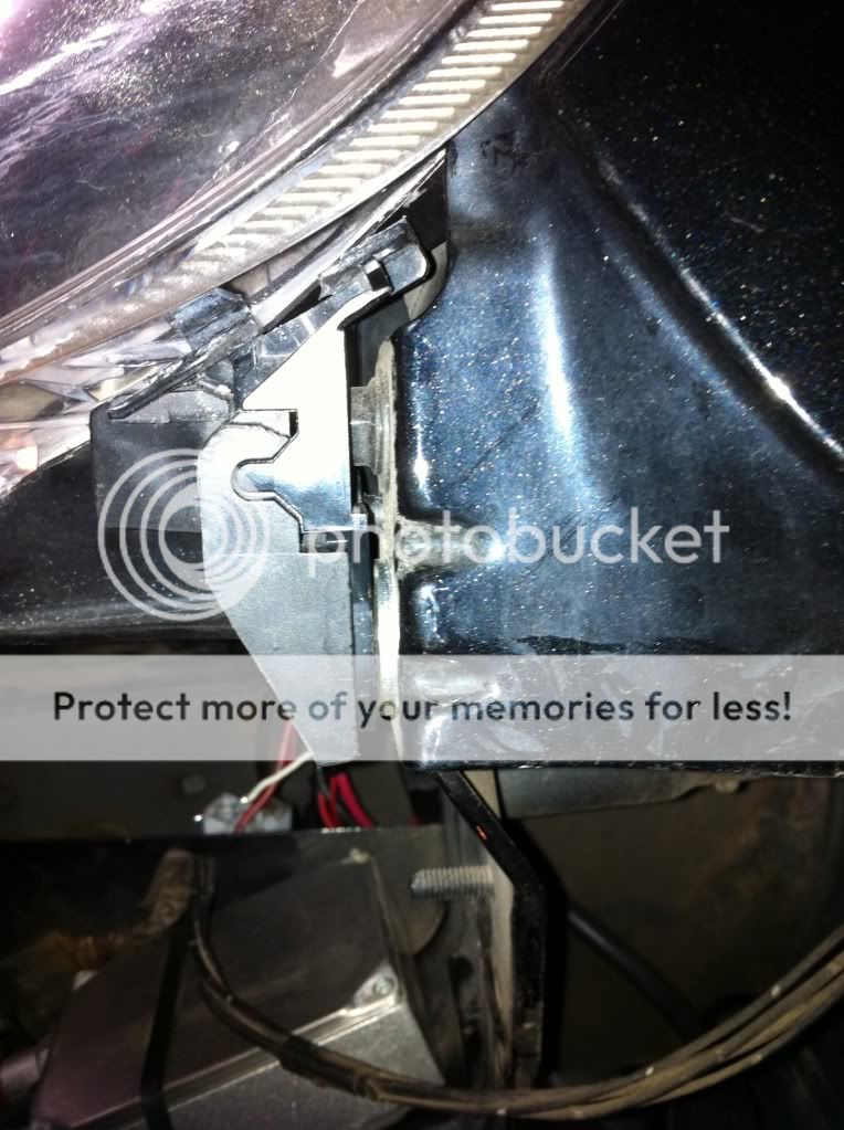

i zip cut a washer and slide it behing the headlights to get the right alignment of the projectors since they were aiming straight to the ground.
after finetune with the 10mm behind the light , its perfect.

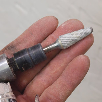

Nice, I have a spare lower intake manifold. How long did it take you to do it? Did you use cutting wheels?
if you look in the first page i think u can see that i used a air saw. i cut all the big chunks and then i used
with a longer cutting tool and some rustcheck oil so the cutter dosnt get all plugged up. after sand it to make it smooth as desired
