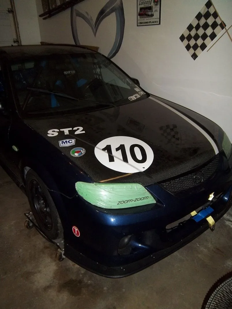

LOL, I feel like I owe you. I ordered up your Ksport combo, and I am looking forward to using your suspension setup tips. And now I tried to copy your air dam.
attachment.php
Coming along nicely. If you have any questions just let me know.
By the way, if you got the same spring rates I was using last year, be ready for some oversteer!
