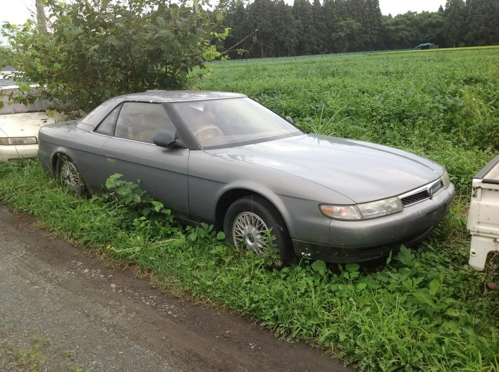

So, I'm getting a second Cosmo. Found this one in a junkyard. The owner wants a ridiculously low price for the car and I couldn't resist. Engine needs to be rebuilt, but I'm okay with that. Since I'm getting into the engine bay, what do you guys recommend me taking care of before the engine gets put back in? Obviously, I'm going to clean up the engine bay. I'm ready to fix everything and anything.

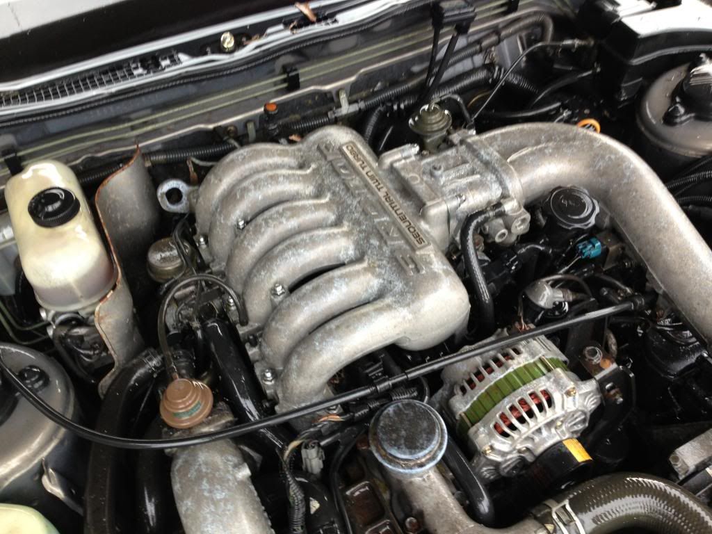

While the engine is out I would look into the following...
1. Wiring to the ABS unit. With the amount of heat that the 20B produces, you should re-run the wires which go across the firewall on the turbo side.
2. Replace ignition circuit. Again, heat related.
3. Engine mounts & gearbox mounts.
4. Degrease & clean!

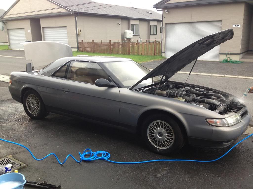

Picked up the car yesterday, and leaned the hell out of it. The interior wasn't too bad. I had to really clean the door/trunk seals and the engine bay was FULL of spiders. Overall, the car is in really good shape. Today, I'm going to try and put it on jack stands so I can deal with the under body and see what all I need to order. I'm also going to break out the tooth brush and scrub every crevice. The engine code is A790

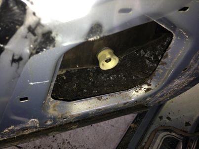

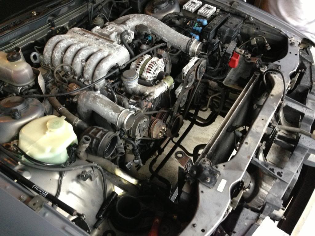

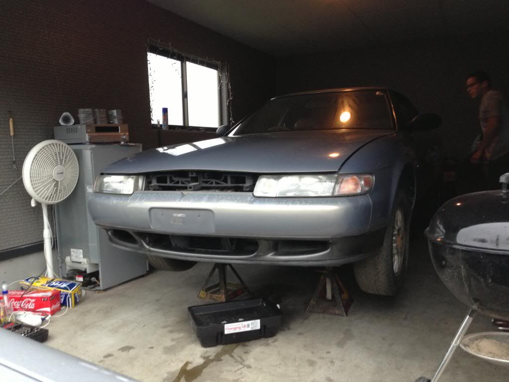

Jacked the car up and got some work done. After the car was raised, I took out the airbox, radiator, and smaller miscellaneous things. Next is removing the a/c and p/s from the engine and moving those out of the way. Got a better look of the under body. Minimal rust. Nothing a wire wheel can't break up.

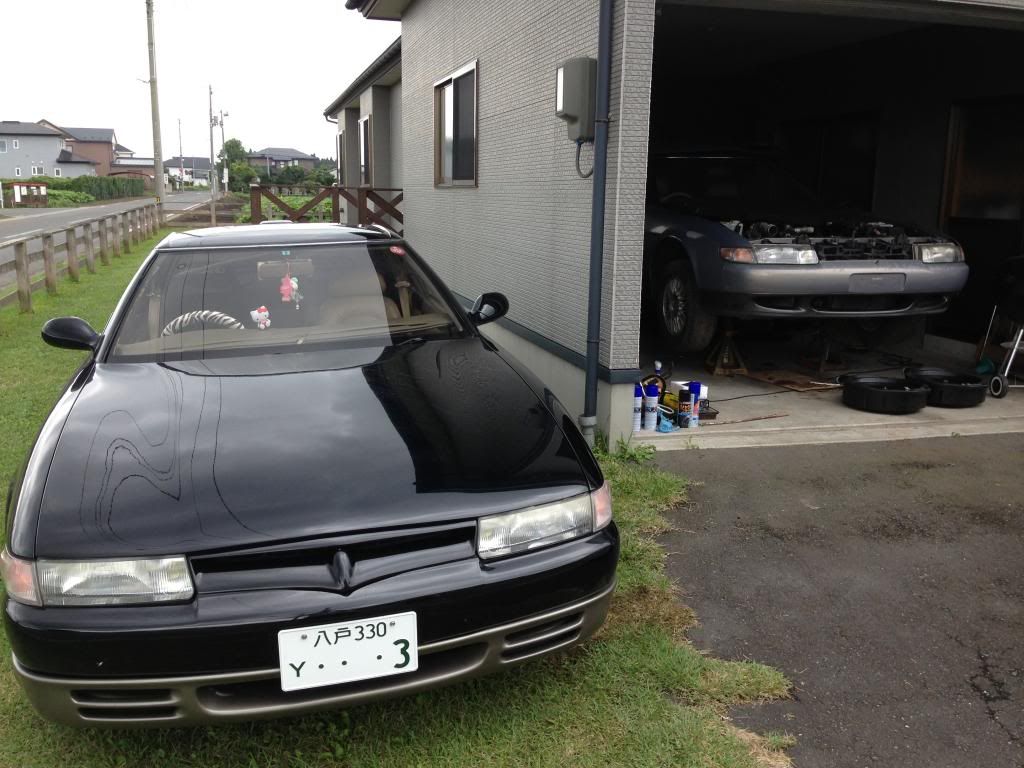

I keep forgetting to take pictures, but the fuel tank, pump assembly and filter have been replaced. There was ALOT of rust in the tank along with about half a tank of what used to be gasoline. Exhaust system, heat shields, driveshaft have been taken out in preparation for the engine getting pulled. Still waiting for my rebuild kit from Rotary Aviation, but that should arrive before next weekend.
All I have left to fix up this car is finishing up the minor under body rust, engine rebuild, fluid swaps and replacing rubber exhaust hangers. Hopefully, It'll be all done before October!
