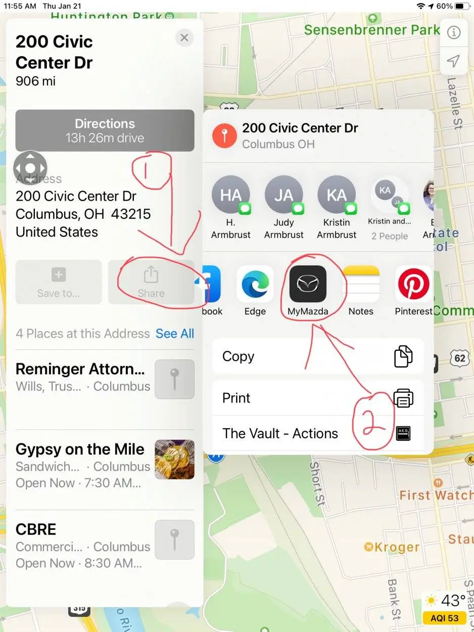

A great work-around that I have found is that you can lookup your address in the Maps app on your iPhone. Once you found the address, you can then share it to the MyMazda app. Open the MyMazda app, go to maps, and the address you shared will be listed under Favorites along the bottom. You can then send the address to your car.

  1. Open and sign-on to the “MyMazda”App. Then Go to either Apple or Google Maps and search up the address you want to send to your CX5. Select the Share button. In Google Maps the share button is a little less prominent but it’s there.
  2. From the window that opens, select the “MyMazda” App.

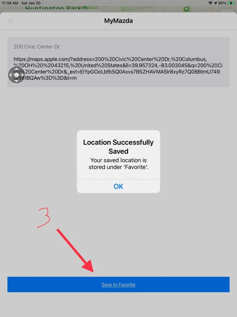

  1. Up will come the following screen. Select the blue “Save to Favorite” button at the bottom. The acknowledgment shown in white will appear.

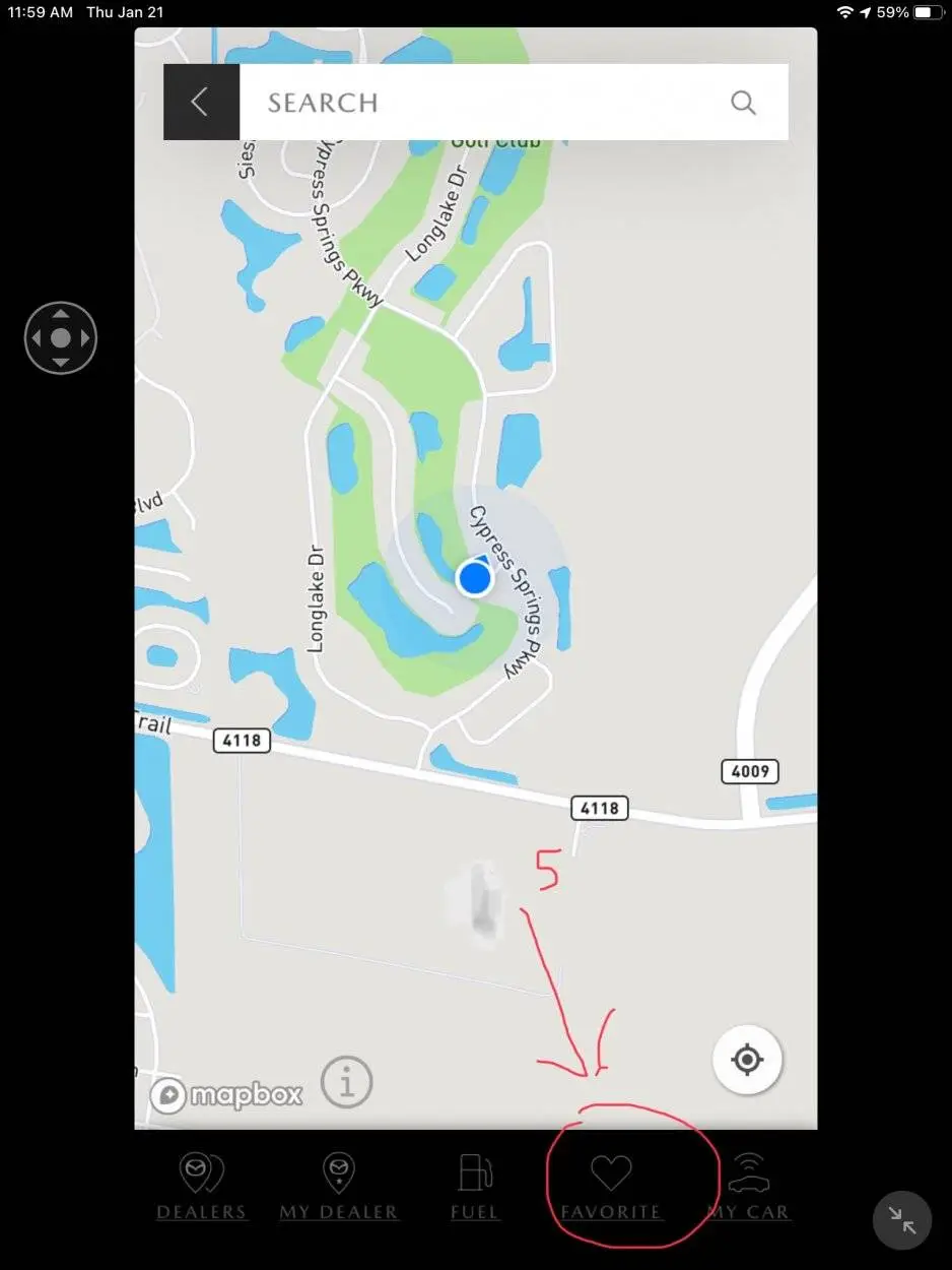

  1. Close the Maps App. And open the “MyMazda” App. Select the small map icon at the top right of the screen.

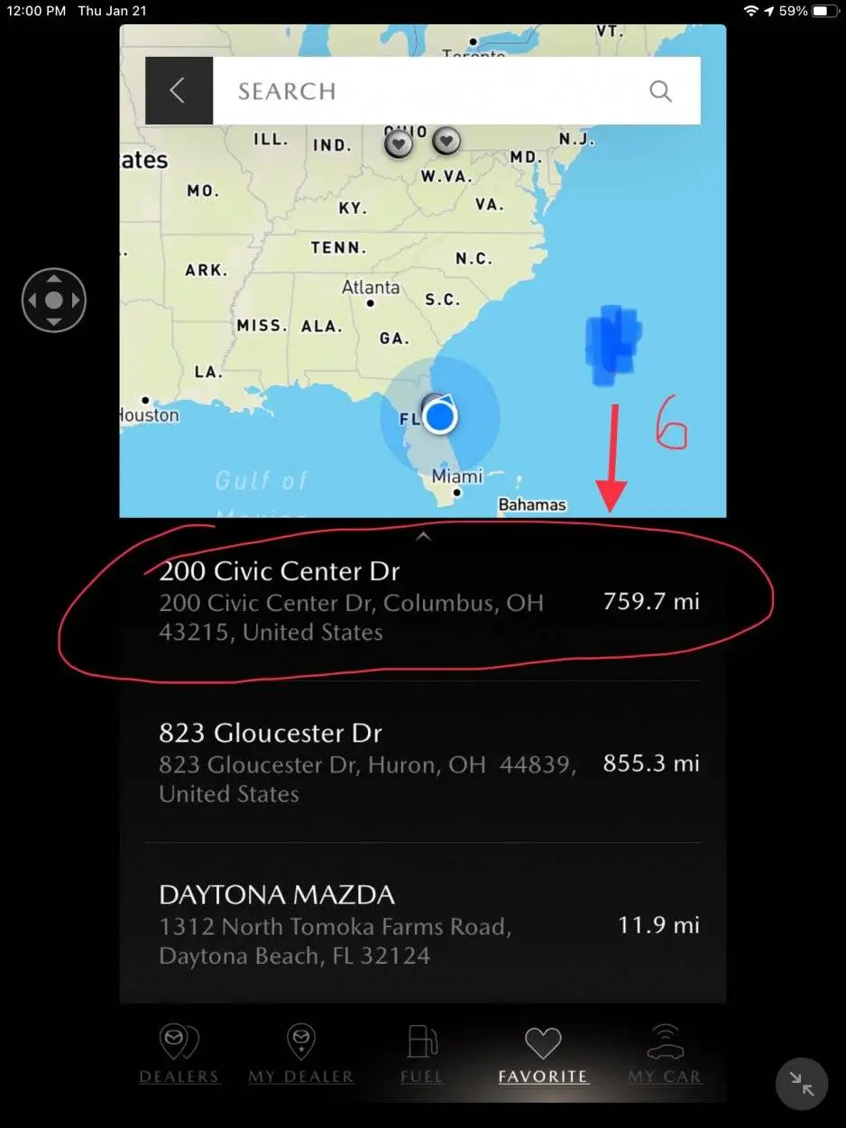

  1. Select “Favorites” at the bottom of the page and up will come a list of your favorites including the address you just added.

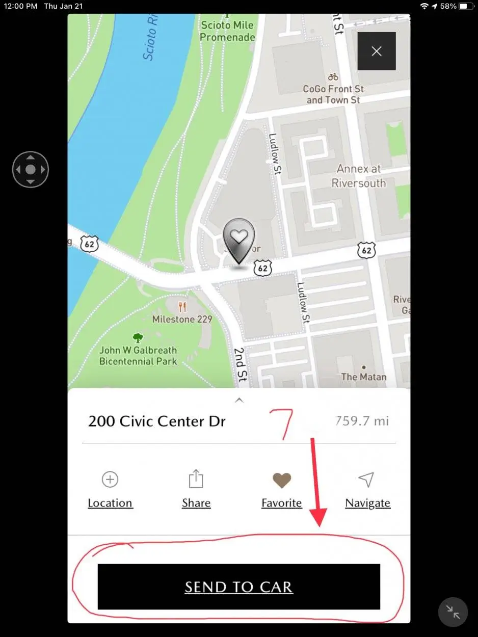

  1. Click on the address you want to send to your CX5.
  1. Up will come a map. Hit the “Send to Car” button at the bottom of the screen.
The next time you start your car, the new address will be received after 40 seconds or so. Follow the prompts on your on-board navigation screen to load the address. Also if this address is one you want to keep, you will need to save it as a favorite in your CX5 NAV system.
